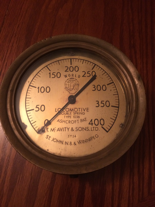

I dug out some memorabelia along with a few standard gauge Lionel trains for a very small display at a model train display outside of S'toon on the weekend. Among the chattel were the Pyle National headlight and CNR McAvity boiler gauge destined for #5080.
Thom
 Post subject: Re: CN 5080 Update
PostPosted: Fri Apr 12, 2019 12:31 am
Posts: 107
Close up of the boiler gauge. (Not the original to #5080, but one I acquired several years ago to replace the vandalized one currently in the cab.)
Thom

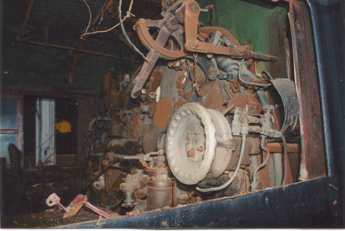

Posts: 172

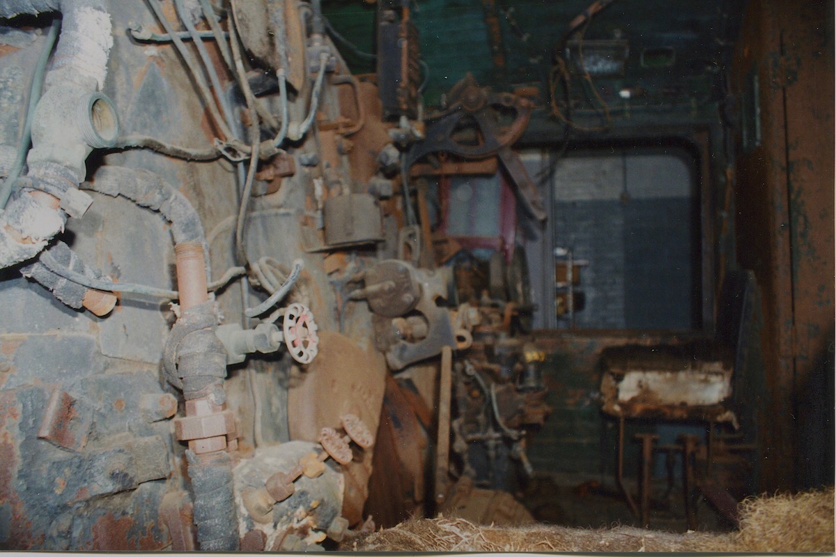

Thom,
Wonderful news about Delson providing the boiler prints. I wonder if the thermic syphons were original, or installed later in its life..?
My reference to the cab condition of 5080 was partly based on what 2816 looked like at Scranton PA, when CP acquired her in 1998. There was even a small tree growing up through the tender, among other things...and this was a National Park site.
Dennis C.

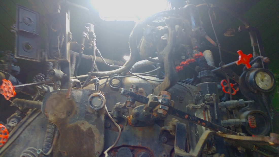

I'm curious about the Signal Foam Meter on 5080. Is there just one electrode going into the boiler? All the literature I've seen on the system shows two separate electrodes, but as far as I can tell the system used on CN engines had just one.
PostPosted: Fri Apr 12, 2019 8:28 pm
Posts: 172
joe6167 When you refer to the Foam Meter on 5080..is this what we are talking about.?
Still on the backhead....with the access door open...on the upper left..?

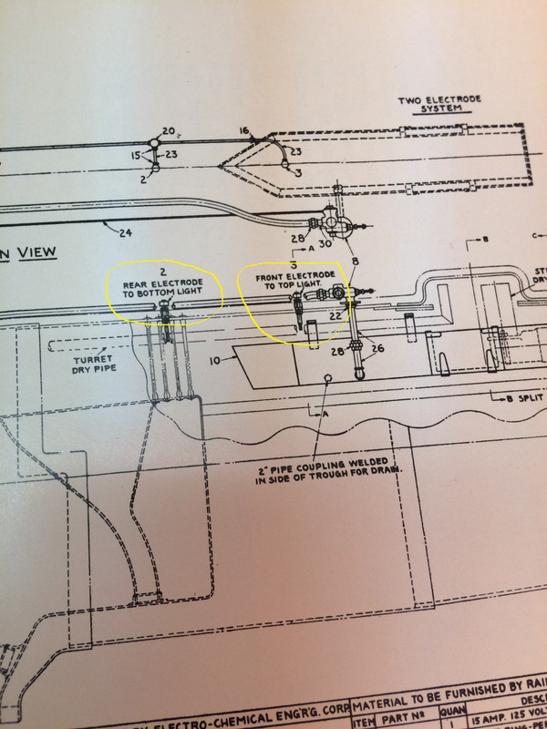

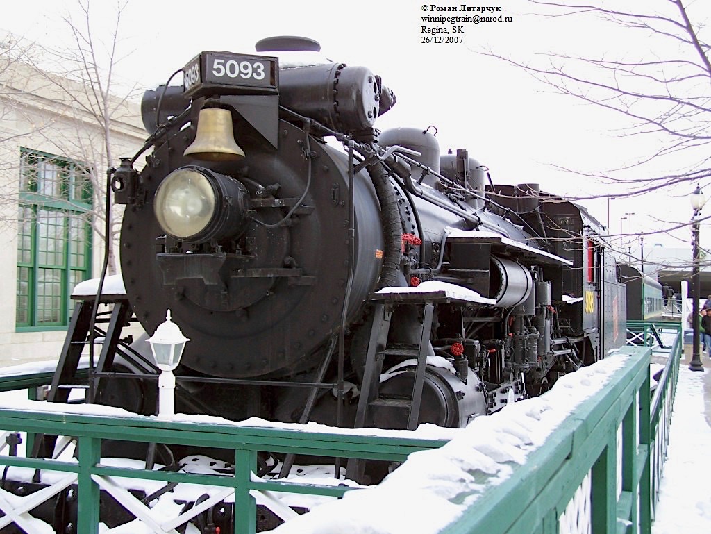

Where along the boiler are the two electrodes located?
I was able to get some photos of 5093 some years ago, and all I could see was the one electrode, just ahead of the cab, and I've wondered if the second electrode was installed above the boiler, but inside the cab.
PostPosted: Mon Apr 15, 2019 1:15 pm
Posts: 107

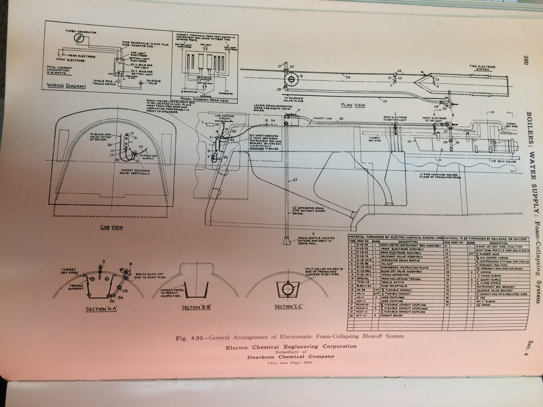

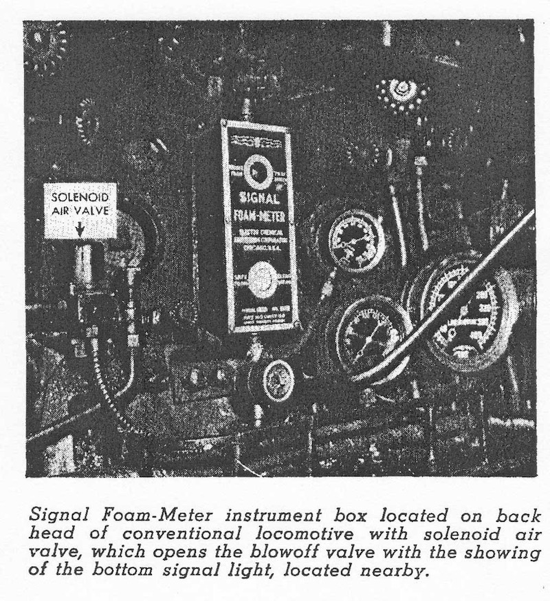

joe6167
Al Broadfoot and I will be going to Regina to take a closer look at #5093. I'll snag a few pics of the electrode ass'y for you.
For those who don't know and are curios just what the heck we're talking about, here's the advertisement and schematic from the 1941 Locomotive Cyclopedia.
Thom

Thom,
Great news about you and Al B. and 5093.
From this internet photo, I see the two engines are very similar. CN 5080 being a J-4-a, MLW 1914, and 5093 is a J-4-c. MLW 1918.
Any idea when you and Al are driving to Regina..?
Dennis.
