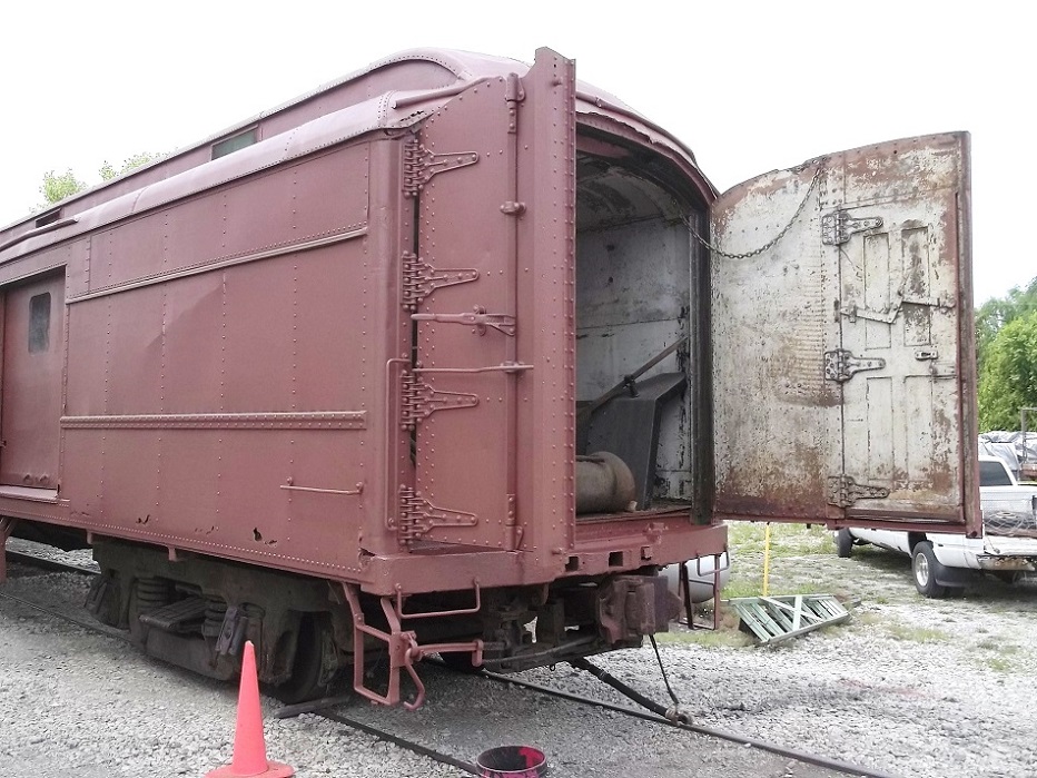

PostPosted: Sun Jun 17, 2018 9:15 pm

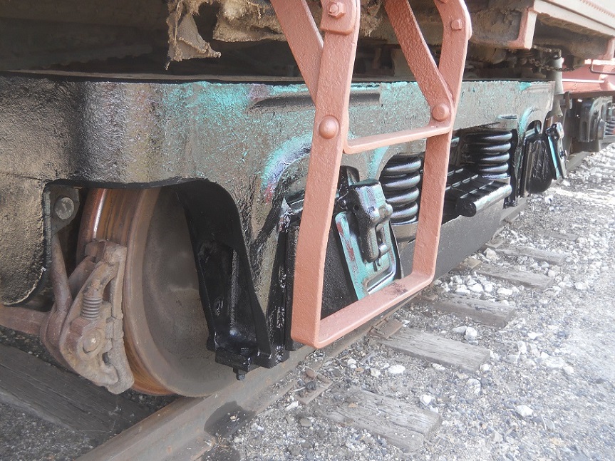

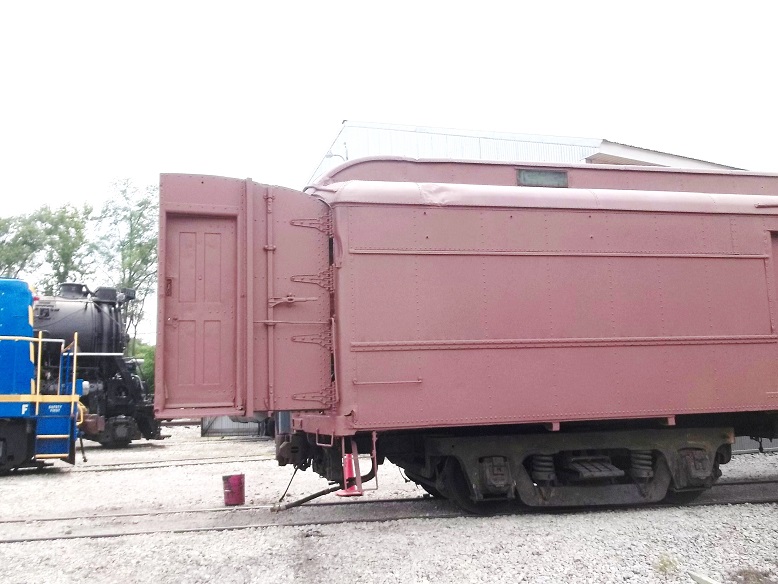

Mark continues to make progress on NKP 344. He opened the automobile doors on the one end of the car, as can be seen in the first two photos he took on 6/16. He also managed to clean and then paint the two trucks on one side of the car and the results on one of those trucks is shown in the third shot which I took earlier today (6/17). The green highlights are a reflection of the jade green paint from Penn Central box car #153177.

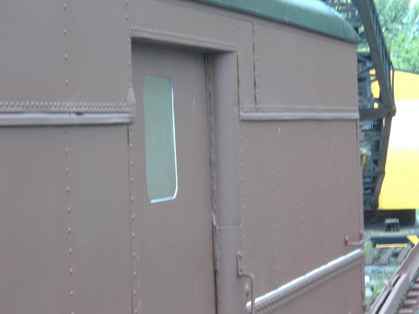

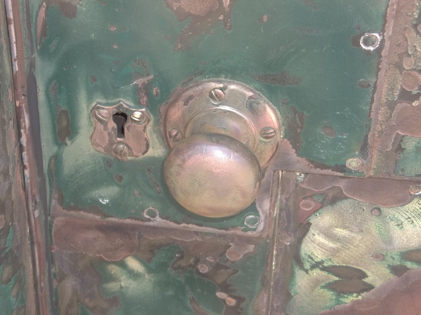

Mark cleaned off the vestibule door hardware as shown in his attached photo and believes it is brass.

PostPosted: Mon Jun 25, 2018 10:56 am
Locks and door hardware were traditionally brass; no reason to suspect it isn't.

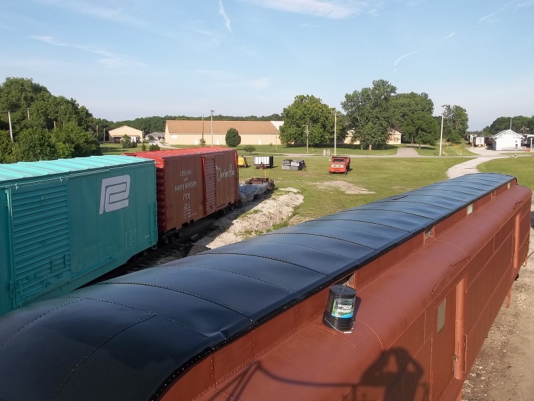

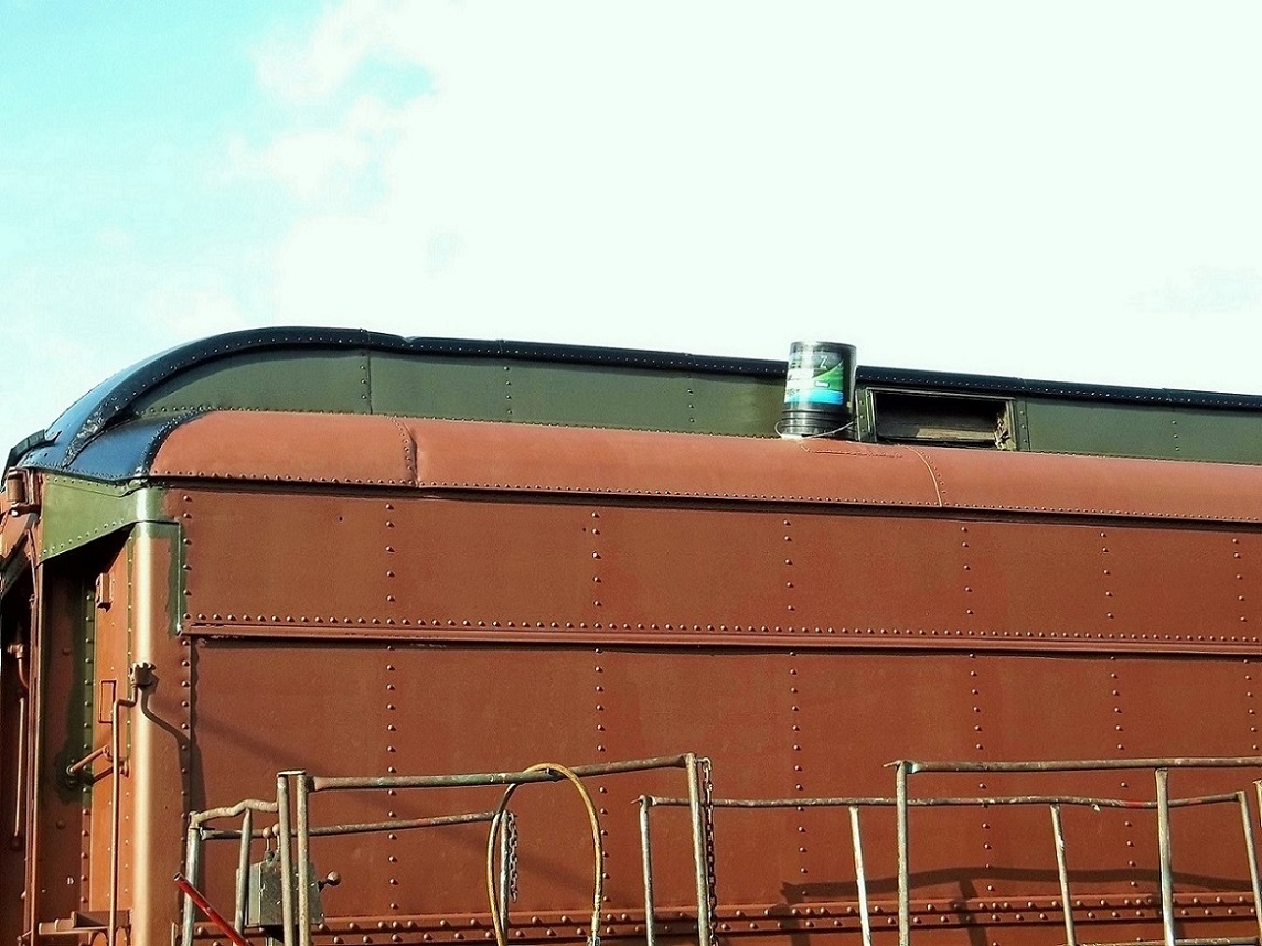

Mark has furnished these two photos as he starts on NKP 344's roof.

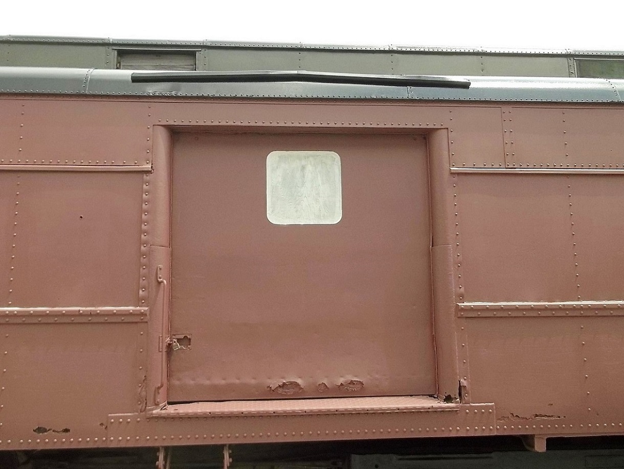

Mark spent about 4-1/2 hours of this first day of July working on number 344 in the 90 degree heat and humidity. He reported that the rivet belt around the car and the windows in each of the 4 baggage car doors received 5 and a half tubes of calk. There was a 1/4" gap on these door windows allowing water to drip in rusting out the door faces. Two of the doors have Plexiglass windows while the other two have wood replacements for the original glass. Mark primed and then painted the two wood windows. The photos below show the results of his work.
Mark also painted the one side of the car using 2.2 gallons of Sherwin-Williams Pullman Green paint. He reported that the top of the roof and sides below the celestory strip took 3 gallons of gloss black and he used 1/3 of a gallon of MAB Pullman Green paint on the celestory strip itself.
