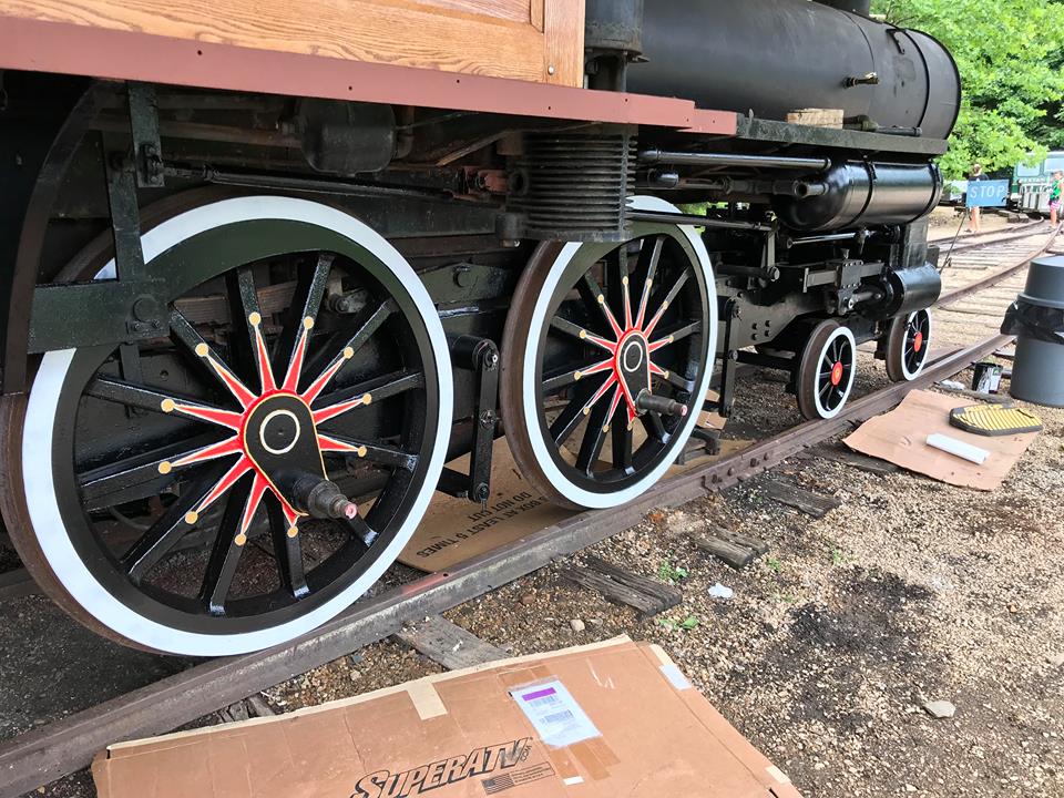

To answer a couple of questions: 1) she was built as an oil burner; 2) we are converting her to coal because it is easier & cheaper for us to use; 3) we are aware of the Crowns' poor steaming in some situations, and are rebuilding the smokebox (added 18" length), and also adding a new, Porta-style blast pipe, new design petticoat pipe, new table plate & screens. The paint scheme is somewhat based on the Eureka, and also the early "Baldwin Paint Scheme #1", which will include wheels patterned after (but not identical to) Baldwin's design for their early drive wheels. The photo of the wheels is by Cody Cagle, who is in charge of the rebuilding of the Crown. The design & painting is by volunteer Randy Holland, who has been donating much of his work. Randy & Cody did most of the painting of the wheels. The cab was built & installed by Jerry Turbyfill, Vice President of the ET&WNC Historical Society.
36811974_10210259064508117_9126960475009974272_n.jpg [ 164.83 KiB | Viewed 25567 times ]
