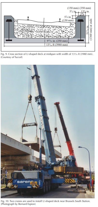

The second paragraph of the article refers to "U decks" - I presume that is British terminology for a type of bridge superstructure design in which the main structural beams are alongside the tracks instead of directly underneath the tracks. The cross section of the bridge looks somewhat like a 'U', hence the name. The design provides more clearance underneath the bridge because the superstructure under the track isn't as thick (since the main beams are alongside the track, not under it.)
I think the design is patented and that's why it is not that commonly used in the US (most publicly funded infrastructure programs cannot pay for patented designs and proprietary materials.)
The cross-section of a U-deck bridge and a picture of it being lifted into place - note how the bridge is less than 10 inches thick below the track/ballast:
These illustrations are part of the article Innovative Composite Precast Prestressed Precambered U-shaped Concrete Deck for Belgium's High Speed Railway Trains [PDF] that was published in the November-December 2004 issue of the Precast/Prestressed Concrete Institute's PCI Journal.

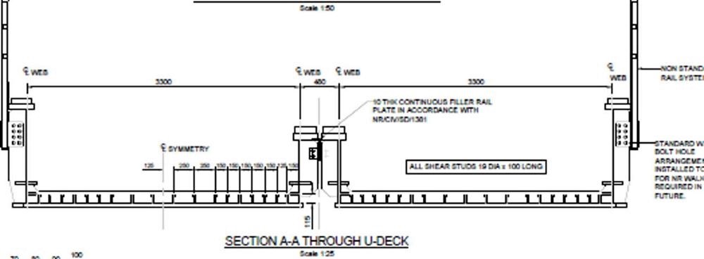

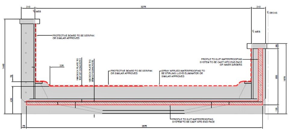

I did actually find some images online today - after a bit of digging about - which enable the meaurements (in mm) for the A60 bridge to be read, more or less.
This is a cross section of the single track u-deck...
The pair of decks together....
Thickness of the bridge deck is just over 17" (420 mm), which is more than the example mentioned in the previous post.
The uprights of the U shape seem remarkably thin though - 210 mm is about 8.25"...!
