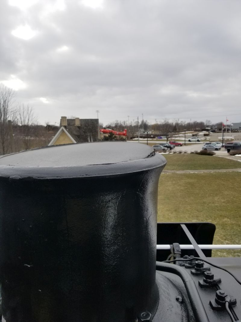

Posts: 243
Sorry, but a proper stack cover HAS NOT been fitted on that engine. It was a very poorly done, politically motivated restoration. There are still holes that were not even patched, and water is still getting inside the smokebox. The attached image is of the "stack cover" which can clearly be seen to be lifted off. It was not secured in place properly. The entire job was done by an ornamental iron company with NO railway restoration experience. The only reason they actually got the job is because they knew someone in the Town. The councillor for Ward 1 said he would get something done to the engine before his term was up. So they did this crappy rush paint job, so he could say something got done, in case he didn't get back in. He got back in, but now they don't know what the future plan is. They want to put the jacketing back on but now say that and a roof may not be in the overall plan/budget. Unfortunately, when you don't consult those that actually know about this engine, you end up with a poor job. Looks great from the road, but as Rob said, they did nothing to clean up the tender, and they definitely did not do a complete paint removal.
Ken
Ken
How many restorations will it take to figure out this mystery of "why is water getting into the smokebox"?
