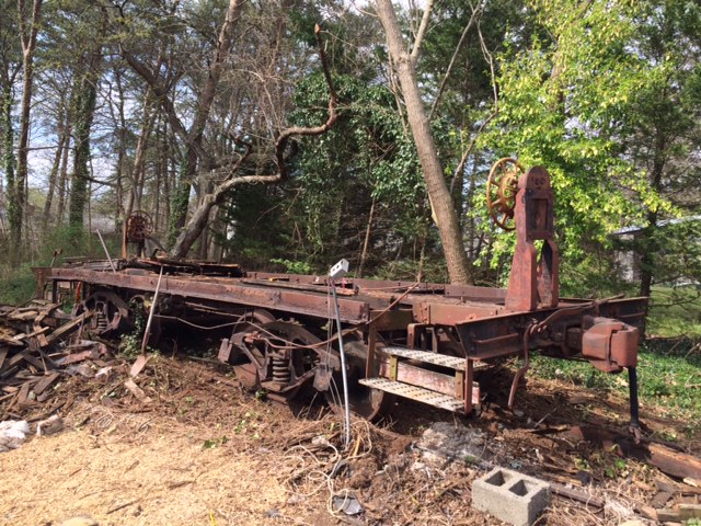

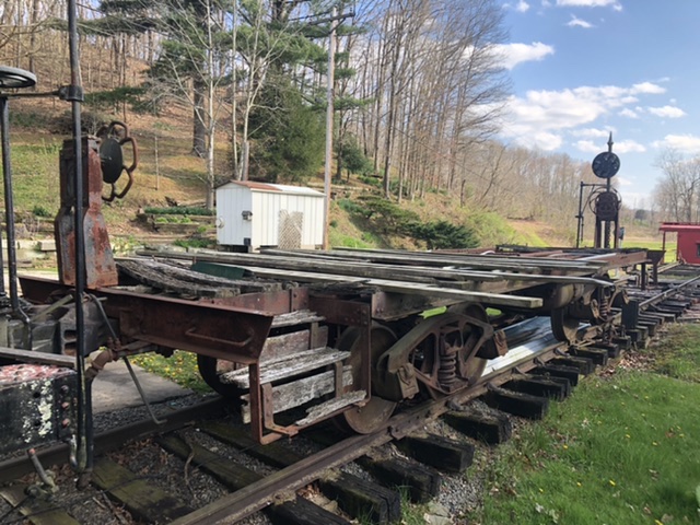

The group in Worthington, Ohio used to have one, but vandals burned it. I have heard that the hardware, trucks, frame, etc. from Worthington were saved and are being used to construct a new copy using original PRR drawings at a location in Ohio. I can't confirm the status of that project.
The status is... It's still a frame.
I hope to change that soon.

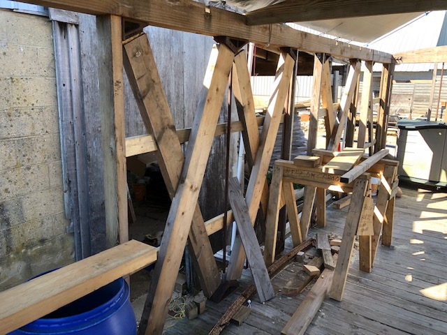

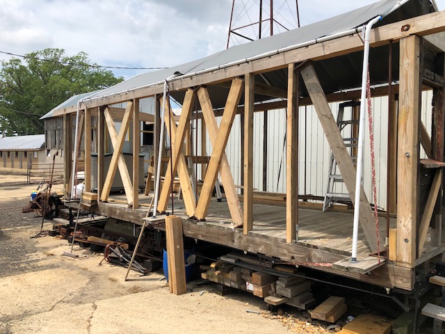

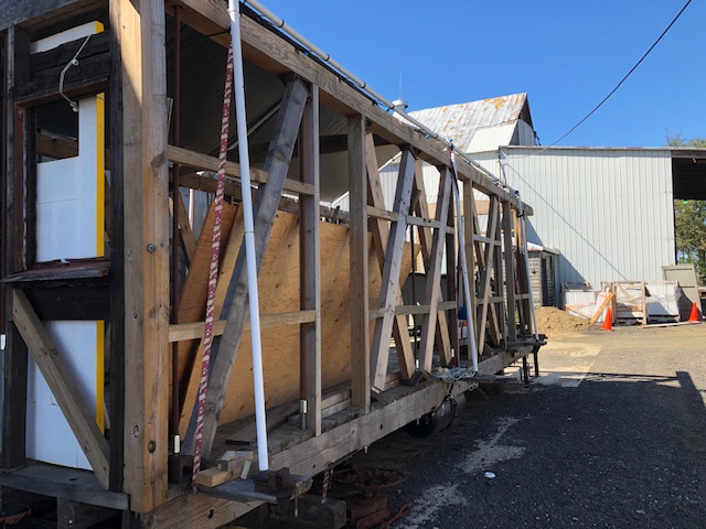

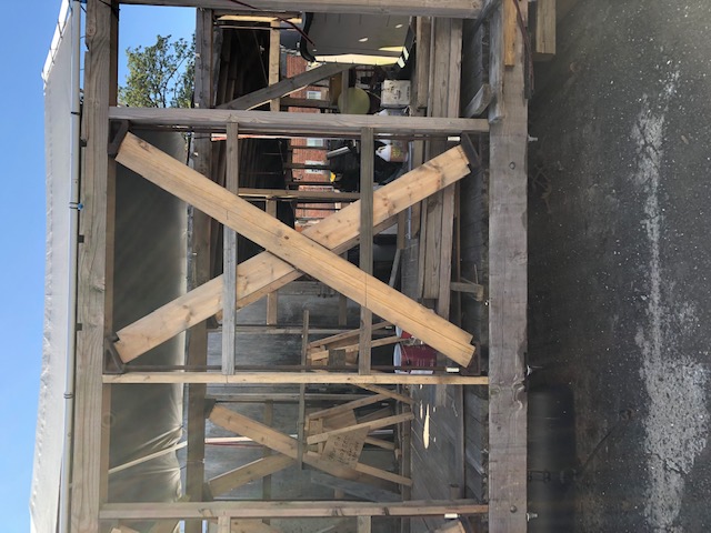

Just another quick update on our progress on the N6b. Ed and I hit another milestone this past weekend with the completion of the X bracing, or diagonals, on one side wall. Next weekend we will be working on the other side wall. We now have some much needed help from Chris Lynch, Greg Lacko, and David Donley who have taken on the truck rehab work. Timing is good as we may have to move the caboose about 100 feet to allow room for a drill rig to come in and drill a new well for the farm where we are located. We may put the caboose on its trucks for the move, have to see. Stay tuned.

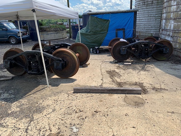

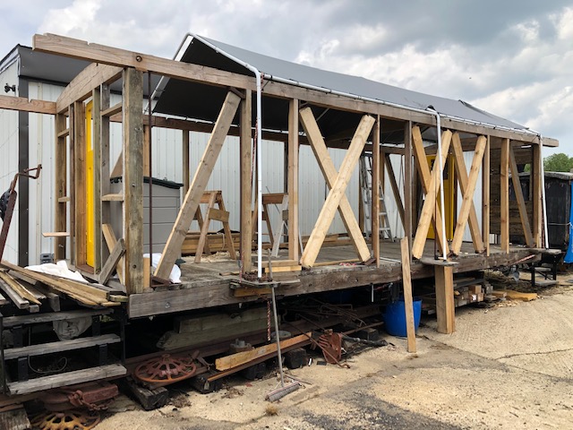

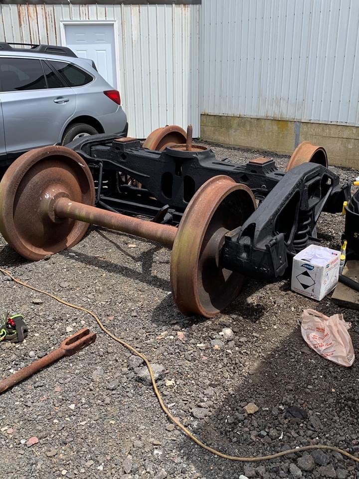

A milestone has been hit and we thought should be celebrated. As of this past weekend, all the heavy timber work has been completed on the body of the N6b cabin car. As the photos show, all the diagonals are in place, filler wood pieces to nail the siding to are in place, the long rods that hold it all together are tight. Overhaul of the trucks has also been completed. We now move to the roof and siding part of the project.
You might say we are on the homestretch here!
We have attached some photos of where we are at the moment and the completed body frame work along with the overhauled trucks.
Have also included one "before shot." Gosh, what were we thinking??
Enjoy!

Really nice work. And those wacky PRR cabin car trucks with the pogo stick spring!!
 Post subject: Re: PRR N6b on ebay
PostPosted: Mon Sep 21, 2020 12:52 pm
Posts: 492
Location: Strasburg, PA
Yeah, right? What a ride, Howard.

Good to see this how this is coming along - was only thinking about it the other day. Not seen the arrangment of the diagonal bracing and the triangular metal pieces before on anything railway wise.
Michael
PostPosted: Mon Sep 21, 2020 4:54 pm
Posts: 728
Location: Wall, NJ
> Not seen the arrangement of the diagonal bracing and the triangular metal pieces before on anything railway wise.
It is an interesting approach and suspect it made building 1,200 of these cars much easier/cheaper using less skilled workers. Very few angled cuts as a result. Whole thing held together with mortis and tenon joints and 9' long irons rods.
Those are cast iron "shoes" with round lugs on the bottom that fit into round mortises that can be made with an auger, no? Those were quite common on larger structures such as water towers, and I'm sure I've seen them on sectional drawings of wood freight cars. As I recall, they show quite prominently on D&RGW narrow gauge stock cars.
