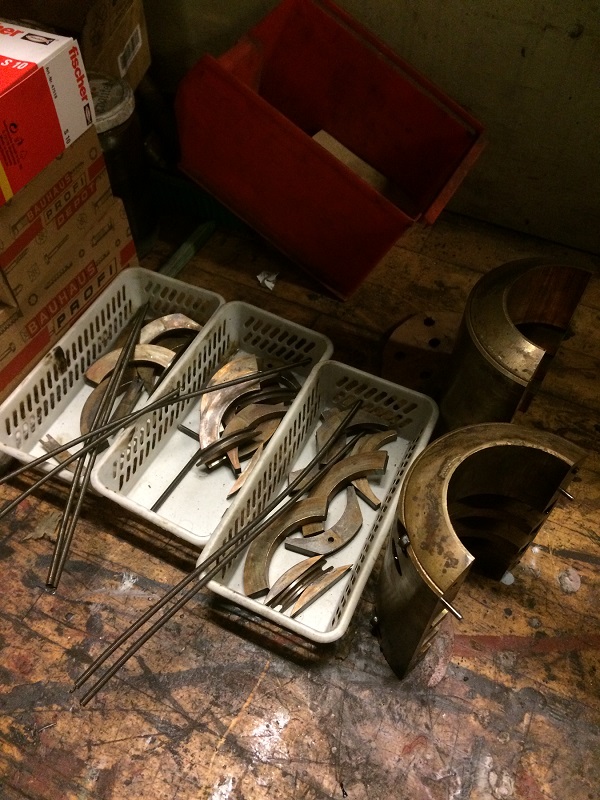

The Hi-Tech packing is similar in "design" to Paxton-Mitchell but has a groove in the OD of the packing that the garter spring fits into, adding nothing to the OD of the packing itself. We made a ring that fit inside the original packing gland to take up the space formerly occupied by the P-M flat P-M springs.
That said, we did pretty much the same thing when replacing "KING" style packing.
J.David

Posts: 343
I would also agree with J. David. We have modified one of our locomotives with this style packing in the past, and have been very happy with it. Currently we have begun the process to modify another one of our locomotives as we have no interest in machining and maintaining conical lead packing rings.
If you look through the drawings (and can deal with it being in Danish & metric), you can see there are two variants of the packing rings. We place one of each kind in a matched pair, and then use three pairs in the housing to create the piston rod packing.
I have seen a really good photo of us installing it, but of course I cannot find this photo now that I need it.
File comment: Packing ring - Thirds variant

File comment: Called a pacific packing here in Denmark, it exactly matches the style J. David discussed
