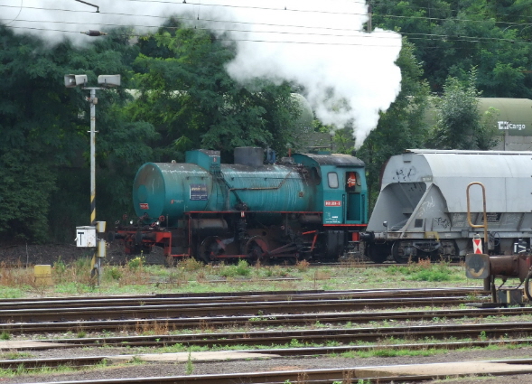

This one took me by surprise at Usti nad Labem in the Czech Republic a few years back. They used a pair of them at a cereals plant and were only replaced by diesels in late 2014 (I think).
A couple of places in central Europe still use fireless locos.

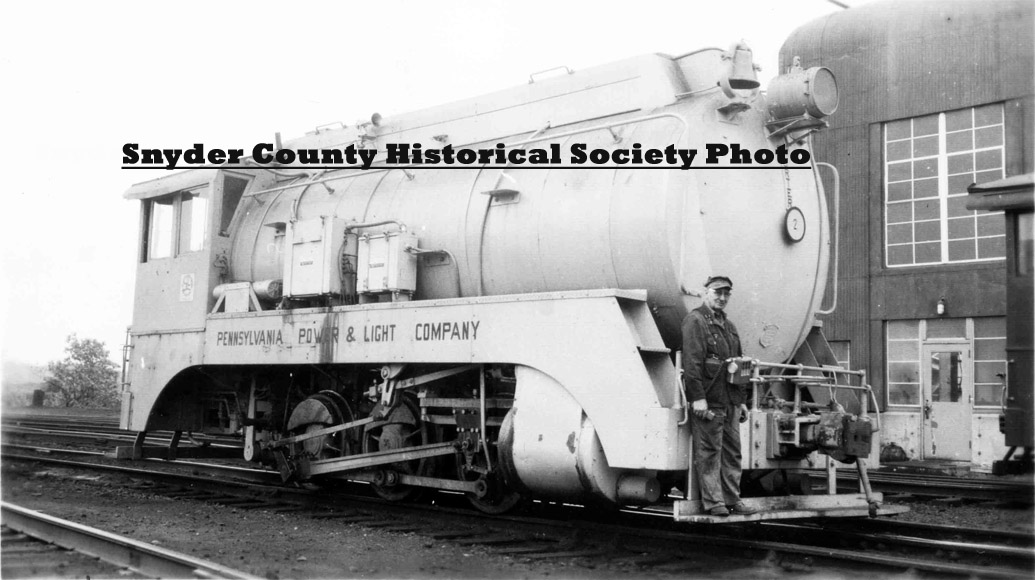

Mention in this thread of the two fireless 0-6-0's at the Shamokin Dam power plant brings to mind something I always found amusing and a bit disconcerting. One of the two engines was fitted with remote control equipment, and it always surprised me to see it shuttling about the coal yard with no one in the cab. It could start, stop and change direction with no one aboard.
The other locomotive was not so equipped, so an engineer and brakeman were both necessary. In periods of high electrical demand during cold weather, both engines would be working. One would place and pull carloads of coal from the thawing shed, while the second would run the cuts of cars through the rotary dumper.
The power plant, one of the oldest still around, is currently being converted to gas turbine generation. Ironically, due to restrictive curvature and a low-rated bridge, new turbines and other dimensional loads cannot be delivered directly to the plant by rail. Instead, they are brought by the local short line to a location at Winfield, four or five miles away on the other side of a substantial ridge, where they are transferred to multi-wheeled road vehicles for final delivery.

 Post subject: Re: Use of Fireless Locomotives in Museum Service
PostPosted: Wed Feb 08, 2017 12:37 pm
Posts: 12173
Here's a photo of this beast from the Snyder County Historical Society archives, which I'm guessing was a PP&L PR photo. The remote gear sits in the boxes in the running board and the control unit is hanging on then guy's front. That's #2, Porter 8190, 1949. Seen off to the right is the cab of loco "C", a smaller 0-6-0F, Porter 7993 of 1946, which came to this plant after the Pine Grove PP&L plant was closed.
I recall that I never actually witnessed RC use of the steamers that I know of--its use was reported in a 1975 article in the Sunbury Daily Item, as I recall, but the word I had was that the RC units were unreliable. My gut suspicion is that the railroaders trusted their gut and butt on the seat more than the RC when dealing with any distance or larger number of cars. Seemingly identical gear had been fitted to the Alco procured from the West Pittston & Exeter after the June 1972 flood took out that line, and that RC was used at least around the rotary dumper (a slow, tedious, one-car-at-a-time job). RC gear (I believe the next generation) went into the ex-SP SW900 that replaced both the Alco and the steamers in early 1989.
