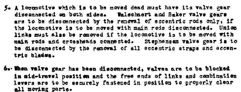

Jason Midyette wrote:
I have always wondered if the Santa Fe removed them so they did not have to deal with trying to lubricate them while towing a dead locomotive or if it was a way to insure that no one would try to operate the donated locomotive.
From the ATSF Standard Practice:
 Post subject: Re: Cost of new eccentric rods for a steam locomotive
PostPosted: Sat Jan 14, 2017 3:15 am
Posts: 483
Location: Oroville, CA
Interesting that the Santa Fe standard practice specifies the valves be blocked in mid position, just as I noted was done on SP 1727.
Note the straps and blades are to be removed, I don't believe the links are touched, as once the straps and blades are removed, and the valves blocked in neutral, they are no longer moving around nor in the way of anything else. They could even be raised or lowered with the Johnson bar and not effect anything; but they are to be blocked so as to not move according to the second paragraph.
Steamcerely,
David Dewey
