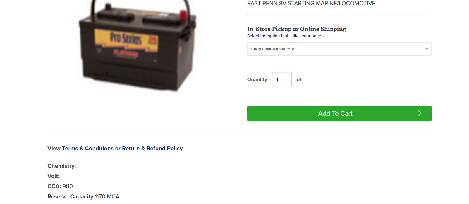

I believe I have found the replacement for the original 8 volt batteries. I have attached a picture with the ratings and would like comments.

You will be hard pressed to find a better battery than West Penn. They have been in the industrial battery market for a long time. We used to sell Exide and Interstate and Penn beats them hands down for quality and life.

That battery should be fine. Keep in mind that picture is NOTHING like the battery you will get. (well they are both square batteries)

You can get those 8 volt batteries for a reasonable price at any Cat dealership .
