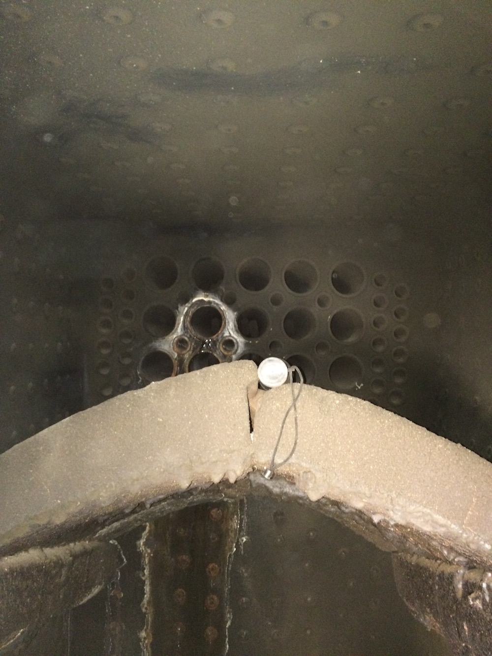

10stewi wrote:
-Copper firebox, steel tubes and flues
-most definitely a leaking flue, leak comes from edges of the flue and sheet
With a copper tube sheet, how are the tubes attached? Beaded?
 Post subject: Re: Boiler Watch Leaking Flue
PostPosted: Wed Apr 20, 2016 5:07 am
Joined: Wed Feb 05, 2014 6:30 am
Posts: 56
With a copper firebox the smoke tubes are expanded into the firebox tubeplate and then beaded over. Superheater flues are screwed into the tubeplate.
Going back to the original question. Were it me (and I've been involved with loco-type boilers of various sizes for getting on for 50 yrs) I'd have simply closed the dampers and firehole doors, turned off the blower and filled up the boiler. The fire would die and the boiler cool naturally - no panic (Kevin please note).
Had it been just a smoke tube, once cool, I would have plugged it with a pair of tapered plugs and drawbar but as it's a superheater flue I wouldn't mess with it. Some years ago a superheater flue collapsed on a preserved loco in the U.K. - fortunately no-one was seriously injured but a lot of boiling water and fire was blown back onto the footplate.
Unfortunately if one flue is 'thin' at the end the rest won't be far behind so the only real solution is to remove and inspect them. If the 'body' of the flue is sound it is possible to weld on new "bottle-ends" but that depends on your boiler inspector and Danish regulations. Depending on the age/condition of the smoketubes it is probably worth replacing them as well.

Update.
I don't think our superheater flues are screwed into the tubeplate.
I was not there, but the flues were re-rolled and beaded in the mid-week. The engine was in service Friday-Saturday-Sunday and I was fireman on Friday for the afternoon. I did not see any evidence of leaks in flues or tubes that day, but I did notice a leaking staybolt on the outside lower engineer's side. The engine steamed very well and held pressure like a thermos even when the fire was nearly gone at the end of the day.

Sorry I never got around to posting the photo of what the tube looked like, its been a busy week. This is what we were looking at when we came back to the locomotive on Tuesday. The problem was sealed up by the end of the day, and we did not have issues with it after three days of mainline running. So, by the way things currently are, the problem has been solved and we are happy to have worked the problem out!
also, to answer another poster's question, the tubes are most definitely not screwed in. I have never heard of that practice and can say that all Danish locomotives with copper fireboxes, both welded and riveted, do not have screwed in flues
