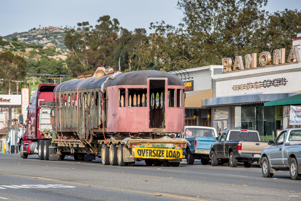

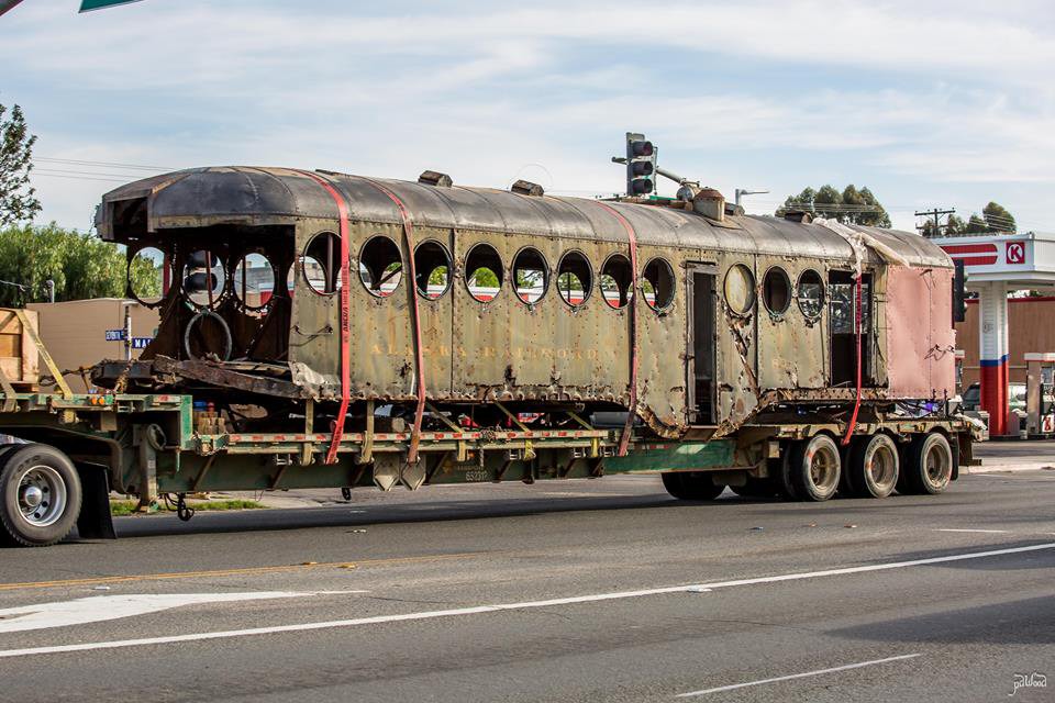

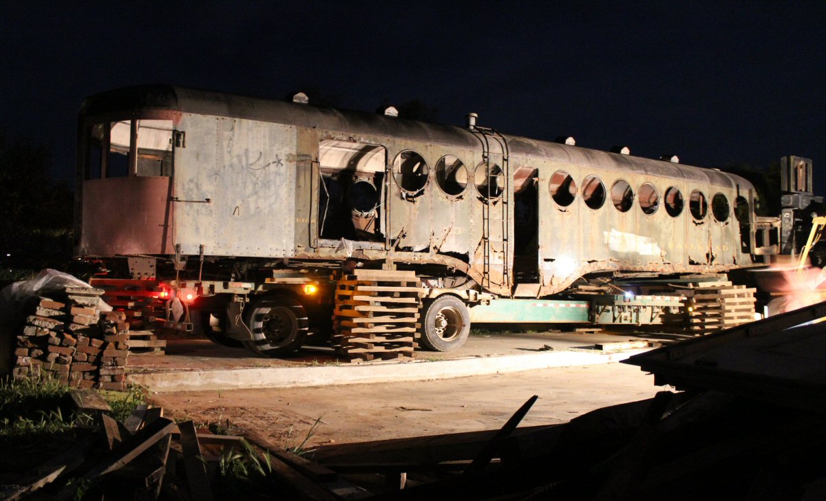

Here are a few pictures from the arrival and unloading in Ramona.

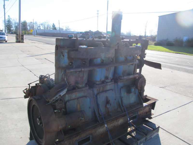

my guess is that the Climax engine was similar to the one pictured here.
That's odd, I haven't been getting email notifications for all of the replies here.
Anyways, how many horsepower is that engine? It's only a 3 cylinder, and it seems too small.

Are you sure it's only 3 cylinders? Those "cylinders" look like 2-cylinder assemblies to me.

http://www.wehs.net/connection-2-climax.html

Its a six cylinder with the cylinders cast in pairs. At one time Climax Engineering offered a whole range of engines for industrial use. Including a massive six cylinder (6"x7") [R6U?]rated at 142 hp. @ 1,200 rpm. similar to what was just pictured.
Far more plausible than a Climax steam engine retro fit.
Oh, you're right, I didn't notice that. Now, those cylinders are pretty small (in my mind) since the McKeen Cylinders were 10" x 12" stroke-bore. The McKeen Engine created 200HP at 350RPM. That was not considered enough by most railroads and thus they usually re-powered them with a larger engine supplied by EMC. Would a larger Climax would have been used in place of the McKeen Engine or did these have higher foot pounds for the same horsepower?
