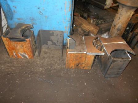

I couple of years ago, shortly after I returned to the C&TS as Master Mechanic, we began experiments on converting the main driver journal lubrication on the locomotives from the original hard grease to oil. I asked for information and advice here and of others who had done this and got a lot of good responses. We have now converted two locomotives, 489 and 488, to oil cellars and, between the two, have about three operating seasons of experience with them. This is a follow up to update anyone interested as to what we have learned.
The project has not been without incident and we went through a learning curve with the first engine, 489, that required going back and making some changes over the course of the first operating season. We applied what we learned to the 488 and it has run without any mechanical issues so far. All things considered, we feel that this is a success and plan to continue to convert all of our K-36 class power as they cycle through the shop for driver work. We are using the Armstrong oiler lubricators and are very satisfied with them.

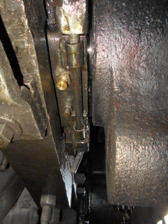

Aside from the limitations of the available grease (more about that later) maintaining the oil cellars is considerably less costly in terms of man hours. Since our locomotives are outside frame, the only way to remove the cellar is to drop the binder. It takes two people about an hour to drop a binder and replace a grease cellar. This does not include the time required to actually repack the cellar screen. In comparison, one person can top off all eight oil cellars in about 15 minutes with our current filling method and I plan to improve that in the future.
An engine will normally make a 130 mile round trip over the railroad in a two day period. All maintenance of the cellars is performed in Chama. Each cellar consumes a little over a pint of oil during the 130 mile round trip. Some of that is lost to waste due to our filling procedure and I feel that that can be reduced with improvement there. We are using Journal Guard oil. Crown brass temperatures normally run between 15 and 30 degrees above ambient. They run cooler when the engine is working than when drifting. I cannot explain that.
What we have learned (sometimes the hard way)
1. The journal surface must be consistent. We have set a standard of no more than .020 inch taper over the width of a 10 inch journal. The surface must be straight. In other words, no hour glass or barrel shape of the journal surface can be tolerated. This has required us to machine practically all journals that we have converted so far.
2. We machine the crown brass to a smooth surface with no oil groves or pockets. We initially tried machining a small oil return grove in each edge of the brass but decided this was not worth the effort and the oil that does escape out the side helps lubricate the hub liners. We have tried using clearances from .015 to .030 on the diameter. Both work acceptably and we have standardized on .030 for our 9" journals. We found that a little loose is FAR better than a little too tight. Part of that learning curve.
3. The D&RGW had a practice of lubricating the hubs with soft grease, a practice which we continued. The grease works its way into the edges of the lubricator pads and slowly fouls the pad causing loss of lubrication. We are converting the hubs back to oil lubrication as they were originally designed by Baldwin and that seems to eliminate that problem.
4. One of the few benefits of the outside frame design in this regard is that the cellar boxes are completely surrounded on all sides which helps keep dirt from getting into the box and pads. A normal inside frame locomotive would leave the inside of the box exposed at the axle. Kelly addressed their fix for this in one of his posts.
5. We have issued all of our engineers IR temp guns and have them check journal temperatures at all regular stops and report immediately if one is above 150 degrees. Once the operating temperature begins to rise, letting it go a while to see if it will settle down is not an option.

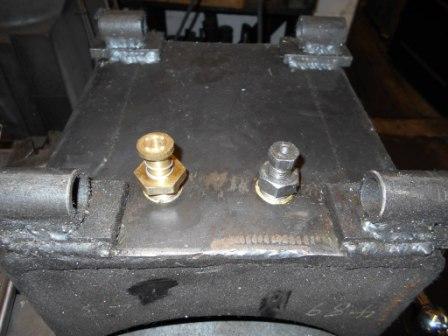

We first tried to convert the original grease cellar boxes by plugging the tell-tale holes and adding the filling ports. We soon decided that this would not work well due to the uneven surface of the cast boxes. We made all new ones out of ¼” steel plate, precut and folded by a fabricating shop.

File comment: This is the only access to the cellar boxes. All servicing must be done through the narrow opening between the hub and binder.

File comment: We built spring loaded check valves. These allow both draining water out of the cellar and filling from a pressurized oil tank by inserting a probe into the opening. The other fitting has a stand pipe that sticks up into the box about 1 1/2". This currently serves as a fill indicator. I plan to mount reservoirs on the frame and run hoses to these fittings for filling.

Now, a little more about that grease. Years ago when the original hard greases became unavailable we were unable, for a time, to find any suitable substitutes. Based on that experience, the grease was getting the blame here for all lubrication failures on the driver journals. In parallel with developing the oil cellars I have also been improving the maintenance of the grease cellars still in service and have found that WHEN EVERYTHING ELSE IS RIGHT there are at least two hard greases that we have tried that work acceptably in our service, although still not as well as the old greases. Your mileage may vary.
In our current view we have decided that the cooler running temperatures we get with the oil lubrication along with much less labor intensive maintenance make the oil cellars a better option for us. In addition, the engines roll much more freely on oil than with grease. One or our guys calls it "the scary roll".
We don't have enough time on them yet to compare the journal and crown brass wear. That will take a few more years of service.
