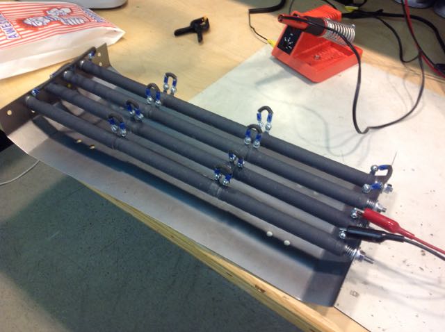

Here is a picture of the test rig, which I plan to dismantle and repackage into the smaller OE form factor. Each resistor is 1 ohm, 100 watt and 6.5" long.
File comment: resistor unit at Techshop
Jeff, I don't know your basis for specifying 300 degrees F surface temp, but that's a tall order. Assuming 80F ambient and 220F temperature increase, and looking at the Ohmite data sheet linked on page 2, that requires derating the resistors to 18-20% of rating. Which requires a 1500 watt resistor. And then another 750w, 6 ohm resistor for the "dim" mode. Resistors of that size would be physically difficult to fit in the present locations, even using the undesired top position.
Up until now, my plan was to use five 1-ohm 100W resistors, for $35, which works out to 53% of rating, 400F rise (480F surface temp). Plus three 2-ohm 100W resistors for the "dim" circuit, also running at 53% of rating when used. This package would fit in a single OE location and the top positions would not need to be used.
I could, instead, use ten 100W resistors at 27% of rating for about a 280F rise (360F surface temp). Added to the six 1 ohm resistors to make up the "dim" side, that would mean mounting 16 resistors, but it would fit if we really stacked them.
The last option would be use resistors designed for heatsinks and use "PC CPU cooling" technologies like heat pipes or water cooling (I would be reluctant to add them to the nearby #1 engine's cooling loop since it may not be running.) But at this point, we've exceeded the difficulty level of a buck converter by a stretch. Like I say, 300F is a tall order!

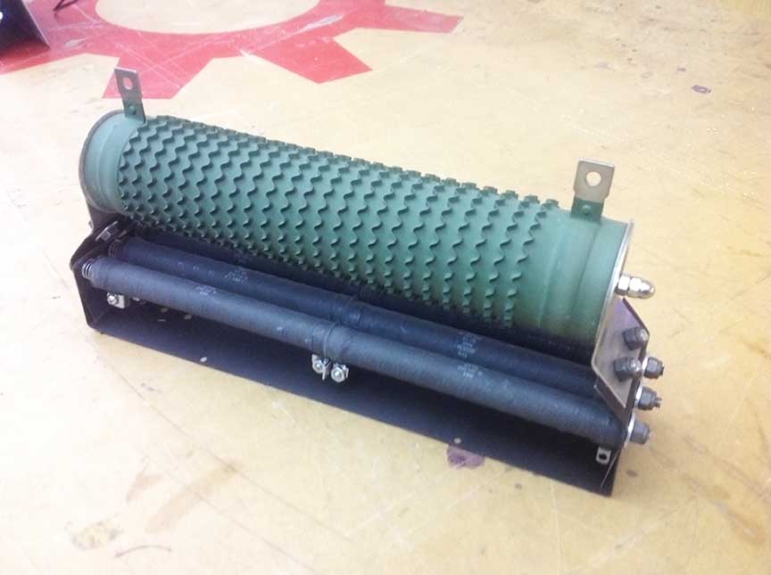

And that's pretty much what I wound up doing: upsizing the resistors even more, aiming for 300F operation. . I was able to obtain the enormous 1000W resistor at a workable price. It is precisely the resistance needed for "bright". Six of the smaller resistors mentioned earlier are still involved, they add to it for "dim". TechShop's IR thermometer failed (and their power supply can't kick 250W anyway) but bench testing at lower power levels gave temperatures as expected.
As with all things electrical, it's 90% physical, and the mounting frame went through four iterations. Here's the last, without the adapter plate that lines it up to the holes on the bracket.

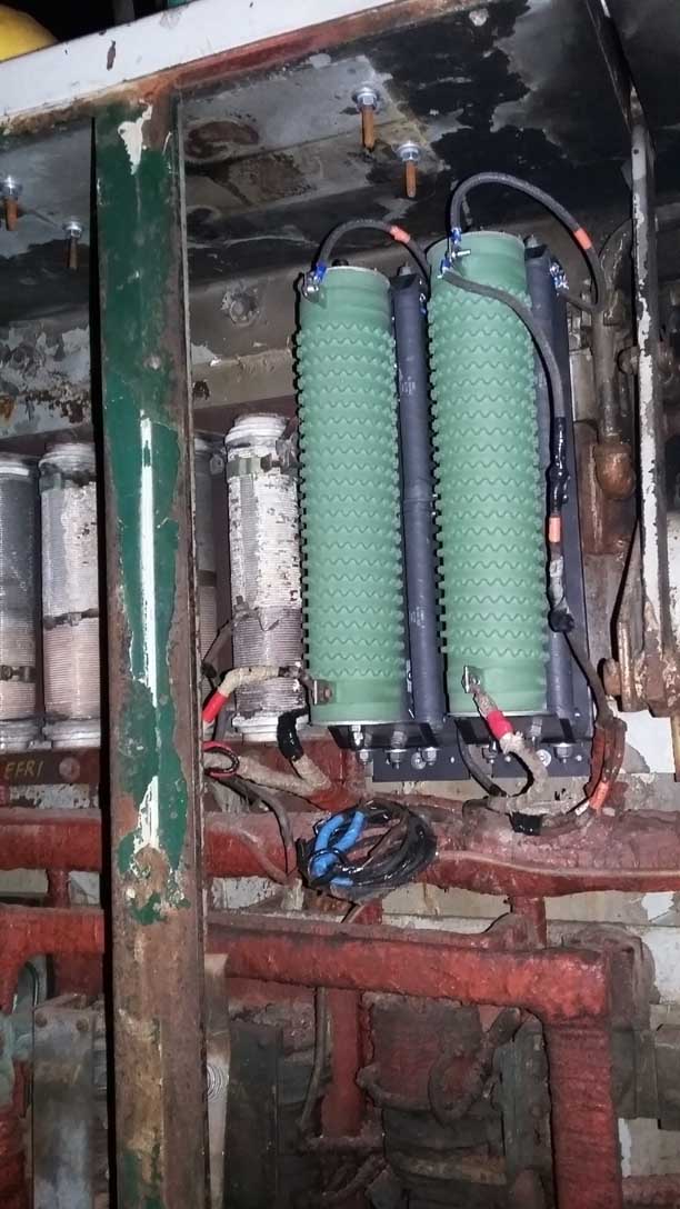

Here are the resistors on the unit. The mounting locations are the same as the original headlight resistors; as-built there was one resistor per headlight. As-we-received-it, those locations held two resistors connected in series to regulate one headlight; and the now-disused "ceiling" site held two more for the other headlight.
The top connection is not made on the left resistor, which means the front headlight is stuck in "dim". That is because the front headlight has not yet been converted to the new 250W 34V type.
There had been two major alterations to the wiring. The original wire connections had been extended to reach the ceiling site; that work was done poorly and is gone. Most wires are now the original wire and lugs, except for a few extensions done with new-stock wire courtesy Western Railway Museum.
The other alteration was a second set of headlight dim switches mounted on the cab sidewall. The wires to those are bundled up. Dimmer switches work by shunting part of the resistor bank. As found, these shunted a different section of the resistor, giving 4 levels of brightness. I don't know why. Perhaps the side switches were changed for bulb type. I think more likely they were meant to be found in a hurry by touch, unlike the row of 10 identical switches at the engineer's feet, devilishly easy to hit the wrong one even in the daylight.
