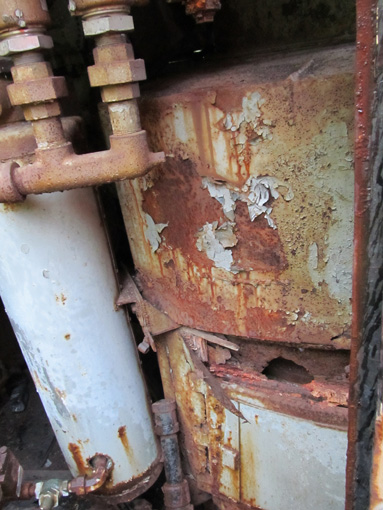

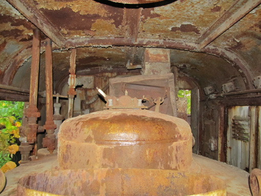

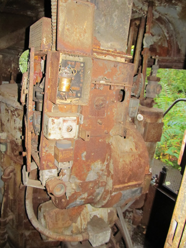

And here gentlemen I have some new images of the inwards of PRR 8479's short hood, enjoy
