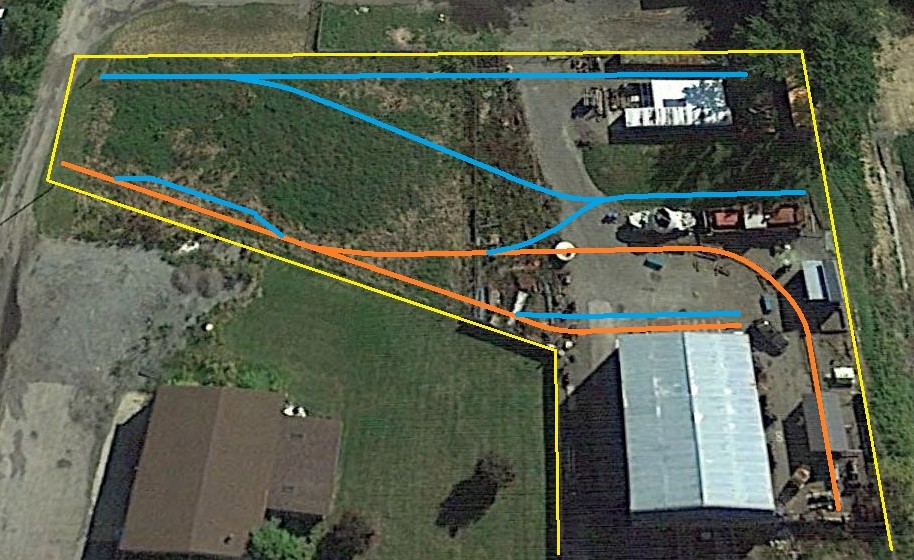

This is the latest revision of the track plan for the J&L Narrow Gauge Railroad. The orange lines are tracks that are either in place or that we hope to have complete by the end of this year. The blue lines denote future extensions. Our property is only 300' long so we will be fitting a lot into a tight area. The second leg of the switchback will gain about four feet in elevation in about 80 feet to reach the plateau at the rear of the property.
Being built as a steel industry themed operation, we hope to show that by using narrow gauge trains a lot of operation can be squeezed into a small area. This was the main reason for using narrow gauge in steel plants.
The entire railroad will be built using rail from 85 lb. to 115 lb. with No. 3 and 4 turnouts. No rail lighter than 85 lb. will be used, allowing for the operation of the 58 over all of the trackage.
