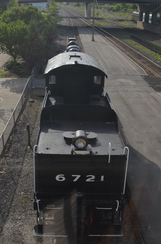

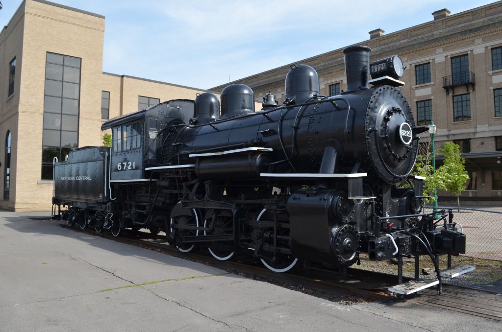

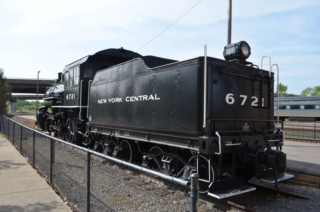

Managed to stop there on my way back to Niagara in May. Such a great looking locomotive, she's in great condition, this is quite upsetting. Here's a few pics from that day, 6721 in happier times. Yes, there was in fact a stop block in place, however, as someone else pointed out, if the car was loaded and free rolling for quite some distance, a piddly little stop block isn't going to stop anything!! I was actually quite surprised that the track was even still connected when I was there.
File comment: taken from the staircase of the now destroyed structure.

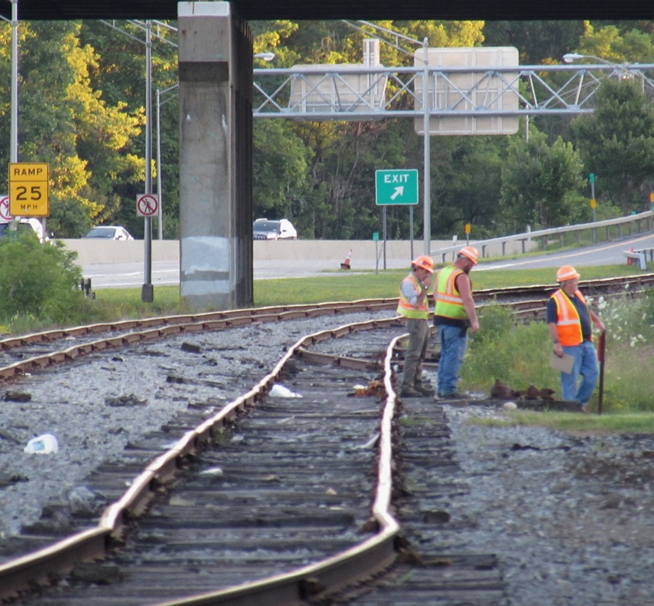

There is a derail just north of where the hopper began its journey. Here is a photo of three railroad employees clustered about the derail a few hours after the incident.
Vandalism is suspected as an article in the Utica OD mentioned that police were called approx 5:30pm to warn of a juvenile atop the covered hopper.
I don't know why the derail failed to work.

Posts: 209
Location: Liberty Hill, SC
Several ways it could fail-
It failed because the crew didn't put it on
It failed because the vandal knew what they were doing and took it off before releasing the car
It failed because the car was parked on the decending grade away from the derail. Several industries around here have derails to protect the mainline- however the grade decends into the industry so severly there is no way a car could travel towards the mainline unless shoved.
Adam McDowell
Owner ATOM Rail LLC
 Post subject: Re: NYC 0-6-0 damaged in runaway incident
PostPosted: Thu Jul 23, 2015 10:53 am
Posts: 728
Cars have been known to roll right over derails without derailing if they hit them at a high enough speed. Very rare indeed, but I've heard of at least two incidents in the past from working railroaders.
The evidence should be there, at least until it rains- there should be visible marks in the paint and rust if the car traveled over the derail.
That is, if the derail was actually placed in the derailing position after the car was spotted.

A car can't keep going through a split-rail derail, just saying. Yeah, I know they, cost more. One of those on the siding the train ran away from would also have prevented the Lac Megantic wreck as well. I do like the idea of just removing a length of rail from the spur the display is on, one length on each side about 100' from the locomotive would probably have kept it and the structure safe.
