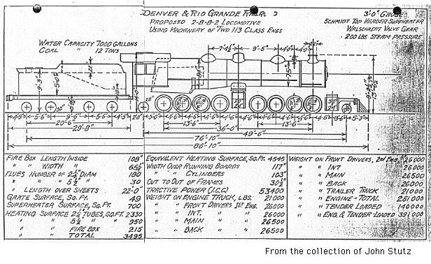

In historical fact, D&RGW had looked into 2-8-8-2s. One plan was a K37 style 2-8-8-2 using parts of two class 113 locos (C28 SG 2-8-0)

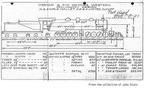

The other 2-8-8-2 the D&RGW looked at was all new 2-8-8-2. The longer wheelbase was probably for the weight restrictions on Lobato and Cascade Creek steel viaducts.
The new 2-8-8-2 was rejected 7/8/27. K37's were the result of the decision.

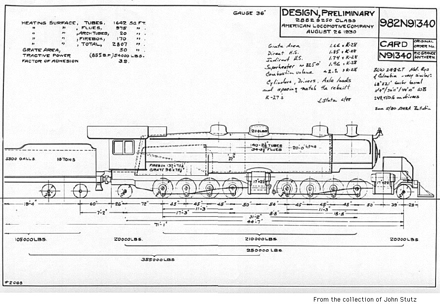

The RGS looked at a 2-8-8-2 in 1930. Based on the notations such as "Grate Area 1.66 x K28" and "Cylinders, Drivers, Axle loads and spacing match to the rebuilt K27" and "BLW 2-8-8-2T Nat. Rys of Columbia" they seemed serious in looking at options. I think that by 1930 the RGS was in receivership and no longer under D&RGW control.

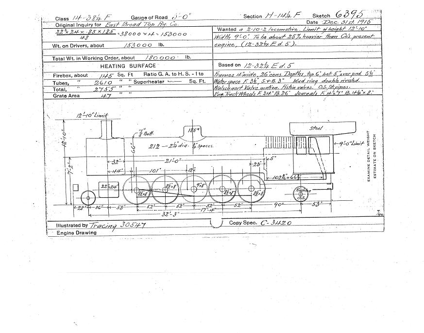

"In the case of both the D&RGW narrow gauge and the East Broad Top, I don't think that the next step in motive power upgrade would have been a 2-10-0 Decapod, but rather a 2-10-2 Santa Fe type. I wonder if either railroad ever gave consideration to doing something like that"
We just had someone provide the 1915 Baldwin 2-10-2 proposal for EBT in the thread about the Rio Turbio restoration...
