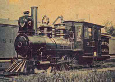

I hate to play devil's advocate (especially with friends!) but here is a photo of No. 9 in her earliest years as Sandy River RR No. 5 -- essentially new and as delivered. The jacket is clearly much lighter in color than the smokebox, domes, or cab. How does the new jacket compare to this?
-Philip

Philip
What do you call being devil's advocate to the devil's advocate?
The image you present is obviously a hand colored print from a B&W negative, so the color is strictly up to the colorist, who may have been working in a studio hundreds of miles away, and never actually seen the subject of the photo. Hand colored photos are notorious for getting the colors of passenger equipment wrong. The image only illustrates what the colorist expected the boiler jacket to look like, which, I suppose, is a useful addition to the discussion, but it may not be actually recording the color of that particular locomotive.
