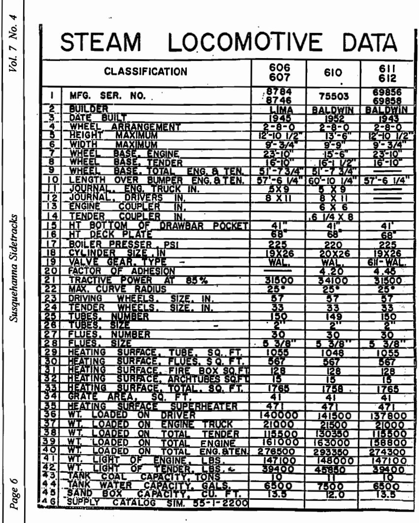

TVRM #610 (which is the last locomotive featured on the video compilation, is not an S160, but a post war Lima of about 1955 vintage.
610 is supposed to be very similar mechanically to the S160s, although there are cosmetic differences. I found this comparison in a Susquehanna NMRA Chapter bulletin.
One of the specs for the 610 jumped out at me. Note the engine wheelbase for the 610 is listed as 15'-6" while the wheelbase for the other locomotive series is listed as 23'-10". This is so different that it seems like it must be a mistake. The MINIMUM wheelbase for 57" wheels would be 13'-5" with NO spacing between wheels for things like brake rigging.
Anyone out there know anything more about this?

Diagram posted May 26 shows a total engine wheelbase of 23'3" and a driver wheelbase of 15'6". Maybe somebody else can explain where the 23'10" figure comes from.

The specification sheet from four locomotives that BLW provided to the Alaska Railroad in 1943 gives driving and rigid wheel base as 15' 6", total engine as 23' 3", and engine and tender as 51' 7-3/4". It wouldn't be practical for the Army engines to be different, so I suspect the Ft. Eustis dimensions (which appear to have originated in an Army publication) were in error.
I think I know why 610's boiler appears to be the same but has one less tube. There is a single tube at the top center of the tube nest, above the flues on the S160 boilers.
