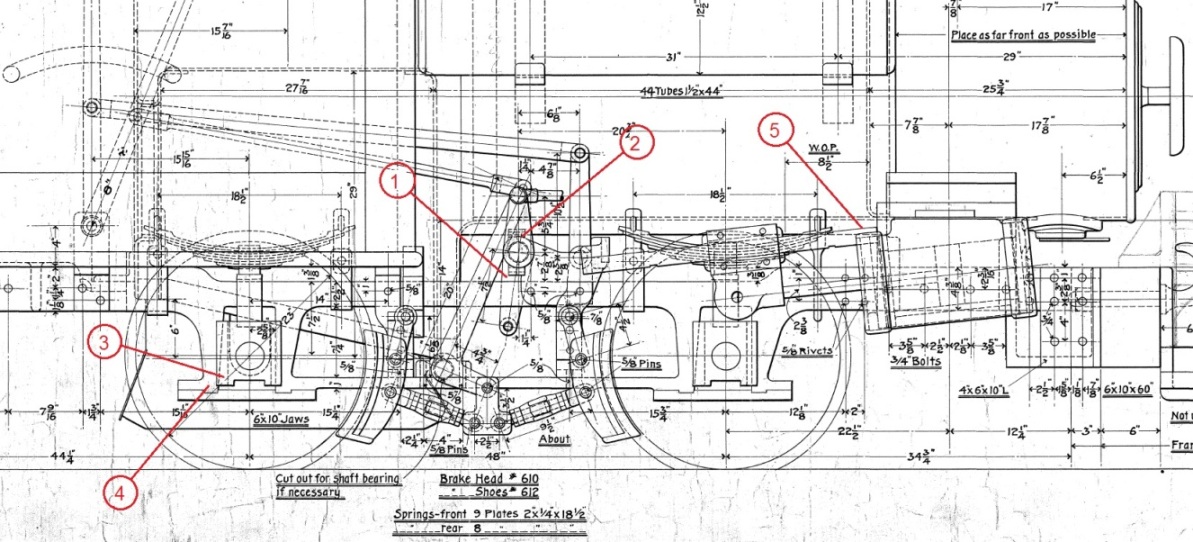

Porter construction numbers were typically stamped in numerous locations, sometimes the complete 4 digits, other times, just the last 2 digits.
Raised cast numbers are typically pattern numbers although, there are some exceptions when the locomotive was part of a custom build.
Common locations are as follows.
1. Valve rocker lower arm, outside to frame - 4 digit CN and cyl size and stroke i.e. 6X10
2. Valve rocker box castings and caps, top surface - 4 digit CN
3. Drive boxes, lower corner, inside - 4 digit CN
4. Frame pedestals, lower leg, inside - 4 digit CN
5. Cross head guide bars, front top - 2 digit CN and cyl size and stroke i.e. 6X10
6. Eccentric straps - 4 digit CN
7. Cylinders and saddle mounting flanges, top - 2 digit CN
There were numerous other locations. For example, on wood cabs, the CN was also stamped on the inside of the front cab pillar and all window sashes.
A bit of paint, dirt or rust can easily obscure the numbers.

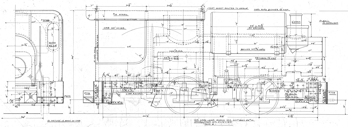

6x10 Porter Mine loco...

PostPosted: Thu May 28, 2015 12:34 pm
610BS -
Thanks for the drawings and especially for the explanation of where the Porter construction number might be located. Great info!

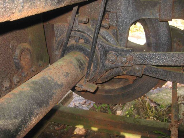

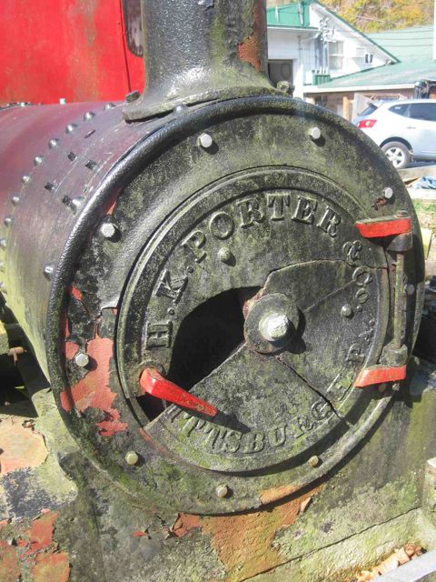

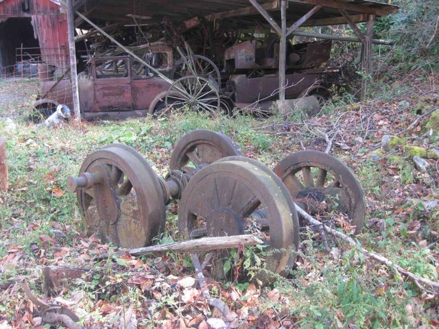

I stopped at Cool Springs Park on my way home from Cass last week. I'm afraid I had no more success than anyone else in finding a construction number on the Porter, but here are some additional photos that may be of interest. The smokebox door (which proves the engine's heritage) was apparently broken at some point and then clumsily pieced back together. Also, the "idler" drivers are apparently held in place with u-bolts! In addition to the EBT equipment and the odd set of 3' gauge steam locomotive drivers (Vulcan?) missing their engine reported above, I also came across a 3' gauge rail bike, the only narrow gauge example of this design I've ever seen.
It's a sad and distressing place, and after wandering around the place for 30 minutes or so I was almost in tears at the sight of so much decay and neglect.
-Philip Marshall

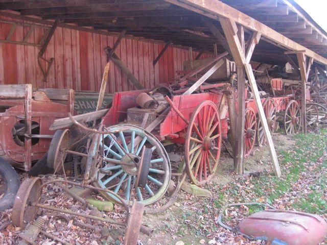

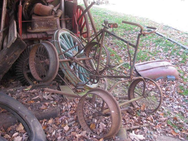

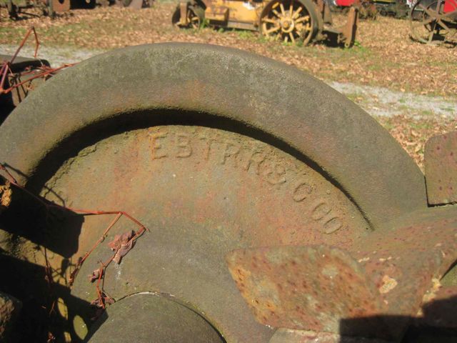

Three more pictures: (1) the rail bike and the various wagons and farm implements and antique cars with which it shares an open-sided shed; (2) the 3' gauge Vulcan drivers; (3) EBT markings on one wheel from a pair of 3' gauge trucks.

The "&" in the name tells me this loco was built before 1899.

The rail bicycle is identical to the ones used until the end of the 20th century by FEGUA (Ferrocarriles de Guatemala), for their telegraph linemen. I believe these were made by Buda, we called them "Bicicletas de Via". I have fotos and videos of these being hauled in trains, loaded either onto the tender deck or roof of the cabus (our spelling), but no way to post them here...

TAN: Did East Broad Top Railroad & Coal Co. cast their own wheels long ago? They made castings for other customers, even after March, 1956, and delivered some in Motor Car M-1 after the end of Steam freight operations.
