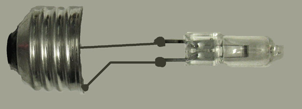

Hopefully the new source will be fine, the problem is solved and this is moot. But here was my idea for something that could be done by a small entrepreneur using existing halogen bulbs (assuming there is one suitable). Thus they would not need to be concerned with filament forming, evacuation, argon, etc. just a little spot welding of lead extensions to put the filament where it needs to be. Bulb shown is an Osram HLX 100W / 12V. I imagine a higher wattage bulb would have a larger envelope. Maybe bigger leads and two to the shell would better to thwart vibration. A more elaborate solution would involve an actual socket for the bi-pin bulb. Think outside the box.
