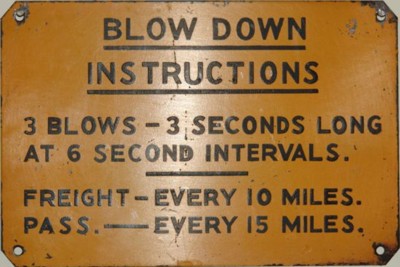

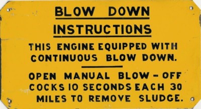

One railroad's policy on boiler blow downs. CN installed these signs in the cabs of many of its engines.
