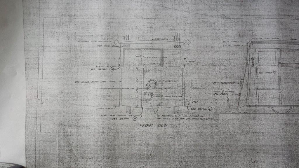

Thanks to a tremendously helpful and generous Daniel Biernacki, we now have a drawing of this railcar - which on the plans dated June 12, 1935, is an Inspection Car.
Between this drawing, and the pictures and notes we've been taking as we clean this car, we see no reason why it cannot be fully restored and rebuilt.
Here's a teaser from the drawing - Front view, and part of the side.
Be sure to come by the Stweartstown Railroad and see the progress we're making on this historic car.

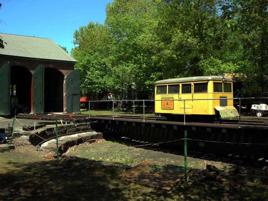

As far as the `come ride the train' only to find a Railbus issue. So far the railbus we have at Ct Eastern RR Museum is more popular and people are actually thrilled to ride it instead of the train (flatcar with benches pulled by GE 44 ton or 25 ton locomotive). They tell us it is because it is something different and it is cute, to tell the truth everyone smiles and waves,when they see her trundle down the tracks, especially when we toot to the people on the railtrail that runs parallel to the museum tracks.
Ours is a 1937 Fairmont Railbus model 3100, seats 6 plus Driver (2 double and 2 single seats). The seats have swivel bases that lock for forward or rear facing, so we keep a double and a single facing forward and the other 2 facing backward. She was an Inspection car and a Crew van for the Maine Central and occasionally pulled a small cart of materials (roughly 6 foot wide x 8-10 feet long) or a clearance frame to check and maintain the RoW.
The advantage of the railbus is both in fuel and staffing. The train, which we mainly use on event days, needs a minimum of 3 people, engineer and brakeman in the locomotive (hard to see through the engine hood) and a conductor with the passengers. Whereas the railbus only needs 1 crew member as the operator is with the passengers and it is a small group. When we have enough visitors where I can run the railbus without shutting down, I average 4 runs a gallon of gasoline, 2 if I shut her down between runs (1.5 mile round trip), IIRC the 25 tonner just under a gallon of diesel a run with her small 6 cylinder Cummins and I am not sure of the burn rate of the 44 tonner when running only one Cat D17000 engine.
If you restore the Erie 800, and plan to run her regularly, be smart and replace the engine with a similar sized modern engine and possibly convert the transmission to automatic. Of the 2 Fairmont 3100 railbusses I know of (ours and B&M 500 at Seashore Trolley Museum in Kennebunkport Maine) have both been upgraded for reliability. The B&M 500 recently received a Slant 6 Dodge, and ours has a 1969 Chevy 230 straight 6 with a 3 speed automatic. They originally came with Waukesha 70HP 6 Cylinder engines (optional 100 hp Ford Flathead V8) and 3 speed manual transmissions. The thing that makes the upgrade easier, in the restoration viewpoint is that the engine and transmission are hidden and unless you tell someone, no one knows that it is not OEM.
When we received the railbus the engine and transmission were gone and the current engine and transmission were donated by the member restoring the Railbus. Old engines are hard to find new parts for, whereas a semi-modern engine is relatively easy to find parts for, in fact the Waukesha engines are near impossible to find parts for without going part by part through the catalog with a set of micrometers. As related to me by B.Y. at STM when he started to look for parts to rebuild the engine in the B&M 500, it was easier to find hens teeth (if you don't know chickens have no teeth).
Now have you dug deep enough into the 800 to find out what her power brakes are? Are they air pressure, hydraulic, or Vacuum like ours?
