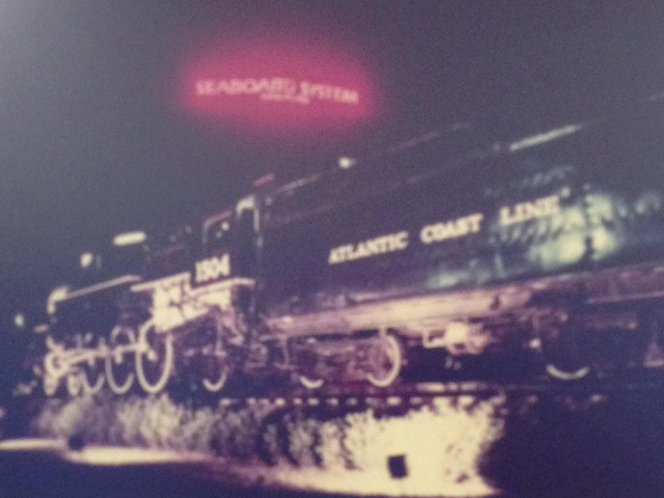

Progress on the project is being made daily and moving forward, this is the things that can't be seen but have to be done. Up to date information can be found on the Facebook page that we have set up.
https://www.facebook.com/pages/Atlantic ... 511?ref=hl
The nice thing about that page is we are getting feed back real time and some good information has come our way as a result of the page. Today we got this picture of it on display. We are slowly getting bits and pieces of history.
Mark A. Frazier
Project Manager
File comment: Album: Public
Thank you to Ted P Howard for sharing this;
Picture was taken by the brother of a former employee and was passed from her to my brother when she left the company. My brother gave it to me when he left CSX. I now have it proudly hanging in my office at CSX. I remember watching her being moved from this location to the convention center. It's a great picture.
