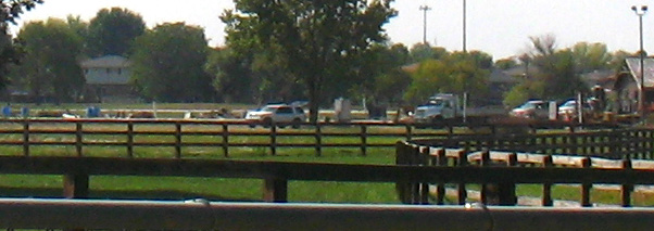

I had to go to the animal shelter across the street so here is the view today, from approximately the same angle as the shot at the top of the thread. No cars visible. I didn't enter the property or attempt to surveil it from all angles.

PostPosted: Sun Sep 29, 2013 12:04 am
Posts: 328
'Tis gone...

PostPosted: Sun Sep 29, 2013 10:10 am
Posts: 1352
Location: Chicago USA
Maybe it's in transit via Jimmy Joe Bob's Rigging & House Moving but I'm not holding my breath.
