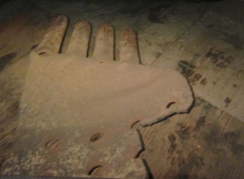

M Austin wrote:
k5ahudson wrote:
Too bad the photo he posted is mine. I took the photo at the Ohio Central shop in 2001 only a few days before 9/11.
Well... aahhhh......nooooo...... J David can pretty much use my photo as a "WANTED" poster for his missing piece. It looks like JD got the middle piece with the knuckle crack slit open which helped mitigate the kerboomability factor of the failure.
"Well... aahhhh......nooooo"??? Sorry, but I did take that picture in the upper storage loft of the Ohio Central shop at Morgan Run in early September of 2001. You can see steam locomotive parts, including a safety valve, in the background.
I originally posted the photo on another site in 2004, which is where I assume the poster in this thread got it from. http://abpr.railfan.net/abprphoto.cgi?n ... nsheet.jpg
 Post subject: Re: Gettysburg Railroad Partial Crownsheet failure 1995
PostPosted: Mon Aug 05, 2013 6:19 am
Posts: 489
Sincerest apologies.... After digging through albums I found photos I took of JDC's piece. His was a corner piece, not the center. This was probably taken in the late 1990's. I don't remember when or how your photo migrated into my "badboiler" directory, most of which were taken personally, the remainder provided directly from the photographer.
