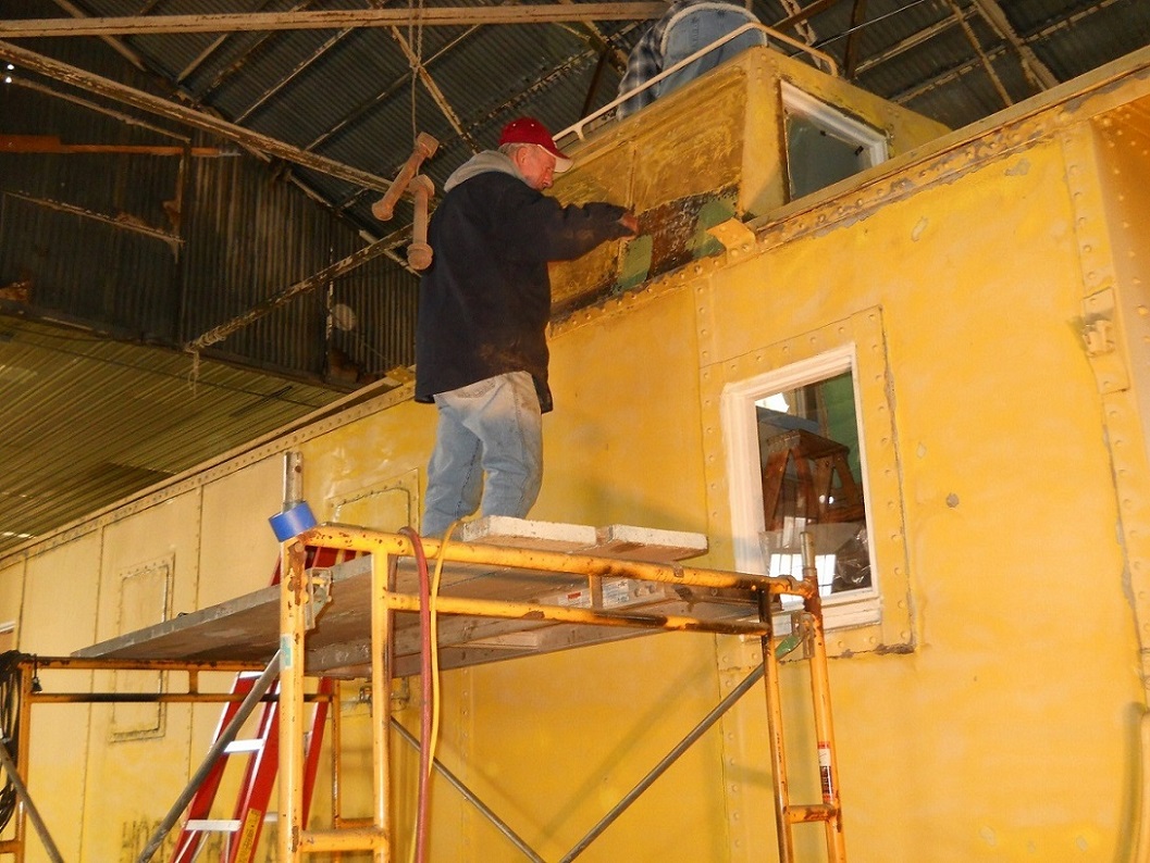

We're still working on our Illinois Central Iowa Division caboose and here is a photo of member Joe Kingsbury doing some work today (11/23/13) on the cars cupola. We have had leakage problems through the years, and they were getting worse, which is why we finally decided to bite the bullet and pull the car in for restoration. Because of the fire in the car sometime in its past, the buckled roof provided a poor seal with the cupola, plus we have discovered other areas rusted out. The damaged wood on the interior walls has all been replaced, so that is done. We still intend to paint the exterior of the car in one of its later orange paint schemes (either as ICRR or Illinois Central Gulf) although we contacted the IC Historical Society about the lettering drawing quite some time ago, and have still not received it. Hopefully it is coming. When received, and when the last of the outside is repaired, the display caboose will be ready for painting and then we will finally have to decide which Iowa Division road number to put on the car.

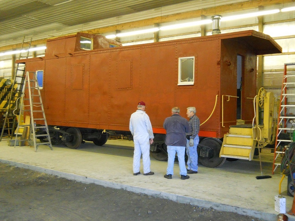

Here's a current shot of our IC Iowa Division caboose, now wearing a new coat of primer. We're getting closer!
Joe Kingsbury, Bob Albert and Fred Boyer (l. to r.) are discussing the next stop in the process, and are standing on the new strip of concrete put down recently in this West Annex of the museums Shop building. This brings the concrete in this 50' x 98' building up to about 50%. Next will be the installation of the track on the other side of the building. Then eventually, still more concrete!

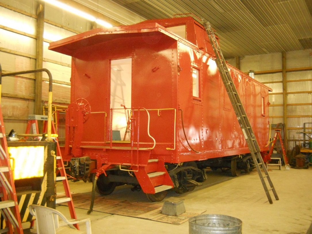

Now shown wearing her new coat of orange paint. Next up will be the lettering, although minor work is still ongoing. Today we were needle scaling the two roof walks that go around each side of the cupola and also managed to get those primed. Still must paint them orange and put them back on. Also finishing up the interior painting.

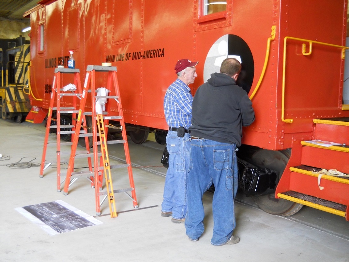

Lettering is going on the IC caboose! Check out the photo.

Yes it is vinyl lettering. Bjarne Henderson ordered the stencils from the IC Historical
society, had the vinyl copied exactly as the stencils. It went on easy, using blueprints
of the caboose lettering, it was put on exactly down to the rivet. Using a hairdryer
to force out any air bubbles, it was lettered and done in a couple of hours. Display cases

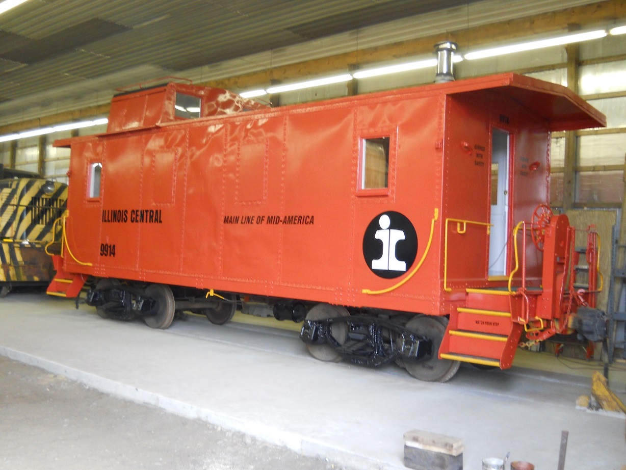

Realized that I had not posted a photo of the IC Iowa Division caboose after the lettering was finished. Although the exterior is now done, there still needs to be some minor work finished on the inside, and then the displays put back in (remember, this is our display caboose and a long ago fire destroyed the interior).
Some may recall that this long running thread was started in an attempt to find the original IC number of the car. After many attempts, that effort proved fruitless, so the car has been given one of the numbers in the Iowa Division series that is NOT known to exist. Since there is the possibility that IC #9914 might eventually show up somewhere, a number was chosen that could be fairly easily changed. Thus if number 9914 shows up in the future somewhere, then the cabooses number will be changed to 9911, with fingers crossed that THAT number doesn't show up one day too.
