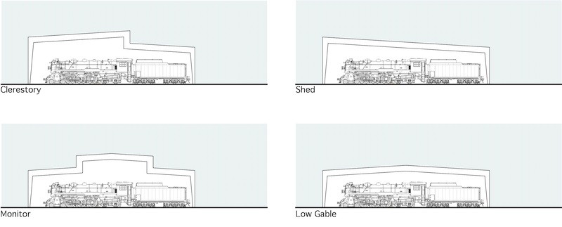

I wouldn't completely discount the significance of the skeleton. Jacobson seemed to think the inside is important enough to justify the expense of heavy timber trusses in his roundhouse. The interior of this steel building system roundhouse will look markedly different from a historic building. Not necessarily a bad thing, but worth being aware of.
Also, some skeletons come in very different shapes. Some might say the roof shape is a bigger part of a roundhouse's look than whether it is brick or concrete on the outside. Here a are a few of the different roundhouse roof typologies that could probably be made with clear span steel frames:
They don't have to be clear span of course, but with this system, they could be. The more shapely roofs would be more efficient with a column or two.
So, which roof do you want?

Aesthetics will come into play for roof selection, I should think. Most of the wood framed, wood sheathed roundhouses I can think of are shed roof designs. So, if all the budget allows for is pre-finished steel sheathing, such as Strongpanel, which looks mostly like board and batten siding, the obvious choice is the shed roof. Conversely. if the budget allows brick veneer, the clerestory or monitor designs would be more appropriate (although I can think of some small brick roundhouses with shed roofs). To me the the low gable is the least aesthetically pleasing, although I can think of some C&NW examples of small wood houses with this roof... however, the originals weren't very pleasing to look at, either.
Whoops, spoke too soon... A quick browse through Locomotive Facilities C&NW and CStPM&O - Engine Terminals by A. Joseph Follmar shows that this style was popular, at least on the NorthWestern around 1900, rendered in both brick and wood. I realize that everyone has their own favorite prototype, but I recommend this book as a source of inspiration, as it has photos and drawings of multiple roundhouses, built by several predecessor companies, from the 1870's through the end of steam.
Don't discount the steel frame, steel skin building. Modern day construction often uses a single course of brick veneer to face what is otherwise a plain-Jane metal building,using the stiffness of the steel construction to stabilize the thin veneer of brick. It is a detail that could possibly be added later, as funds allow, provided the foundation is designed from the beginning to carry the brick.
Sure, but there are lots of costs associated with any individual project, whether it's to add to stalls, or just add brick. It is much cheaper to have it included the first time.
It may make sense to break things out of the contract that volunteers can easily do themselves after the building is done, but it can be problematic to impossible if these are things that need to be done while the contractor is still on the job, or are needed for a certificate of occupancy.
Harriman seemed to like low-gabled roundhouses with narrow monitors along the roof ridge. A number of the SP roundhouses around here had been built that way at a time when the railroads thought Consolidations might be the pinnacle of motive power. By 1910 or so, SP was pretty much out of the roundhouse building business. They must have figured out that engines were going to continue to get bigger than their turntables, so SP started building parallel-tracked enginehouses with wyes nearby such as the ones at Suisun, Indio, Colfax, Mojave, and many others.

robertmacdowell wrote:
Much wider than that. Look at the WRM shop, designed by Dave Johnston. I believe the tracks are on 30 foot centers and I wouldn't go much tighter than that. It leaves room for scaffolds on both tracks, plus forklifts, plus a few tools and parts to be set out. One running track, one long-term project track, with room for 2 cars each. That's an essential trick of that shop's design -- with so little track space, it guarantees projects don't go into the shop and die. There simply isn't room. The wings are a wood shop, a metal shop and all the other stuff a shop needs. No bathroom. Walk 200 feet to the VC.
I'm toying with another shop design, take WRM's layout but push the tracks apart to 50-60 feet, and push the wood and metal shop between them. The outer wings then become project and storage areas for the adjacent tracks. Storage: set some containers there for lockable space (cheaper than cages, more secure, opaque, has usable roofs, and no building permit required).
The center part of WRM's shop is a recycled building (a lumber yard which was removed to build the BART line in San Leandro). The side wings are WRM add-ons which had to be specially engineered to expand the building.
I'm not sure that having wood and metal shops really close together is a good idea. Sawdust really makes a mess when it mixes with oil in a machine shop, and lots of oil can cause problems in finishing woodwork.

J3a-614 wrote:
I seem to recall a number of standard roundhouses were built of steel, covered with corrugated sheathing on the outside and industrial metal windows. I'm not positive, but I think the Brooklyn roundhouse in Oregon (current and soon to be demolished home of SP 4449, SP&S 700, and some other stablemates) is such a standard structure from the Southern Pacific. Something like this, using fabricated steel trusses instead of girders, might be an acceptable approach that also maintains the interior look of an older roundhouse, while the corrugated steel on the outside would replicate the exterior appearance, even with a modern girder type skeleton. In fact, I'm a little surprised that a large replicated roundhouse in Ohio uses as much wood as it does; I would have thought an emphasis on fireproof construction would have made steel a better choice.
We are looking at the steel girder approach in this discussion because it is more affordable. It is very expensive to fabricate trusses out of riveted angle iron as it had been in the past. By using the pre-engineered steel frames, we are trying to keep it in the world of a proven and reliable building system that is currently the most affordable way to put up a permanent building.
Accurate, or closer to accurate reconstructions of any type of historic structure can be designed built, but at greater expense. Clearly, The Age of Steam project has chosen this approach. Although I am not that familiar with Midwestern roundhouses, and I have wondered if the use of heavy timber trusses is appropriate for a roundhouse of that design? That said, heavy timber is more fire-resistant than steel trusses.
