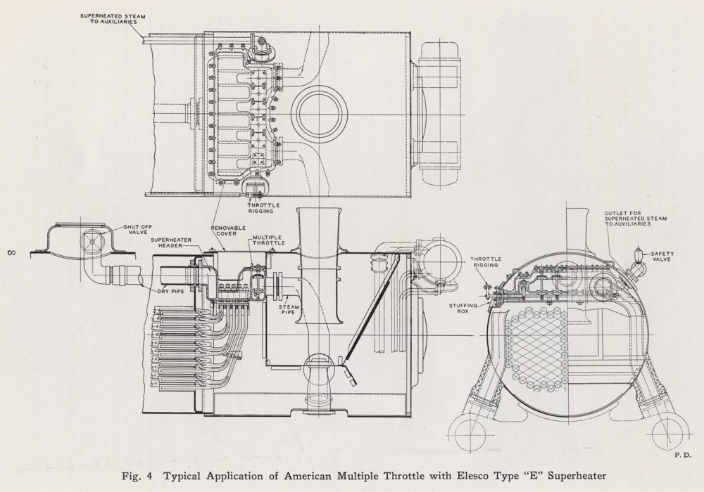

Some quotes from an American Multiple Throttle manual:
When the smokebox throttle is applied, the superheater damper and rigging and its maintenance expense are eliminated. Practically at all times when the superheater is filled with steam there are one or more auxiliaries and the blower working; therefore steam is flowing through the units when the throttle is closed, thus affording protection to the superheater units.
Only when such protection is afforded, however, may the damper be dispensed with without the danger of overheating the superheater units. From the viewpoint of maintenance , the presence of steam in the units at all times greatly reduces the possiblity of burning the unit ends and tends to protect the equipment and prolong the life of the tubing.
On CNR 6167, the steam supply for the blower comes from the whistle, which is in turn routed from the throttle. When she was built she did have a pipe running from the throttle, along the running boards up to the turret to provide a supply of superheated steam for the auxiliaries, but this was removed, likely within her first decade of service.
Unique Advantages of the American Multiple Throttle:
2. Close regulation of the steam supply to the locomotive cylinders.
Finely graduated steam admission due to multiple valves opening consecutively smooth starting and stopping ; better control of the locomotive. In addition it permits regulation of the amount of drifting steam with possible fuel savings...
From a 1925 Elesco Superheater Book:
When drifting or running without steam, sufficient steam should be used to prevent air or smokebox gases from entering the cylinders and steam chests and thus avoid the destruction of the oil. The required amount of steam can be secured by cracking the main throttle or from an auxiliary drifting throttle.
It is well known that carbonization of oil in engine valves and cylinders destroys its lubricating qualities. A combination of air or oxygen and oil at temperatures above its flashing point is sure to be followed by carbonization. To prevent this combination, the throttle may be slightly open or cracked when the locomotive is drifting. Keeping steam in the cylinders at all times while the engine is in motion prevents the intake of the products of combustion in the front end of the locomotive, which destroys the lubricating properties.
