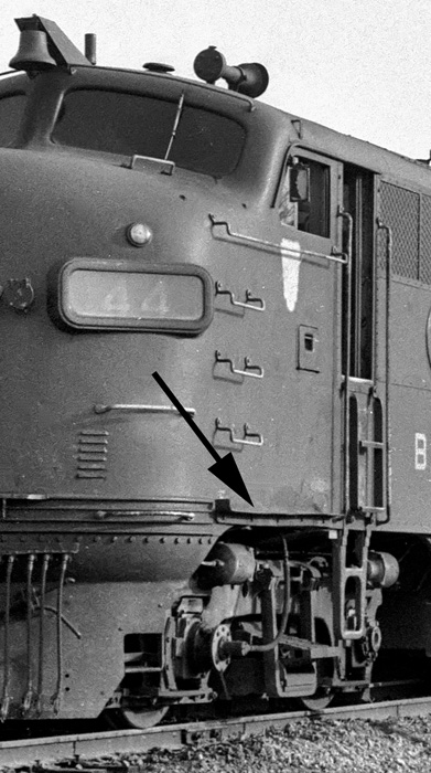

Looking back at the CDOT rebuild carried forward... what was the purpose for cutting the cab sides and insetting them right below the cab windows? (between the side ladders and the windshield post and under the floor deck?). Did they modify the sandboxes?

The cab sides are not inset. What you see is a continuous tread enabling a laborer to access the top of the nose from the side ladder for the purpose of cleaning windshields. This is a requirement dating back to the days of the ICC.
I think you are seeing the 3" wide walkway not a cut inset. Some railroads used this as a way to get to the windshields. I've attached a BAR photo with a similar walkway mounted much lower.

This is right... with one potential note.
To save scrolling, here is one of the pictures of the units as repainted:
http://www.railpictures.net/viewphoto.p ... 151&nseq=4
Observe the triangular reinforcing gusset at the end of the small walkway. That was not present on either of the CDOT locomotives as they went off to refurb. Personally, I think this is a reasonable safety improvement over the "previous" version which appeared to have a sharp corner...
