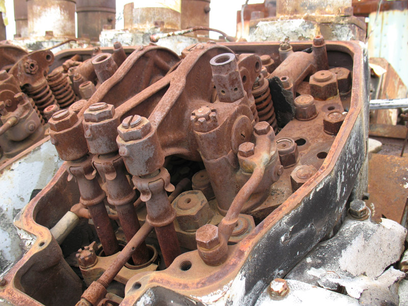

Closeup of cylinder head.
 Post subject: Re: Working Winton 201 – Are there any?
PostPosted: Thu Jan 26, 2012 11:34 am
Well, that certainly has a familiar look to it; kinda like a combination of 567/645 and GE 7FDL engine top decks. You can see the obvious 3-rocker arm concept and fuel rack pushrod to the unit injector-- pure 567. And the individual rocker boxes standing proud of the top deck of the block, well, that's as GE as it gets!
Hope someone gets some preservative goo onto this thing to keep it from getting worse.
No Pushrod, CT

What is the curved lever on the left side, touching the top of the injector rocker? Is that the cut-out for that particular injector?
PostPosted: Thu Jan 26, 2012 4:27 pm
Posts: 598
Howard,
Thats the overspeed trip.
Heres a good diagram from the USS Slaters website:
Paul
PostPosted: Thu Jan 26, 2012 4:28 pm
Posts: 522
Location: Illinois
My geuss would be the overspeed trip for that cylinder...looks like its run by a small hydraulic cylinder
Jeff

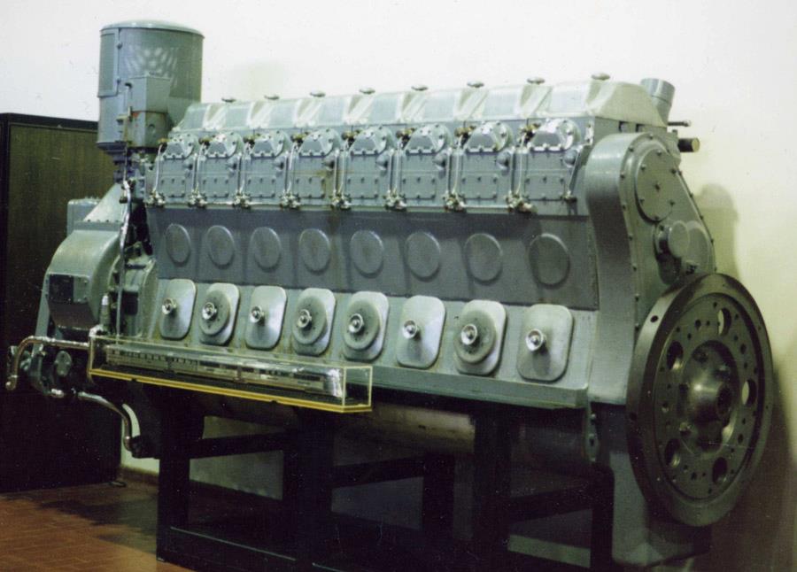

Here is the original 8-201A power plant from the (Pioneer) Zephyr, on display at the Smithsonian in DC. (I don't know if it is still on view since the area near SR PS-4 1401 has been extensively remodeled.) Compare this engine to the 8-201 prototype on the first page of this thread and also note the Zephyr model in front of it.
The Zephyr, on display at Chicago's Museum of Science and Industry, does have a a 201A in it; presumably whichever was aboard when the train was retired in the early 60's.
Steve

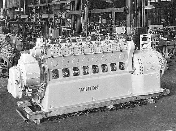

Dug out a couple more I had stashed...
