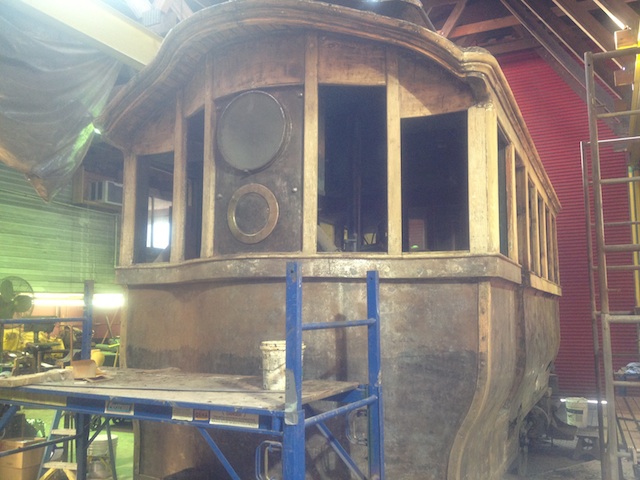

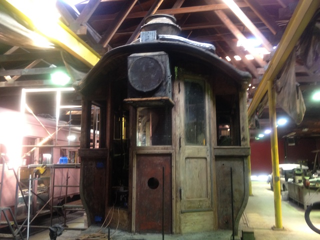

In addition to Mr. Carter's excellent website and photos, I took a couple of photos yesterday when at MOT. I apologize for the lack of quality, as I forgot to bring my digital camera from home, relied on my iPhone's camera.
Still, the photos show excellent progress. Most of the old paint and corrosion has been removed, individual wooden parts are being stripped, and work is being done to conserve the structure and address some minor rot issues.
She should be a real beauty when finished!

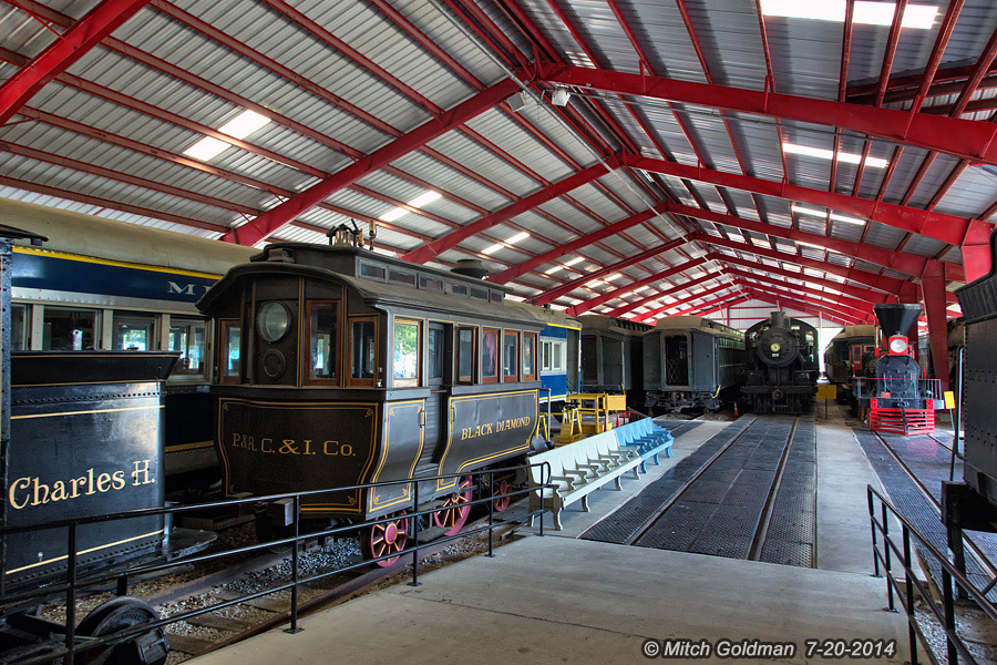

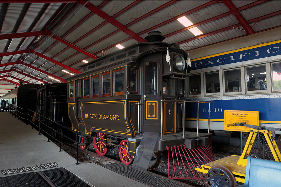

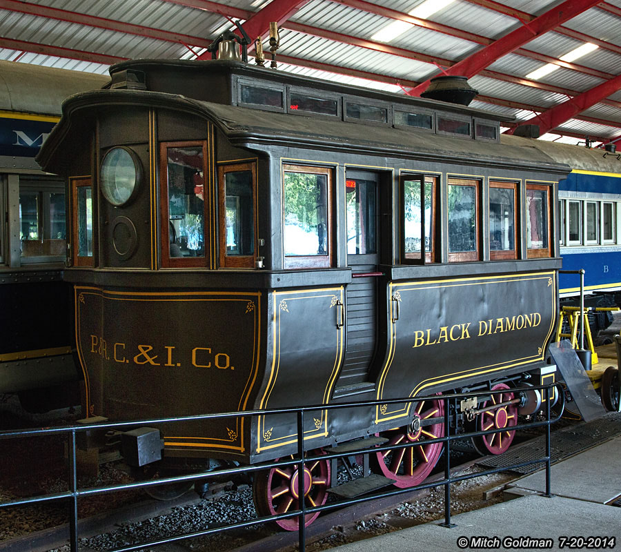

 Post subject: Re: Restored - the "Black Diamond"
PostPosted: Sun Aug 03, 2014 12:34 pm
Posts: 596
And with what seemed like quite a bit of further adieu -
The restored Reading "Black Diamond"!
Finally got a chance to return to St Louis in late July to catch up with one of
my favorite displays. Looks as if they moved her into the shops just after
my visit in 2011 (Before pic within this thread) and have wrapped up a very
impressive restoration in the Spring of 2012. Surprised no one had posted
pics on RYPN, though it appears to have slipped into the April 2012's issue
with a pic of the loco out in the open though prior to restoration.
It is currently on display outside under the canopy.
Great job!
/Mitch
