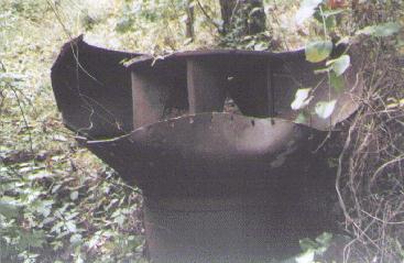

This partly scrapped balloon stack is at the Southern Forest Heritage Museum in Long Leaf, Louisiana. It may be part of a graveyard of parts from a scrapped Shay locomotive; you can see the baffles inside.

Cap stacks were a typical Victorian design element, and were decorative only. While a railroad could specify a cap stack, builders like Baldwin would often include them on their stock engines--even their little plantation engines might merit the decoration, as shown here:
The cap itself is cast iron, and simply rests on top of the stack, its weight keeping it in place.

In the picture above by Jim Hefner, you can see that the stack is made of heavy gauge sheet metal with the exception of the curved ring around the middle of the stack which is a cast iron part (and very heavy). The stack is off of Crowell and Spencer Lumber Co #200 (a 2-6-2) which was scrapped at Longleaf in 1954-55. Part of the curved, cast ring was cut away during the scrapping process as you can see in the picture. The rest of the stack (the upside down cone shaped top, resides across the track from the stack.
An identical stack has been removed from Reader RR #1 and taken to Florida and installed on Reader #2 which is starting up a tourist operation in Tavares. And yes, it is burning wood.
