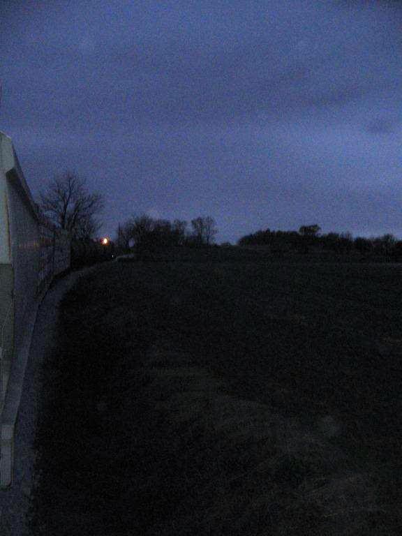

Extra 8618 crosses the new bridge westbound at dawn this morning. It's fitting that the first non-MOW train across is revenue freight.

Is this from a caboose?

Bob, should be. It was shot from forty-four tonner PRR 9331 who was in residence at Leaman Place to switch out the interchange during construction.

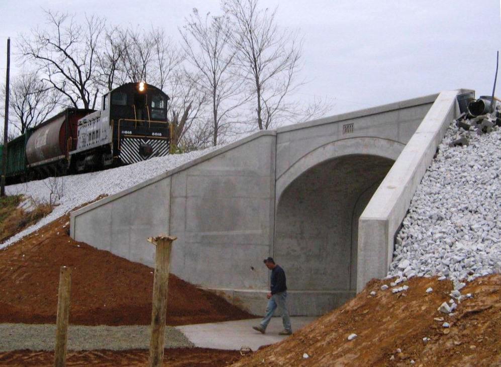

First eastbound yesterday. This one was in the daylight. Sorry, no steam ...

Post that picture as a "where is it", and Strasburg RR would not likely come up as an answer. That is indeed different.

Looks like the Putnam Division about 1962.... great looking bridge!
