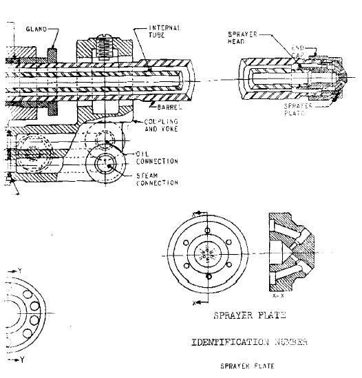

FOR INFORMATION ONLY =
BABCOCK & WILCOX OIL SPRAYER PLATE FOR POWER PLANTS
HOLE SIZES DETERMINE FUEL FLOW FROM PRESSURES OF 5-50 PSI == ATOMIZING STEAM IS PACED 40 PSI HIGHER THAN FUEL PRESSURE

Very interesting, Matt - almost like a paint spray gun.
Might you have a drawing for the standard US marine burner such as one would find on the O'Brien?
