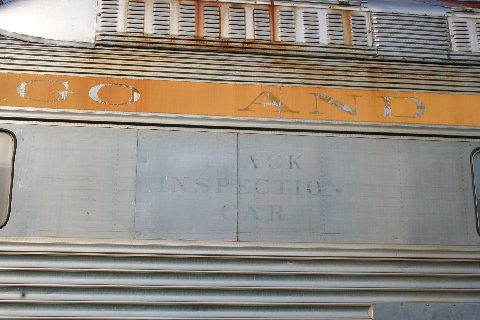

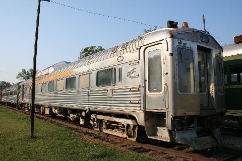

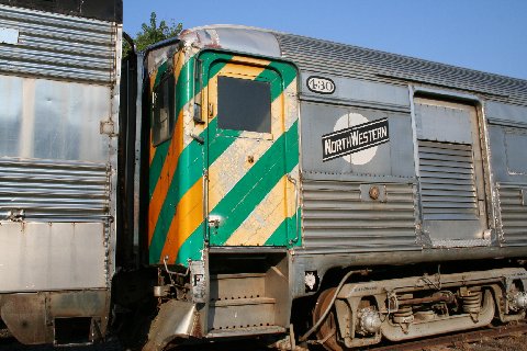

per Les's post , here is CNW 430 in French Lick last month
Dean Levin
