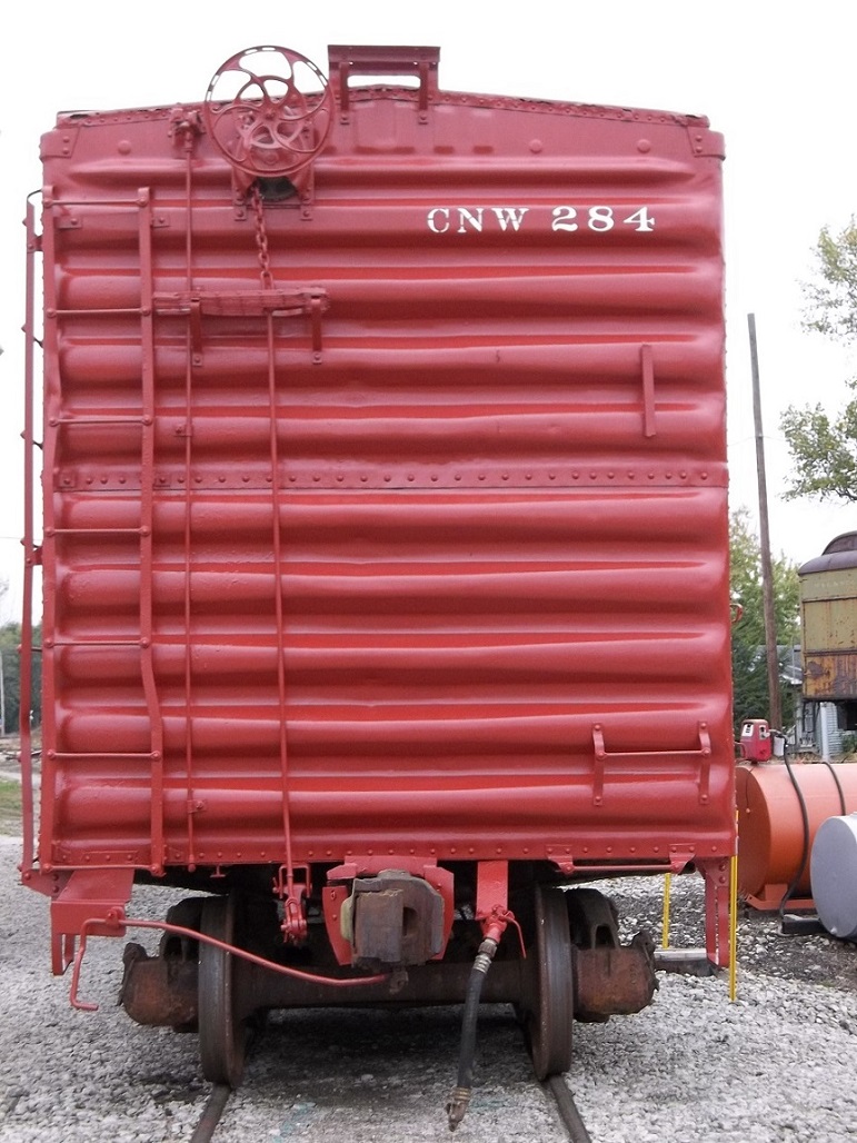

Mark sent me this photo of the end of CNW 284 with the lettering he applied.

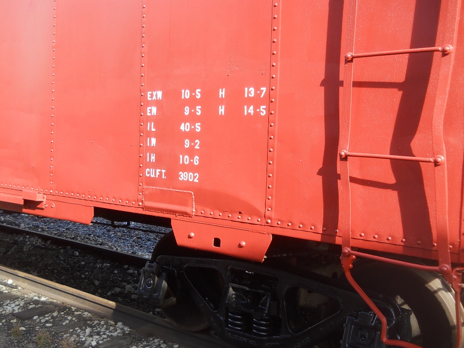

A couple of updates:
The first photo shows the informational data that Mark applied to the car while the outside weather was still good in late October.

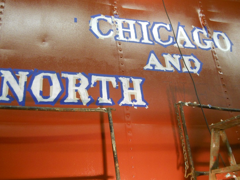

C&NW #284 was moved inside after our operations were finished last week. The East Annex of the Shop has no heat, but the temps this week were still good enough that Mark was able to start work on the lettering of the car. The second shot shows him at work today while the 3rd photo shows a close up of the Chicago and North Western lettering.

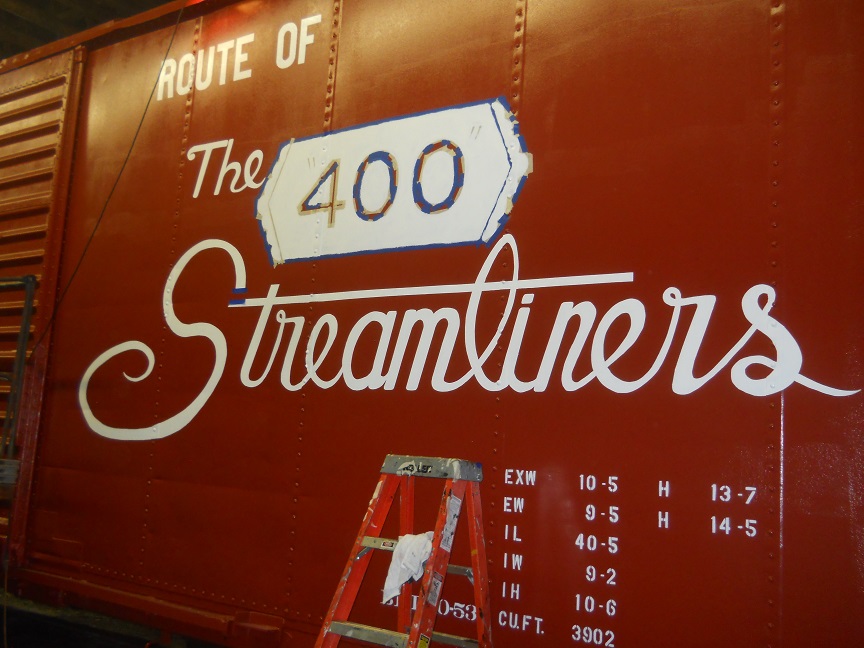

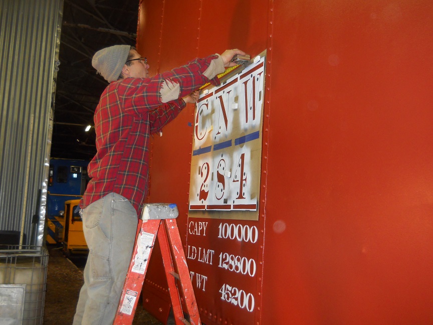

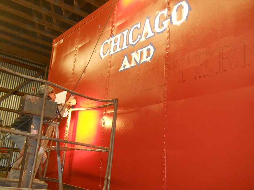

Mark continues his work on the 284. Here he is today in the Shop's East Annex (photo 1), taking measurements to make sure the CNW initials and the cars road number are straight. The results from earlier in the week on the "400 Streamliner" lettering are shown in the second shot. Another coat of white paint on the "400" section was still to be applied. Finally, in honor of the work on the box car, the cap shown in the 3rd photo was made for the museum.

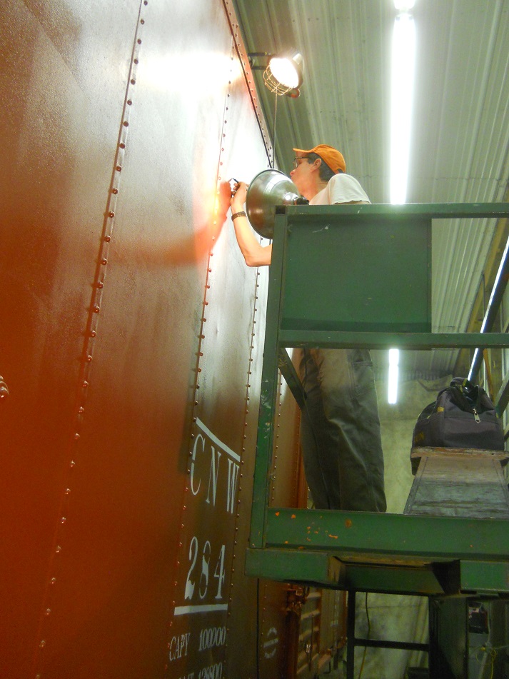

I too like the fact that C&NW #284 is being lettered with paint rather than with vinyl lettering. HOWEVER, this is also not easy! Here is a photo taken today of Mark working on the lettering. After he traces the outline using the stencil, he has to go over the lines so that he can see the edges when actually applying the paint!
One positive thing has occurred; the PS-1 has been moved in to the West Annex of the museums Shop. Not only is this annex insulated, so the temps are somewhat warmer, but the West Annex also has a concrete floor. This means that Mark can use our green lift rather than having to move, and stand on, ladders.

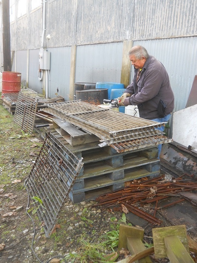

I've attached a photo from this past October of the museum's Bob Albert with the roof walks as he did his best to clean them up. I think a coat of aluminum paint is better than putting them back up after the "cleaning", but if you have a better suggestion, I'm open to it.

Not aluminum. Galvanized steel. The sparks coming off the grinder in the picture prove it. The original finish would have been hot dipped galvanized, same as the roof. While it's well known that paint doesn't stick well to galvanized, and eventually during the sixties / seventies the builders started shipping cars with unpainted roofs, during the fifties most roads were painting roofs car color, or black; and if they painted the roof, they painted the running board, too. Time, I think, to go back to the C&NW Historical Society with a question about painting practice, builder's photos, drawings, etc.
If it turns out they were unpainted galvanize, Rustoleum makes a nice high zinc "cold galvanizing" paint that drys a dull gray, basically the color galvanized turns as it weathers.

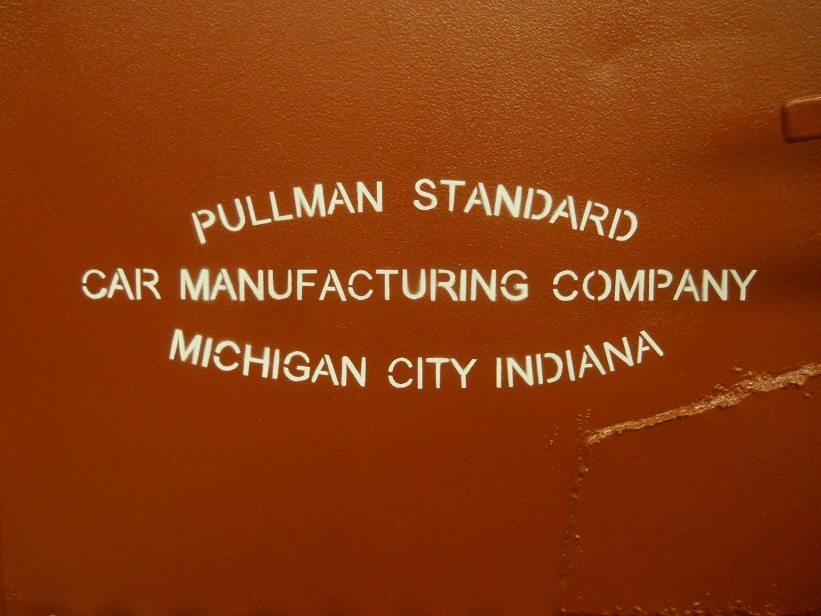

Builders info on the car.
