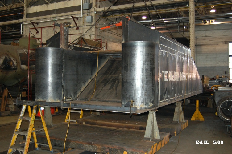

Sure looking foward to seeing the 26 run again. Hope its soon.
Ed K. cp Laurel Run
Edward J. Kaspriske
www.dieselairhorns.com
