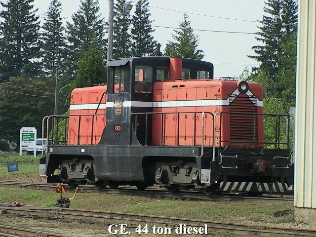

Valley Railroad.
Ed K. cp Laurel Run
File comment: 44 ton
Ed K.

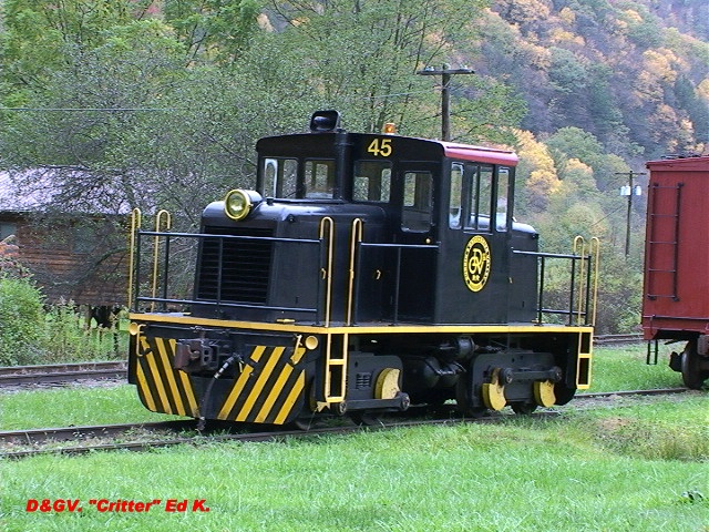

Durbin & Greenbriar Valley
Ed K. cp Laurel Run
File comment: Critter
Ed K.

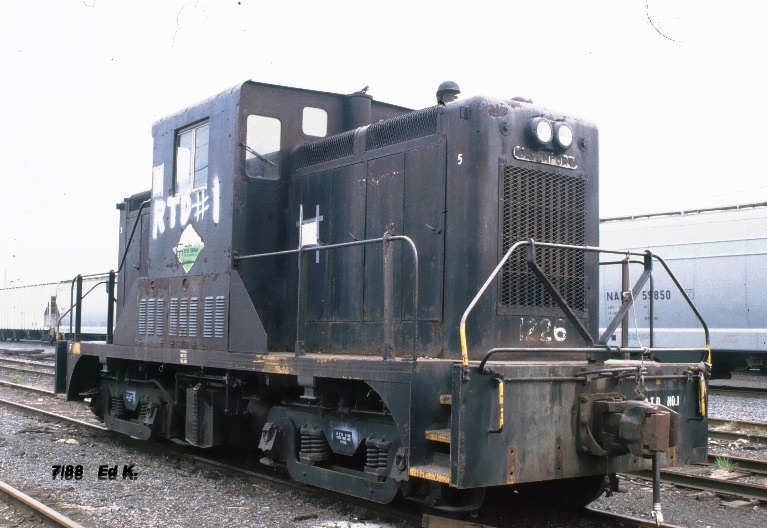

Unknown, photographed on Conrail's Lehigh line at South Plainfield, NJ. 1988, a set off in yard there.
Ed K.
Ed K.

m3ohwell wrote:
Unknown,
The manufacturer seems to be Davenport!
