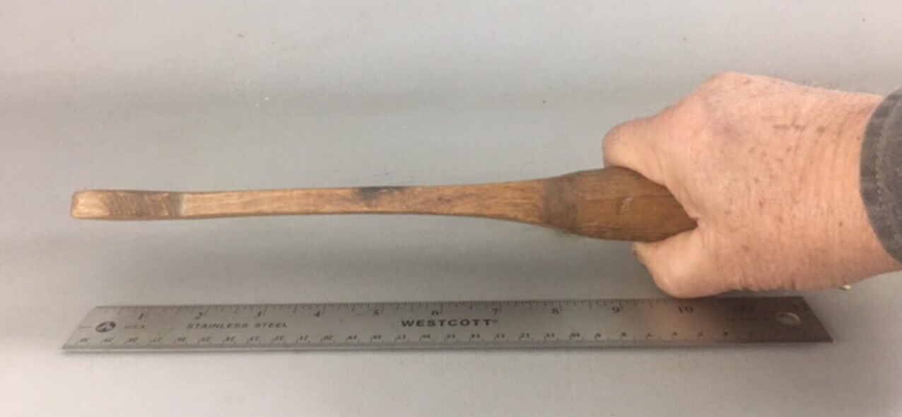

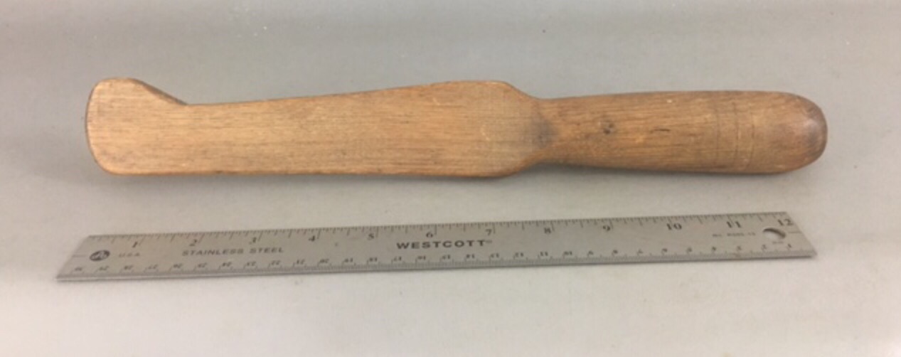

These are photos of what I believe might be a wooden coupling knife. There are no markings, and no indication that it has ever been used.
Bruce

In the mysterious prose, “He Was a RR Man,” the railroad man being interviewed is asked to explain how the Bishops Safety Coupling Knife is to be used, and he replies, “By sticking them in the left hand hip pocket with the blade turned up.”
I take that to refer to the general reluctance of trainmen to use such devices. The wooden knife or paddle shown in the above photo does appear to be unused. Its story might include the number of couplings it witnessed while safely tucked in the owner’s left pocket with the blade turned up.
Or its life may have included the assistance of many actual couplings, each done with such perfection that the knife was never pinched, and thus shows no sign of damage or wear. Trainmen were probably good at that because they had, out of necessity, cultivated the skill needed to retain their fingers, and so they may have naturally applied that diligence to the coupling paddles.
If a trainman were confronted by an official and asked to show his safety knife; and if it were damaged; it would make the case that such devices were necessary. That conclusion would please the official, but maybe not the trainman. On the other hand, presenting a pristine safety knife might be incriminating evidence that the tool had never been used, and was only slightly worn by being carried in the left hand pocket.
