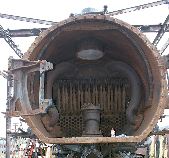

The locomotive has recently gone through a "boiler wash." About this, the WMSR Foundation site administrator said, "The boiler wash went very well! Very little scale came out and the boiler plugs still had grease on them. They came right out. That leads us to believe after only operating the locomotive for 7 years the C&O did a boiler wash before they retired the locomotive."

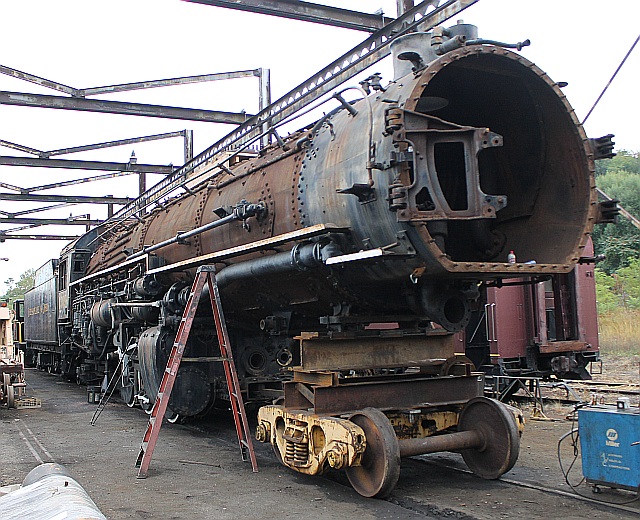

Right now, the #1309 is a very large 4-6-2....... The front engine is inside shop.

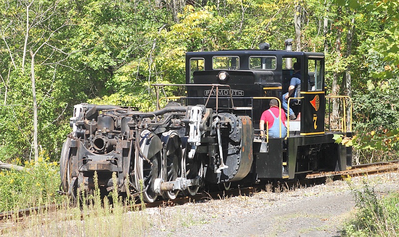

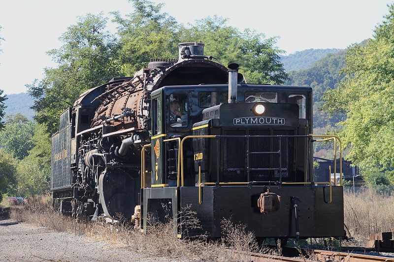

23 September 2014 - Crews took #1309 to the Wye at MD Junction to turn the locomotive in proper orientation for stripping the interior of the boiler.

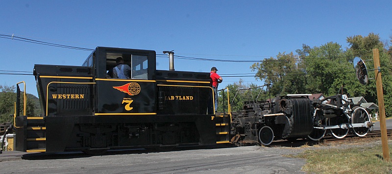

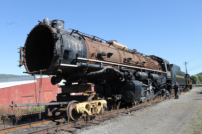

After the locomotive was turned, crews then turned the front engine. During the moves only one trailing truck bearing gave any concern.
