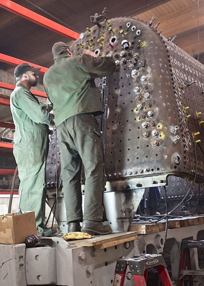

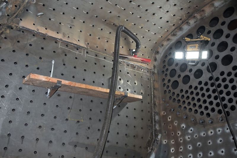

March is off to a good start with additional weld passes being done to bring the firebox seams closer to completion. Good progress is being made in fitting sleeves to allow an upgrade of some 400 rigid stays to flexible.
Other work includes the continuing overhaul of the locomotive brake valves and fitting the water and oil valves and piping onto the tender.

Nice work. Your images of this project are always a treat, and an inspiration.
Why are 400 rigid stays being changed to flexis?
 Post subject: Re: Alaska Railroad 2-8-0 #557 to be returned to service!
PostPosted: Thu Mar 10, 2016 3:24 am
Posts: 706
Location: Anchorage, Alaska
These locomotives only had a total of 16 flexies as delivered from BLW, etc. Reliability and low maintenance were goals as we made decisions when contemplating what we wanted our final product to be. When we decided that the firebox had to be replaced it necessitated that all the stays be replaced. After consultation with Robert Franzen, our boiler guru, we decided to convert a number of the rigids to flexies at the same time. This upgrade isn't unprecedented. One of the Ft. Eustis locomotives of the same design had a similar treatment when its boiler was overhauled in the early or mid-1950s.

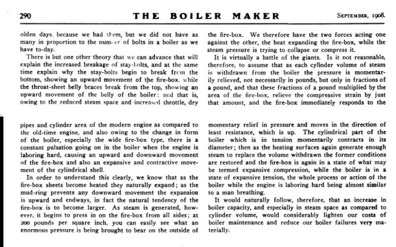

The importance was recognized back in 1908...

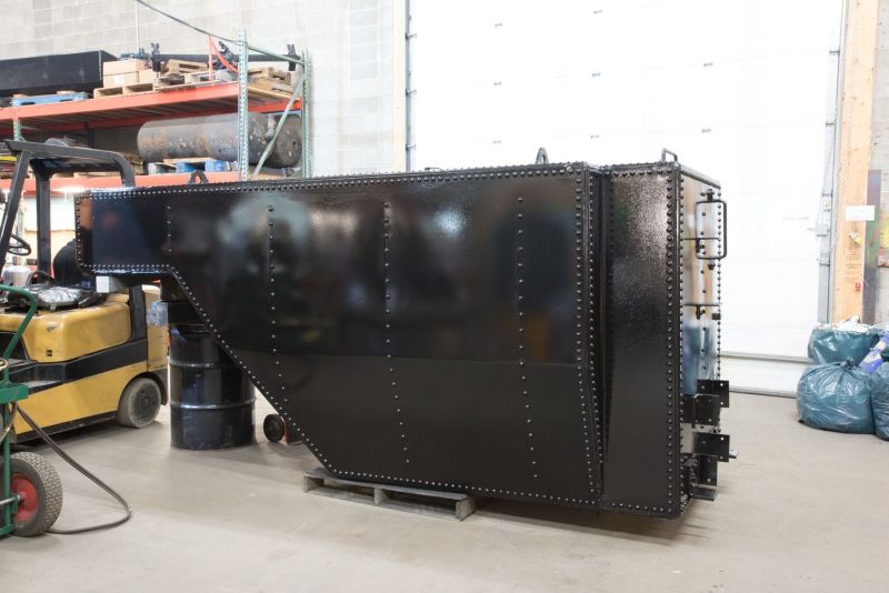

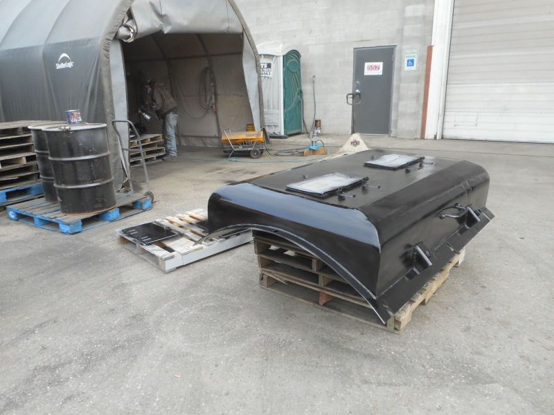

They say the way to eat an elephant is one bite at a time. Here are a couple more bites of ARR #557. The combined steam and sand dome casing and the fuel bunker have been cycled through the restoration process and are now back on the shelf and ready to be installed when their times come.
A new status report is posted at http://557.alaskarails.org/restore/prog ... index.html
