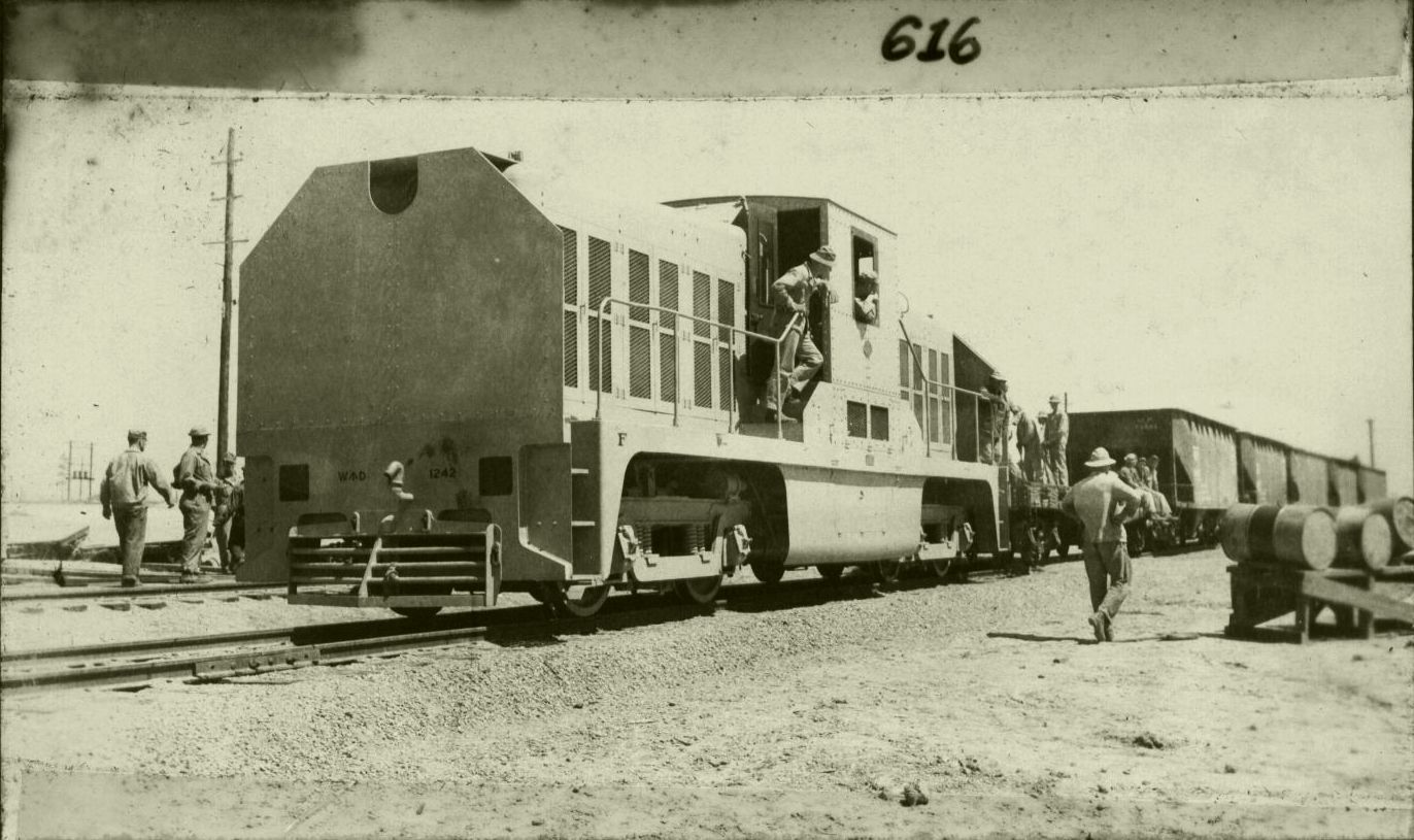

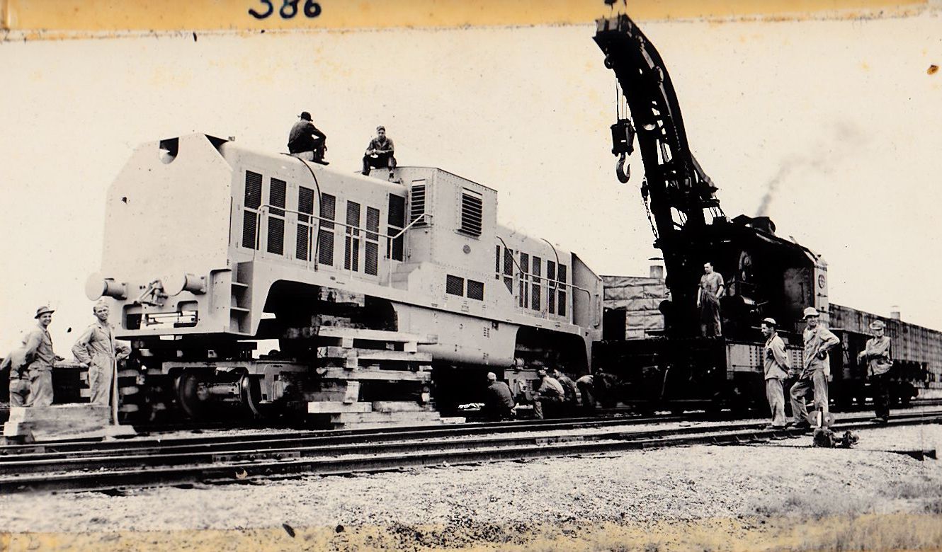

A few more from the Leatherwood Museum collection.

Thank you sooooo much ! Absolutely fantastic photographs and also the youtube video is only the second and by far the best quality footage of Whitcombs operating during WW II that I have ever seen.
Again, THANK YOU !

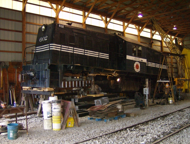

Great pictures. As soon as I saw the shot of the locomotive up on blocking, I was reminded of a similar view from 2010 when the front truck was removed for traction motor repairs.
Someday I hope to see your engine. Do you have any photographs of the Buda engines in it?
Any video of the engines running with the doors open?
Steve

http://www.youtube.com/watch?v=mT76qQtkEfo
The video was shot in 2008. Normally, 602 isn't used regularly, mostly due to the ease of the two GE centercabs on hand. Also, at this moment, another 970A traction motor needs to be repaired. 70 year old electrical equipment is problematic at best.
