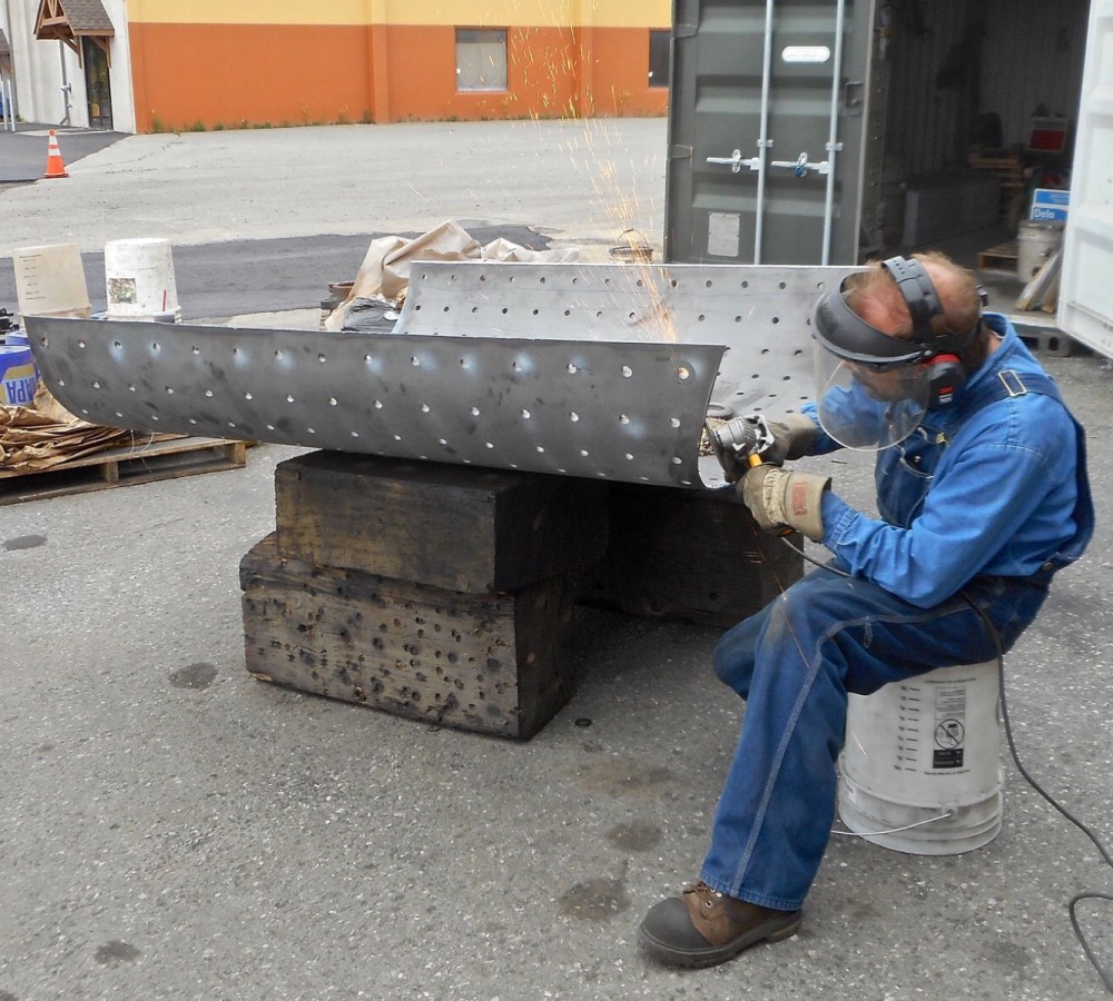

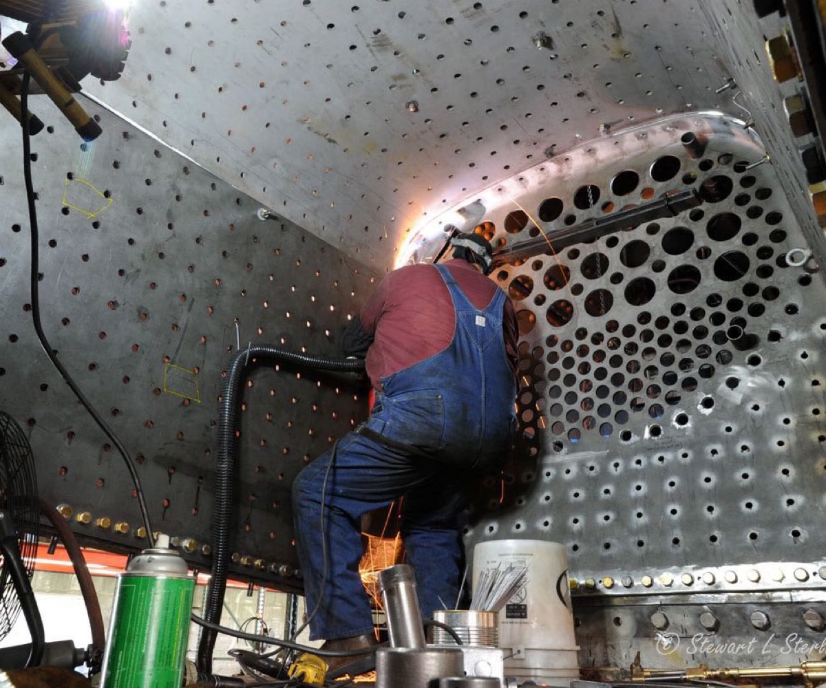

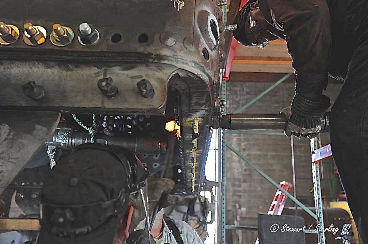

The June report concluded with our Professional Engineer, Robert Franzen of Steam Services of America and Gary Bensman working with our volunteers in preparation for riveting the new firebox sheets to the mud ring. After a break for the July 4th holiday we all returned to the job of final fitting the five sheets that make up the inner firebox. No small task, as a years worth of preparation allowed for the fitting to proceed, with all five sheets being brought into position for final trimming to fit. All 1043 stay bolt holes on the new sheets also had to align with the 1043 holes in the outer wrapper of the boiler.
After final fitting all five sheets were laid out to receive a 6 mill layer of Apexior 1 paint on the water side. This followed removing and trial fitting the sheets a multitude of times under direction of Robert Franzen and our CMO Jeff Debroeck. Art Chase from Fairbanks came down to work for three days with the crew and here puts the final touch on the angled edge of the crown sheet to allow for full penetration welding.
With all the sheets fitted and bolted to the mud ring, Gary Bensman is tack welding the sheets together. Note the temporary bolts in the crown sheet supporting it in position. As work progressed, the volunteers were constantly in the process of relocating work platforms for the work as visitor, Spencer Arntz caught in these photos.

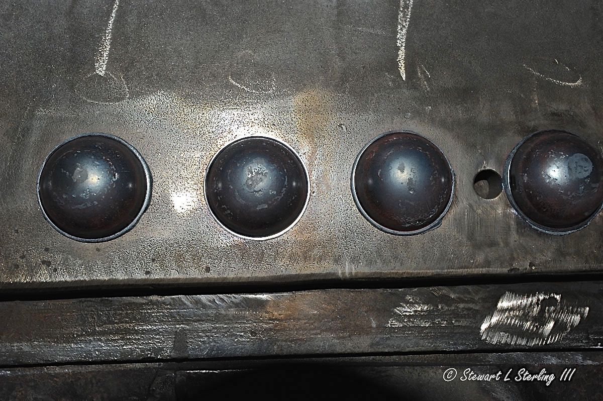

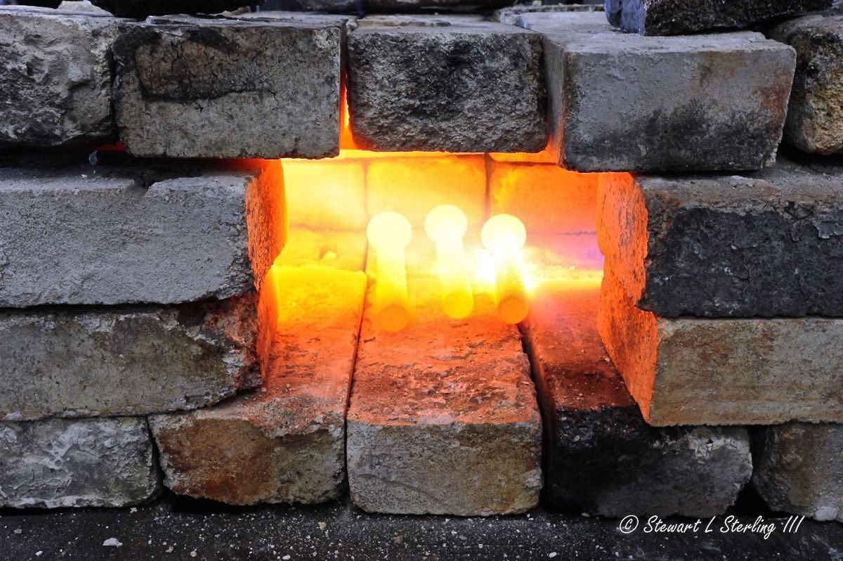

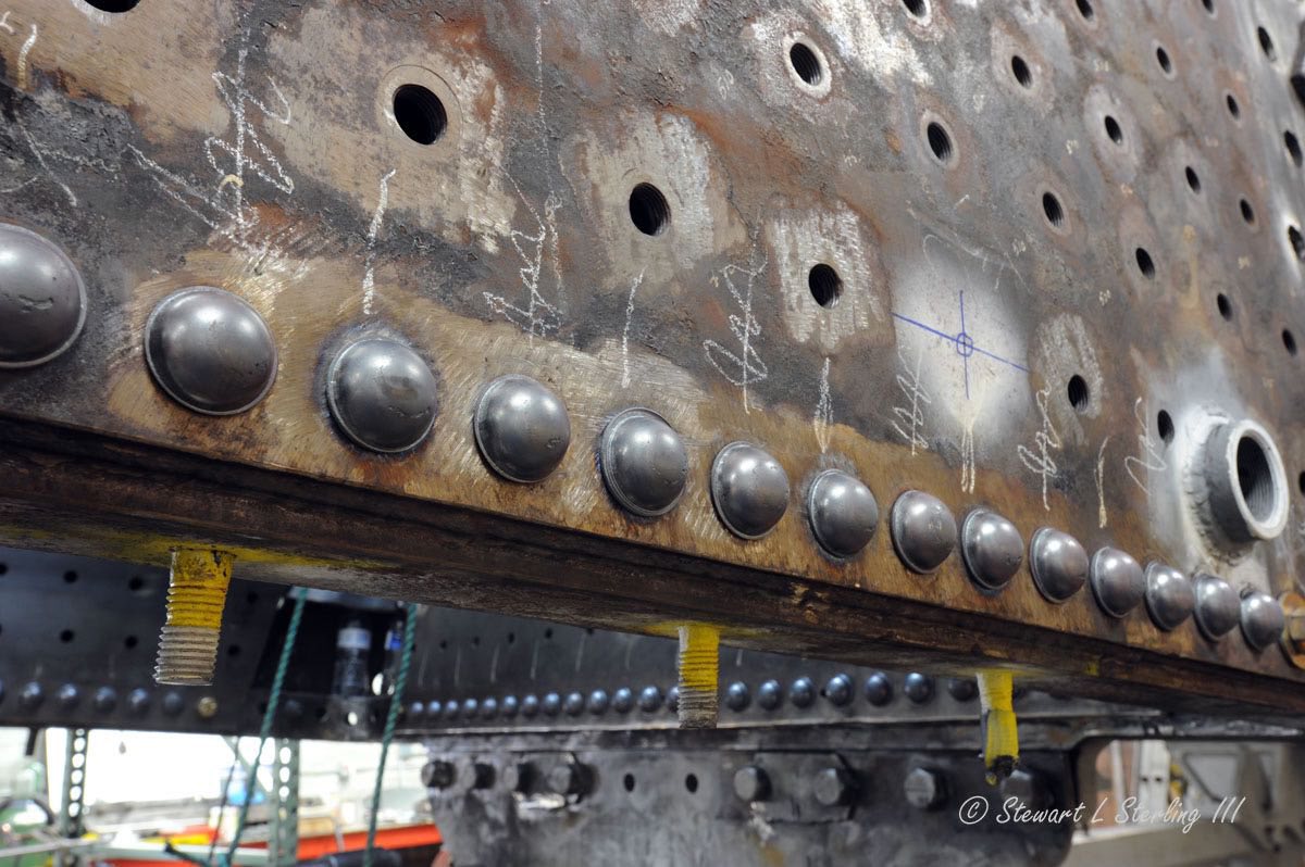

The big day came on July 11 when all was ready and the decision was made to install the mud ring rivets and secure the new sheets. Nine volunteers were on hand to support our contracted helpers. First step was determining the required length of the rivets and Ron Dudley cut them on the band saw and used the arbor mounted wire brush to remove surface rust. A firebrick oven fired by propane was set up to preheat the rivets. Stewart Sterling made sure there was a ready stock of rivets in preheat and passed them off to the next station. Heated rivets were moved to the forge oven for final heat, attended by Mike McKervey and Art Chase.

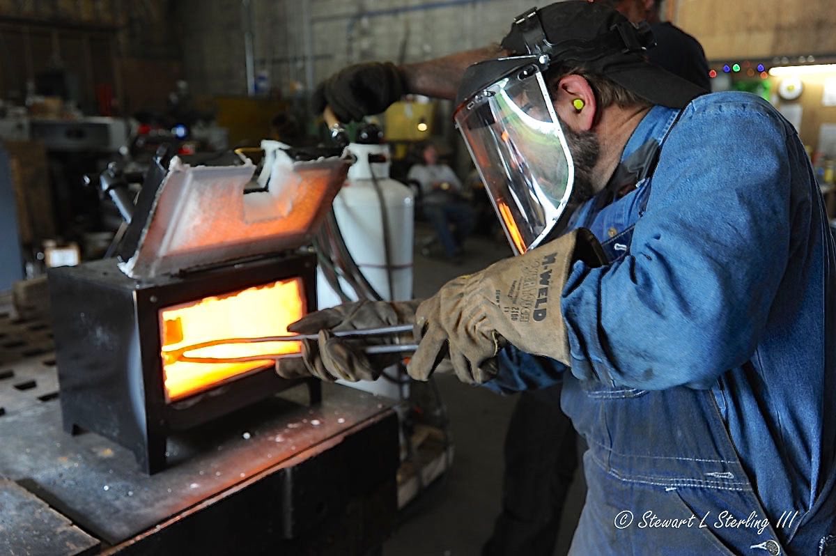

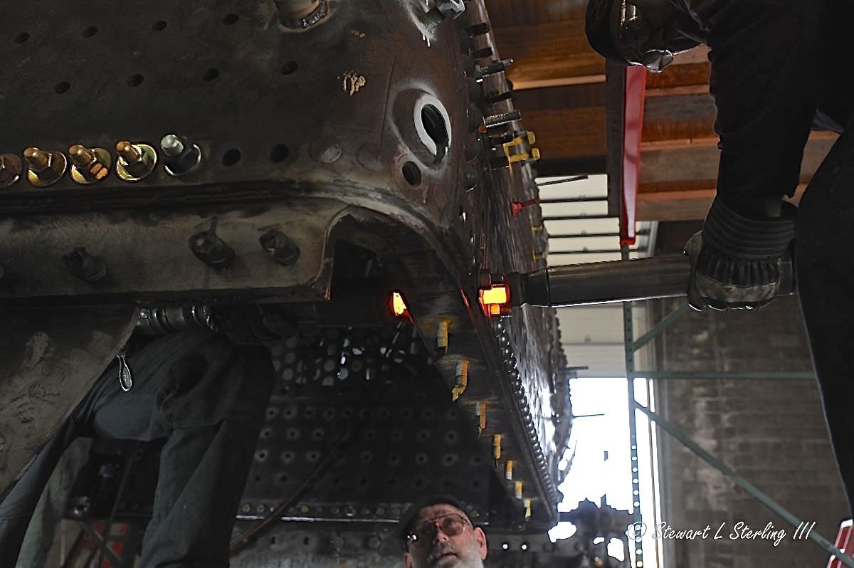

Soon a well choreographed process was in place. Jerry Cunnington would remove the next bolt to be replaced by a rivet. The hole was then flushed with a hot torch to burn and blow out any possible contaminants. Art used tongs to move the hot rivets from the forge and insert them into the cleanly prepared hole in the mud ring. Jeff Debroeck and Dean Sawyer managed the air operated bucking bar inside the firebox. Gary Bensman would then use the air hammer and set the rivet on the outside sheet forming the head. The right side of the mud ring showing the mud ring rivets and head detail.

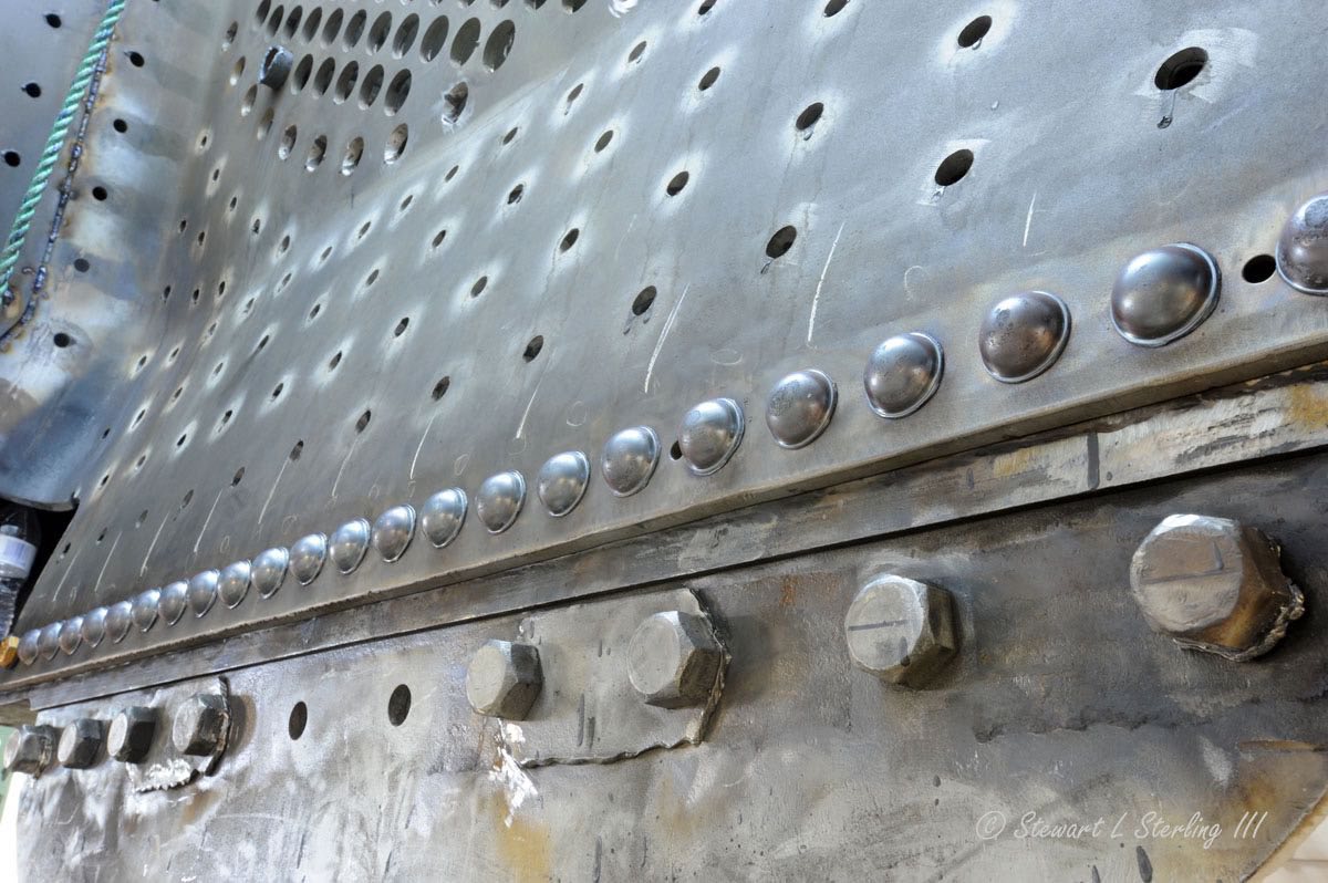

The throat sheet rivets at the bottom of the rear flue sheet exemplify the quality of the job performed. The crew started at about two in the afternoon and finished about eight pm. The rivet crew at the end of a 12 hour day were still ready to go. Those pictured left to right are: Stewart Sterling, Gary Bensman, Ron Dudley, Mike McKervey, Art Chase, Robert Franzen, Ken Morton, Jeff Debroeck, Patrick Durand, Dean Sawyer and Jerry Cunnington. During the 23 days of June and July that we had professionals working the volunteers came in 7 days a week and 17 individuals worked 1,142 volunteer hours. In addition to those named above were, Ken Elmore, Jerry Christensen, Casey Durand, Lynn Willis, Jim Keene, Gary Eddings, and Rus Rudolph.
August 18th is the three year anniversary of Engine 557 Restoration Company beginning work on Alaska Railroads last operational steam engine. After a complete tear down to the bare frame and boiler, evident wear, damage and failures have been discovered and are being addressed. Many major components have been remanufactured, the 57” drivers, air compressor, power reverse, and many electrical components are ready for installation. New tubes and flues have been delivered.
In review, replacing the firebox interior was a $400.000 unexpected expense and set the project back by a year. Our professional engineer, Robert Franzen of Steam Services of America produced the new flue and door sheets and SteelFab provided the crown and side sheets. We have turned the corner to reassembly of 557 and I estimate the project is now 55 percent complete.
File comment: Robert n Gary

File comment: Easy bake....
File comment: The process

File comment: The rivet heads!
File comment: Rivet details

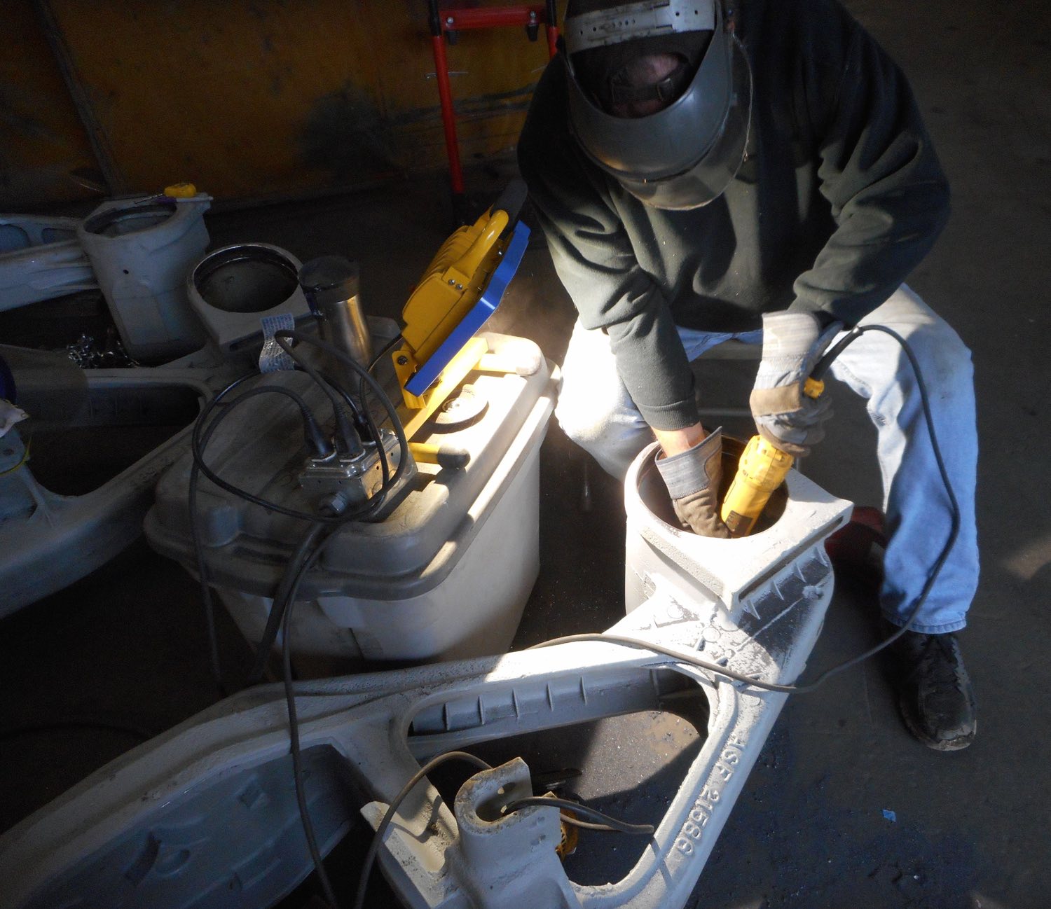

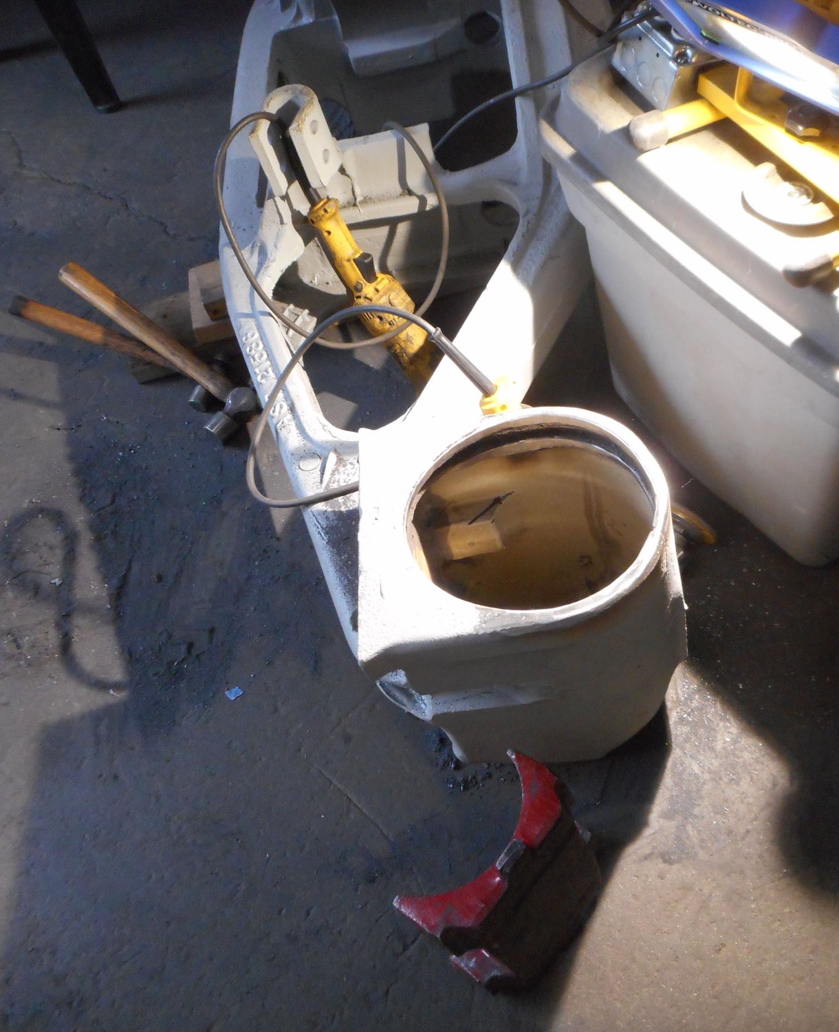

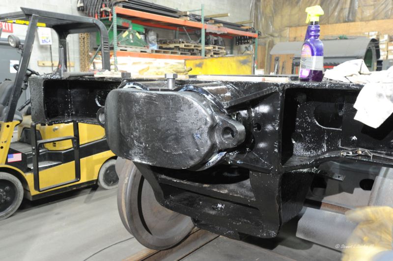

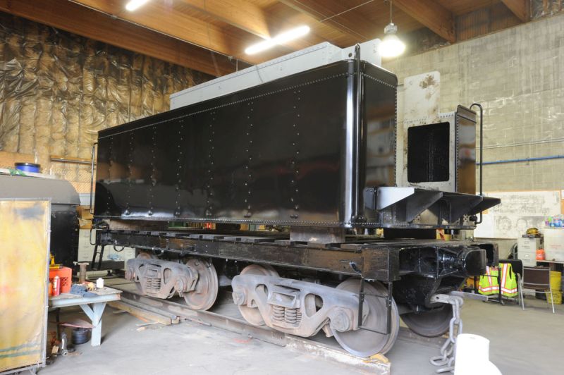

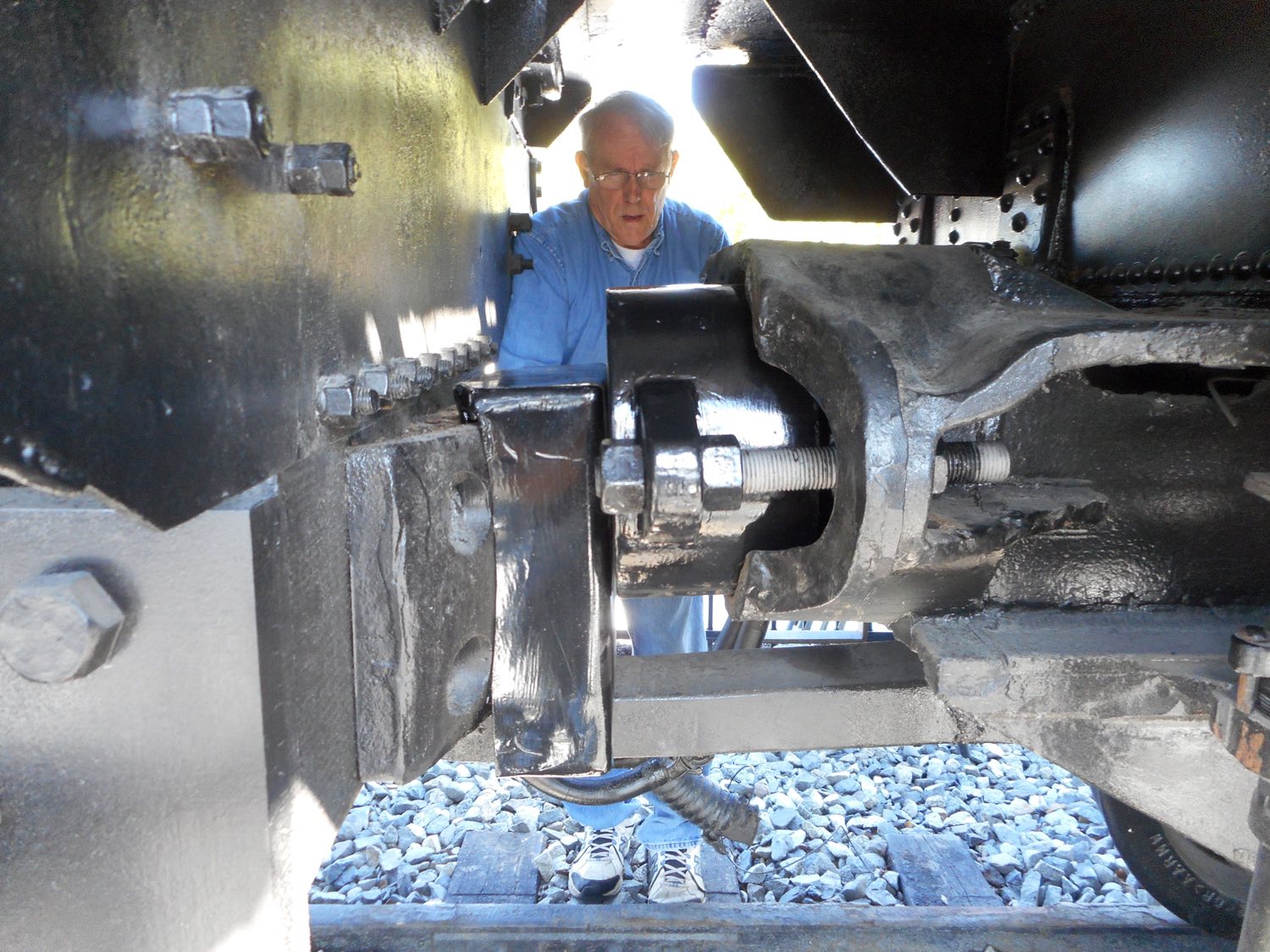

While the weather was good, a lot of work was accomplished on the tender.
File comment: Dick and our favorite bolster....
File comment: Side frames
File comment: Trucks have been modified for roller bearings while keeping the cosmetic appearance of the original.

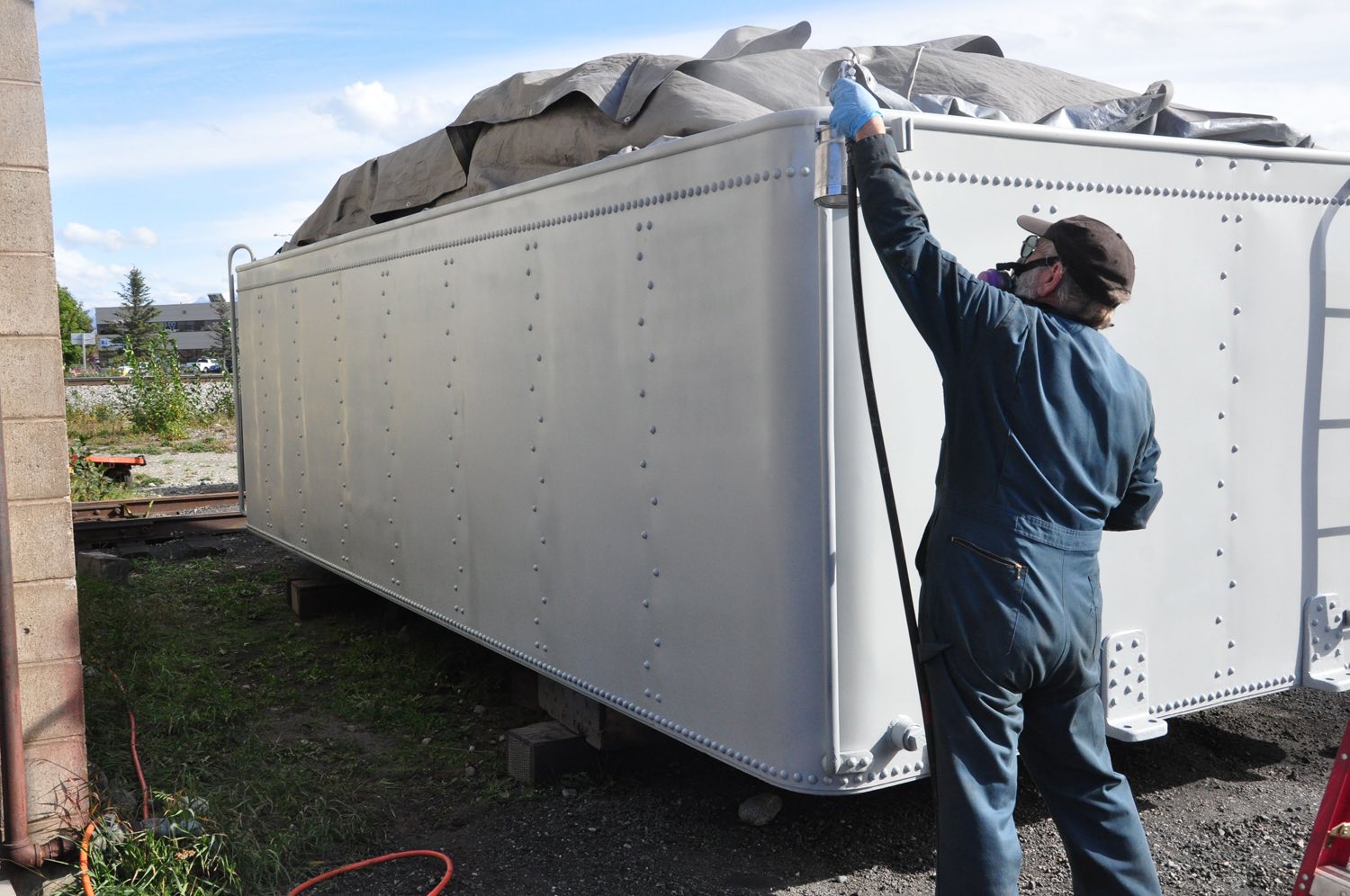

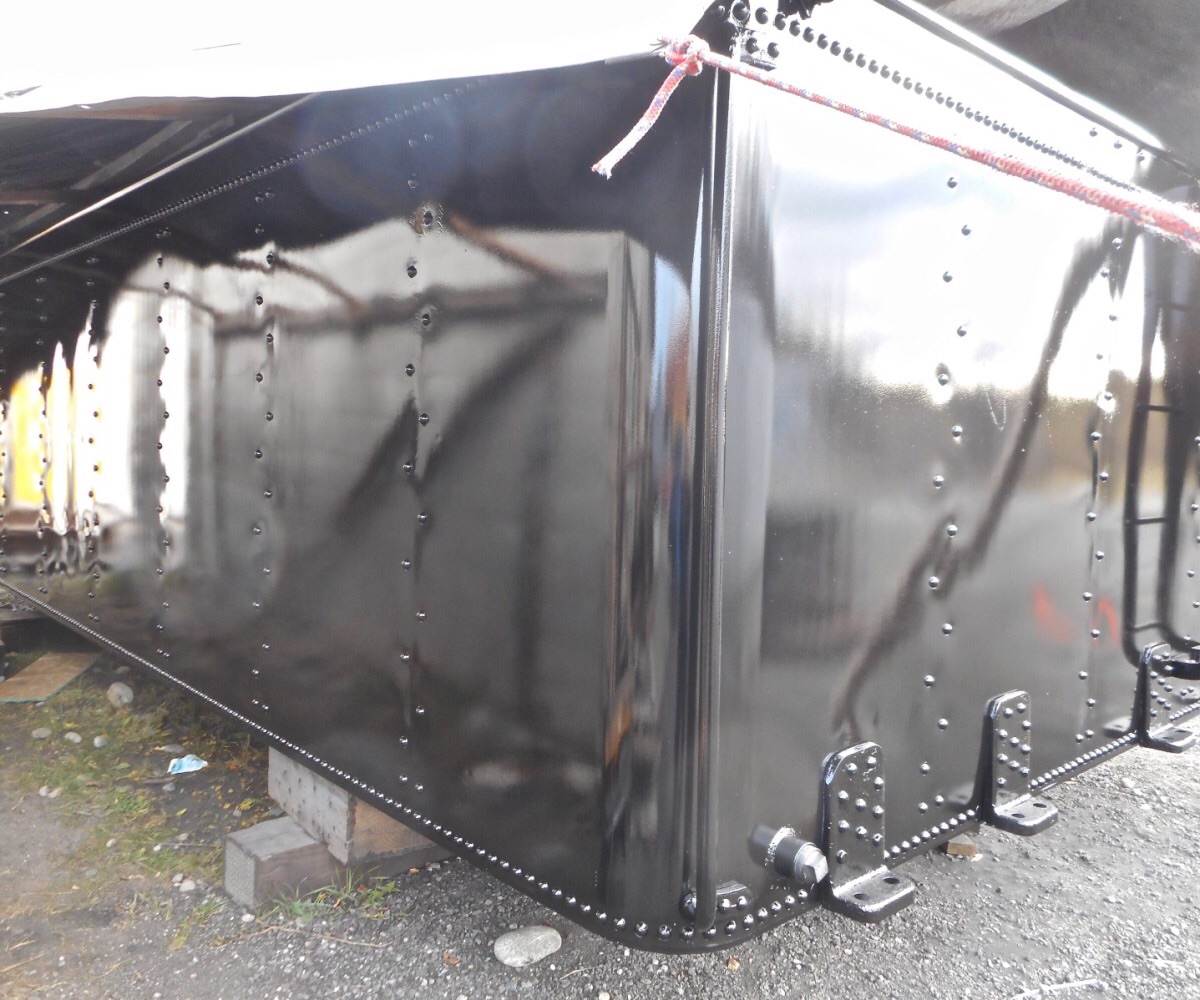

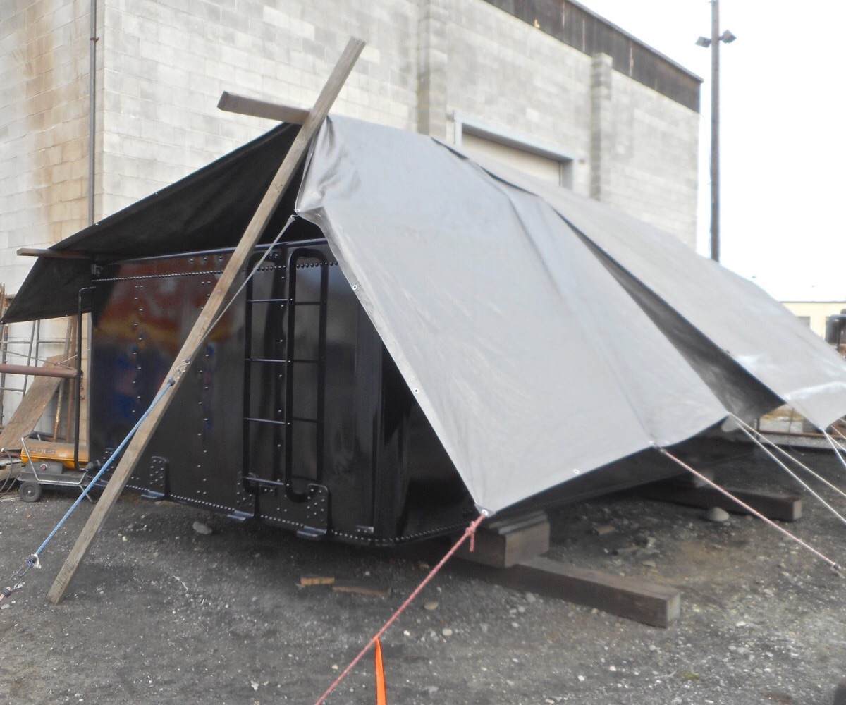

More tender details.
File comment: The rain snuck up, but....
File comment: Final pre-coat is applied.
