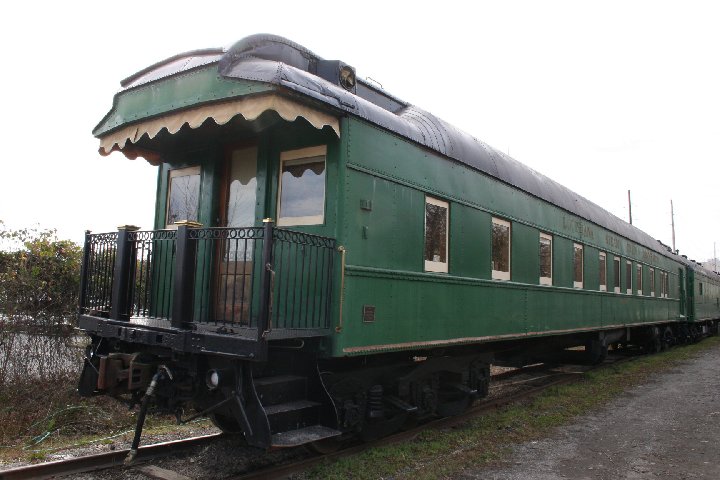

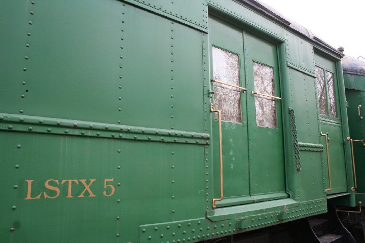

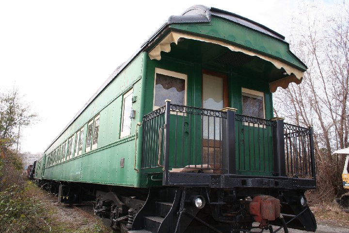

148. Central House (Lot #4886, Plan #3959, 1925, 3C-2DR-lng-obs)--sold to US Government and converted to hospital ward car (1943) to LASTA and converted to hospitality car as LSTX #5 Jefferson--according to the LASTA website, this car carried the name Azalea while serving as a hospital ward car.
Here is a current set of photographs for this car taken January 2014... I recall 30 years ago seeing this car in Hialeah Florida abandoned ( or so it looked ) painted orange and silver and named "Azalea"... It is likely this name was on the car after its service ended and was in some type of private ownership.
Photographs were taken outside of New Orleans, La
Dean Levin

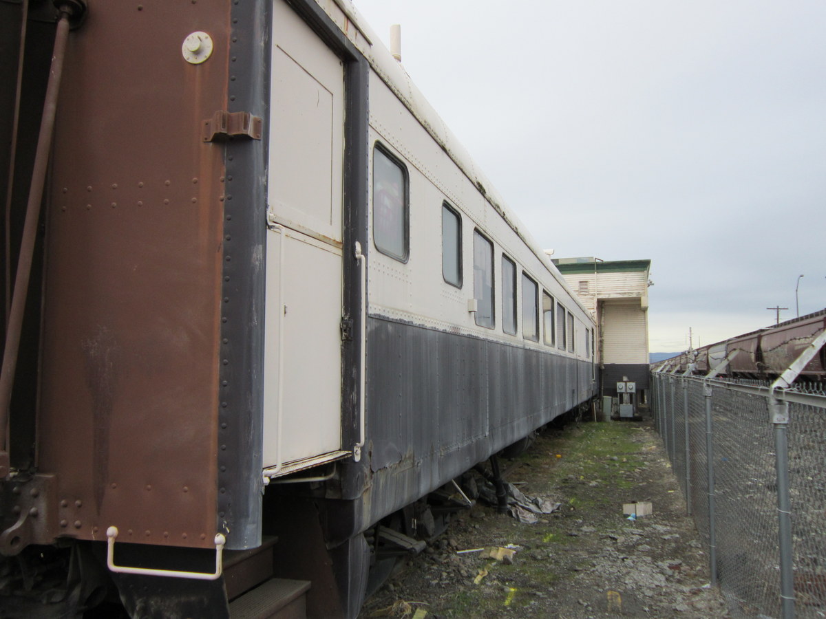

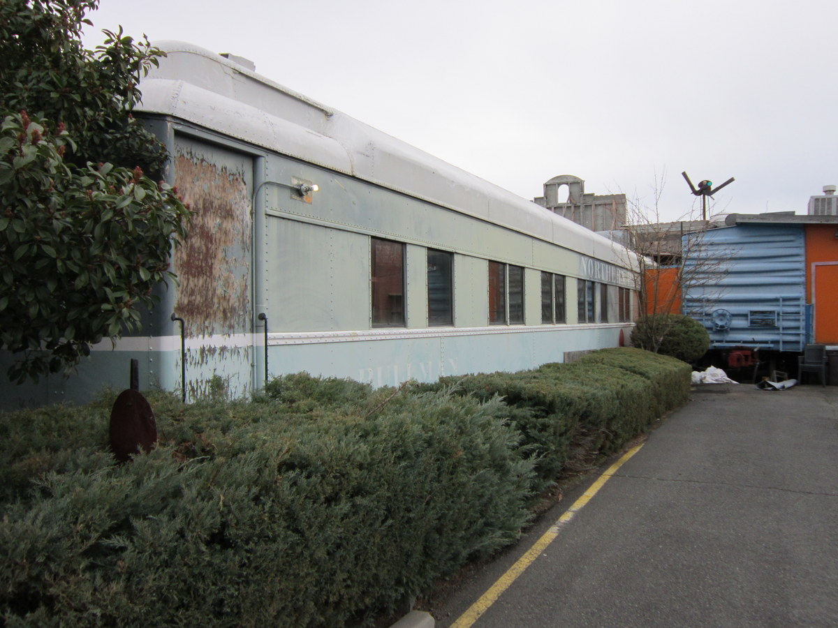

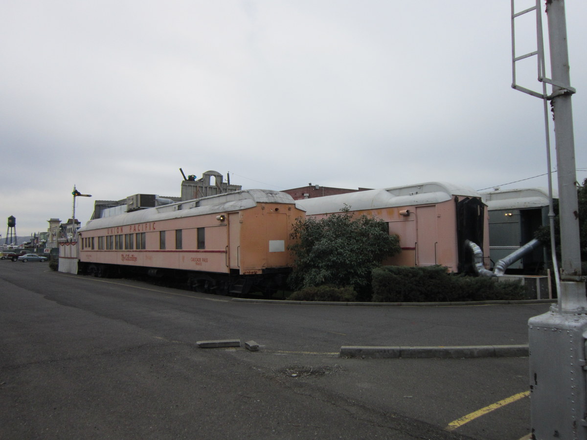

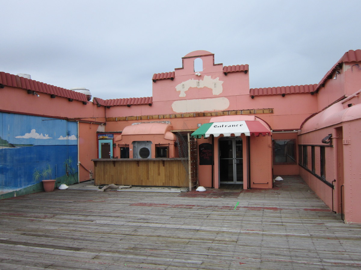

Well, lets see if this helps at all. These two pictures are an overview of the heavyweights in the restaurant.
File comment: View of all three cars from the rear of the restaurant. The Cascade Pass in the foreground.
File comment: This is the front view of the restaurant.
 Post subject: Re: Surviving Pullman Heavyweight Sleeping Cars
PostPosted: Sun Feb 09, 2014 9:15 pm
Posts: 473

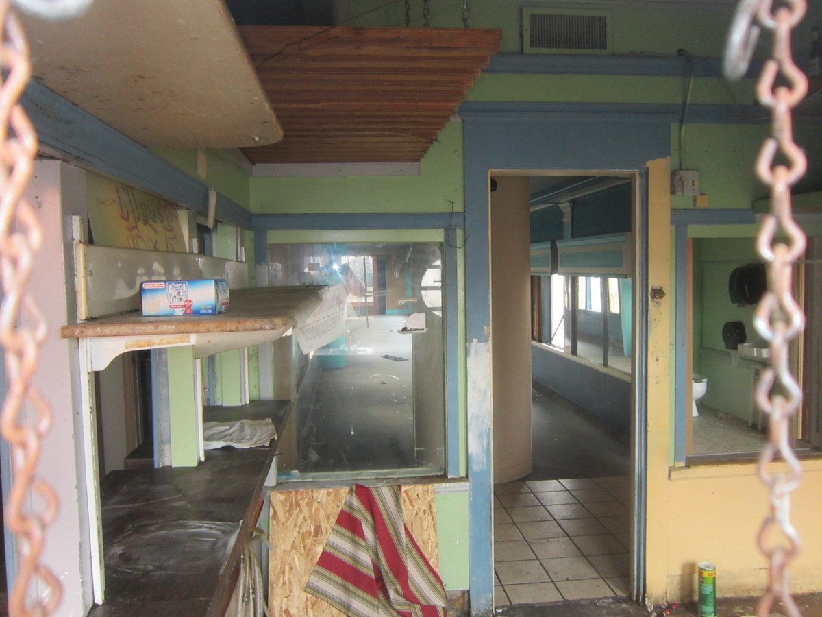

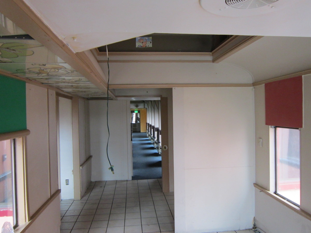

Next up we have a few of the Obs car from behind the restaurant facade. I'm guessing either the Colonial or Columbian.
File comment: An interior shot through the locked end door.
File comment: The north side of the obs car.
File comment: The south side of the obs car.

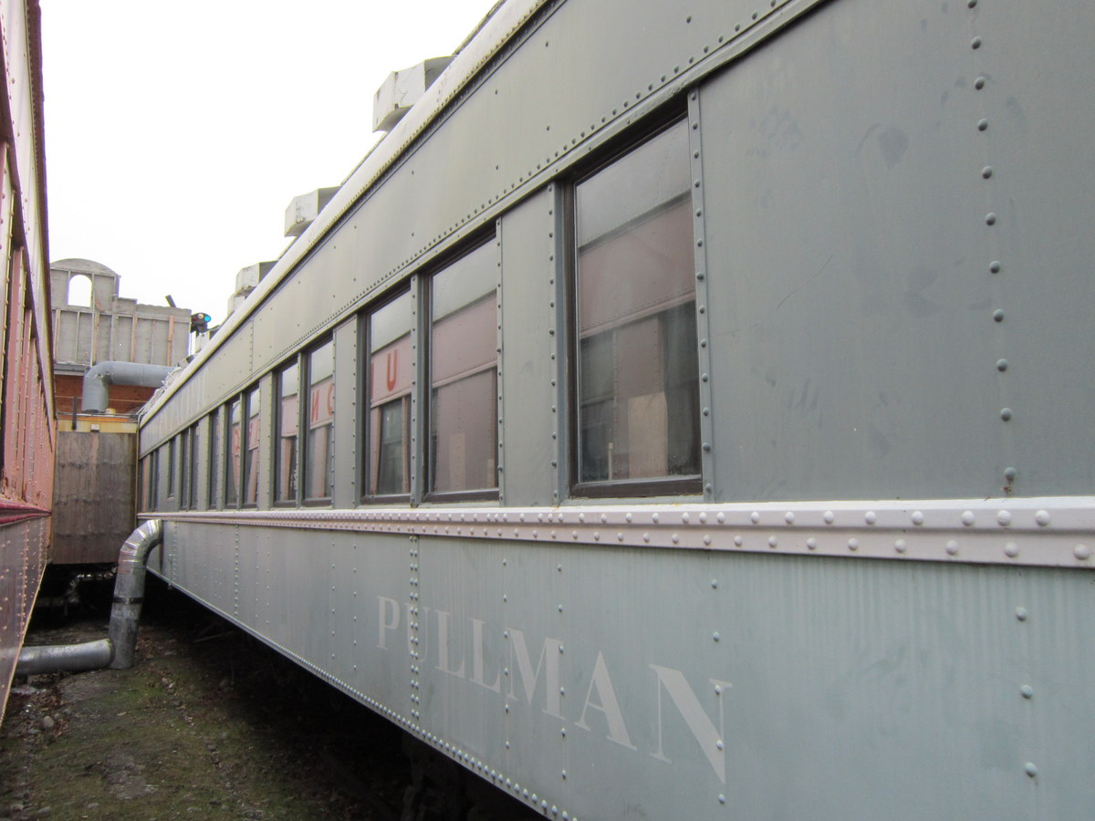

PostPosted: Sun Feb 09, 2014 9:23 pm
Posts: 473

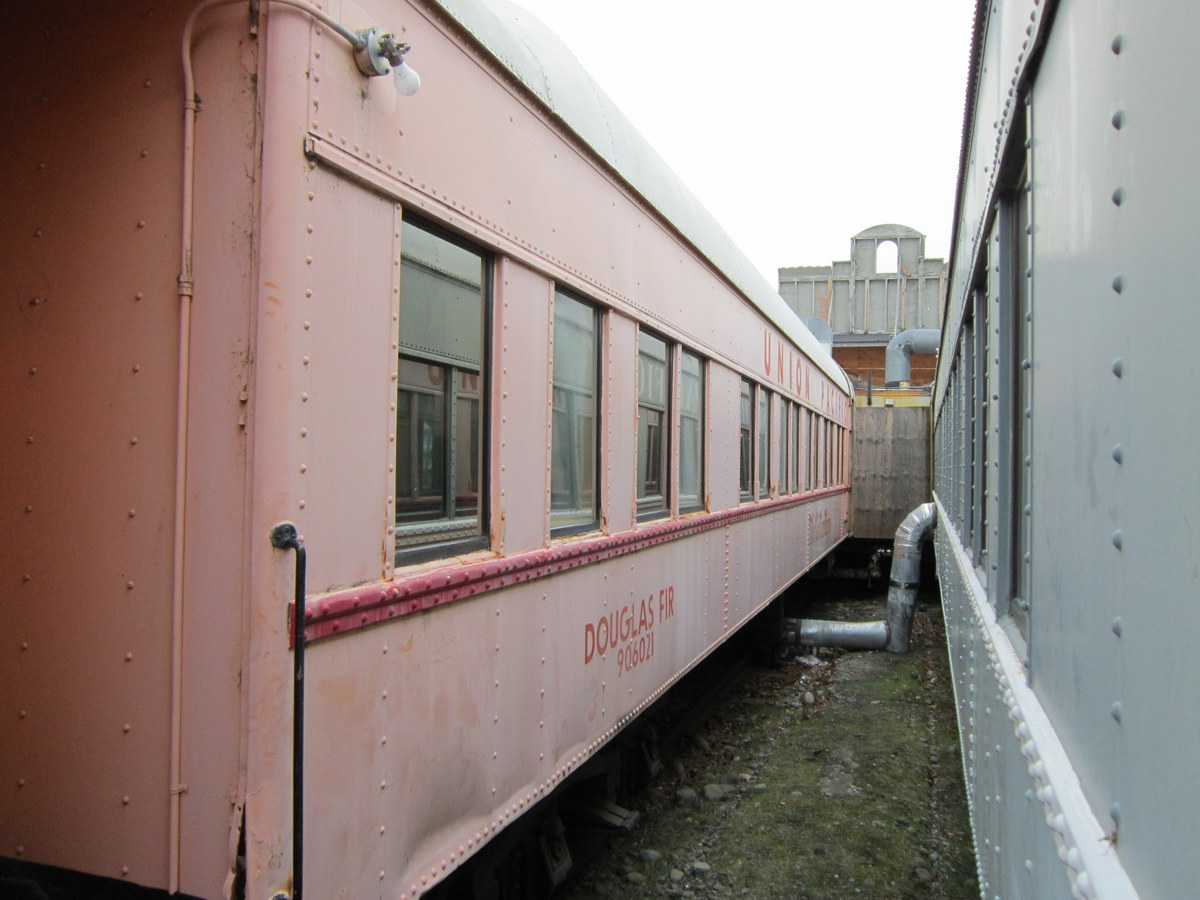

A few more.
File comment: One of the two day care cars.
File comment: The interior of the Cascade Pass.
File comment: The middle car, the Douglas Fir.

Thanks, ETA, for posting the Yakima photos!
Comparing the hallway-side window arrangement of the ex-NP solarium (photo #4) in Yakima with that of the Strates Shows Palm Lane (line item #89), I am fairly certain that the Yakima Car is indeed the Palm Point.
86. Palm Point (Lot #6337, Plan #3975X, 1930, 3C-2DR-buf-sol-lng-obs)--sold to NP (1948) to Track 29 (Yakima, WA)--likely scrapped Fall 2013 with ex-UP 12-1 Pelham (line item #83) and ex-UP 10-1-1 Douglas Fir (line item #78)
Comparison photo: Palm Lane at the NY State Fairgrounds: http://rrpicturearchives.net/showPicture.aspx?id=220731 (Scott Schroeder photo)
