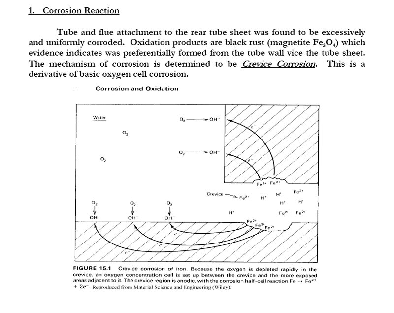

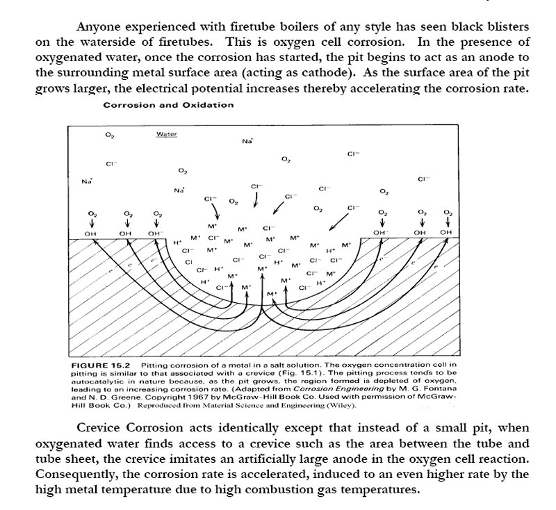

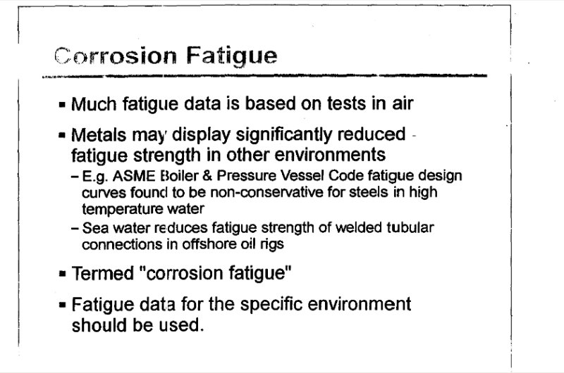

Posts: 488
PMC wrote:
Robby Peartree wrote:
....... the staybolts tend to corrode in the gap between the staybolt and the metal of the boiler shell. Am I correct?
Absolutely.
Page 14
