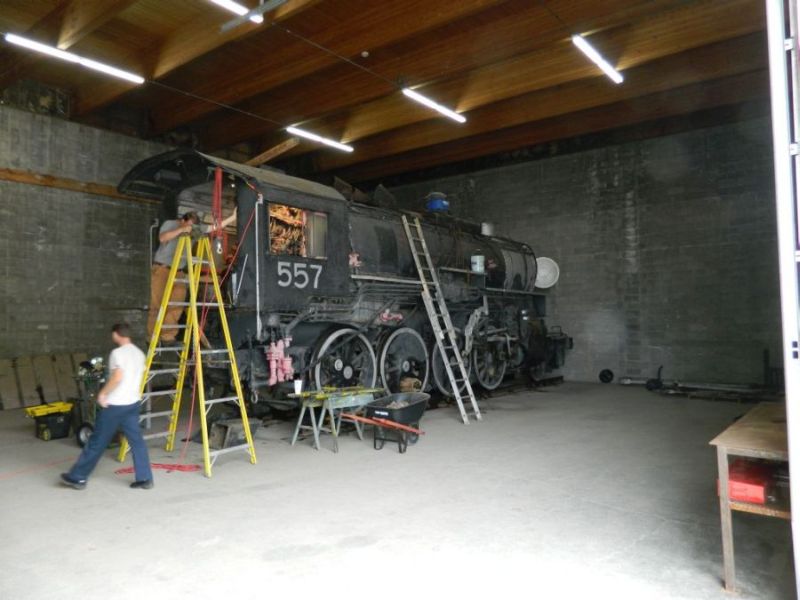

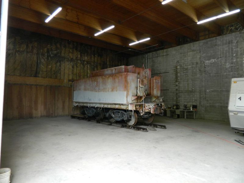

We apparently neglected posting the photos of 557 when she first arrived. These show the newly designated "engine house" on the first Saturday after 557 arrived in Wasilla in August, 2012.

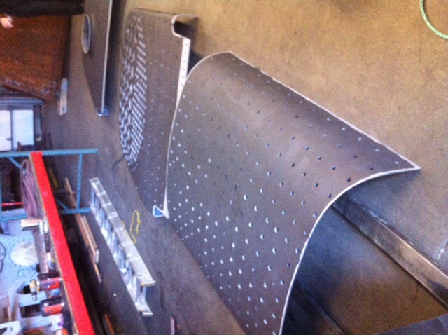

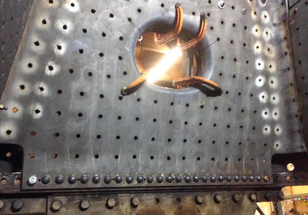

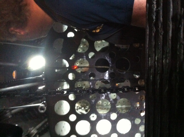

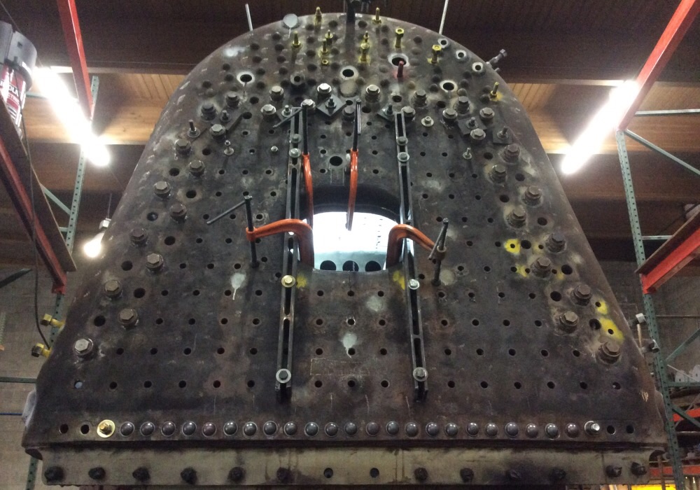

Just thought some might be interested in the detail photos and seeing the ongoing work on 557. These shots were taken randomly while we worked on the fire box and mud ring. All in all, a lot of work was accomplished over the last few weeks with sometimes limited resources... ( mostly crews! due to the limited summer season when all the other Alaska work gets done.)
Hats off and a very big thank you goes out to Robert and Gary for their technical advice, back breaking help and patients with us as we tried to get all the things done. Hope they enjoyed Alaska during a nice break in the weather, the misqitto's and the lack of darkness. We used them all to our advantage.

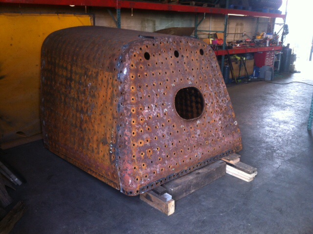

File comment: The old firebox, we have saved and will be used for education purposes. We used this for references as we checked and rechecked our progress. ( this was also my home for the first year... Thanks Jeff!!)
File comment: The crown, flue and door sheets laid out the morning of installation after being prepped, tweaked and treated for installation.
File comment: Jeff, (Robert inside the firebox) from the barrel side of the flue sheet.

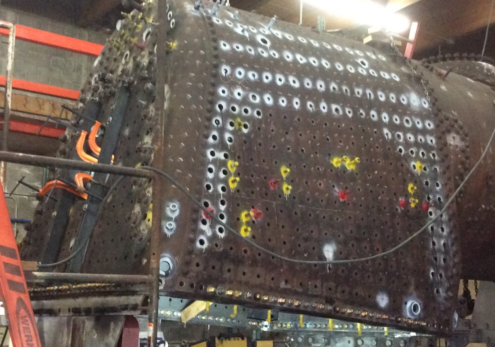

Some additional details photos.

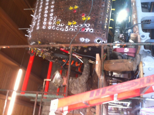

File comment: Ron is doing some welding on the back head.
File comment: Almost looks like Pac Man had been here.... The color coding was to help identify the need for each stay, or required repair work.
File comment: Back head where many of the new flexy stays will be installed. This is due in large part to experience gained from operation and design. They tended to see more stress and broke most often...flexies will help cure that.

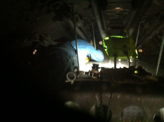

Luckily Jeff was there to pull my butt out of the crown sheet area when we needed to reposition I-bolts!
Stay tuned!

File comment: From inside the fire box you can see the prescision alignment of the door to the wrapper.
