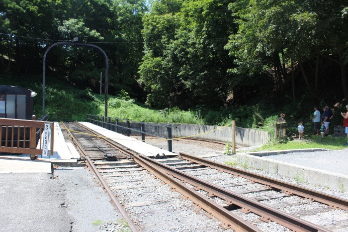

My suggestion was to figure out what the maximum vertical curve that 1309 can take and then shim the rails of the turntable to crown them to that radius. That would reduce the angle at the turntable's edge and tweaking the track over the road crossing should take car of the rest.
As Rick Rowlands brilliantly proposed, a vertical curve on the turntable might solve the problem. I would be uncomfortable seeing that used without a clamping chock, added while the turning movement occurs, in case there was any imperfection of balance and bleed of brakes.

Probably an inch or more can be removed by progressively dapping the table timbers toward the end of the table, lowering the bottom of the rails slightly below the surface of the ties. Then cut out the 131 RE approach rails, comping down to 100 RA at the edge of the crossing which would lower the height of the approaches by 1 inch at the turntable's edge. That would in effect introduce a vertical curve between the 3 percent grade at the crossing and the edge of the turntable. Couple that with the dapping of the turntable ties and the slight crown to the turntable rails and I think we could almost completely eliminate the sharp angle at the edge of the table. This could be done with a crew in just a few days. Replacing the approach rails would take a day, pulling the table rails, dapping the ties and respiking the rails probably three days.

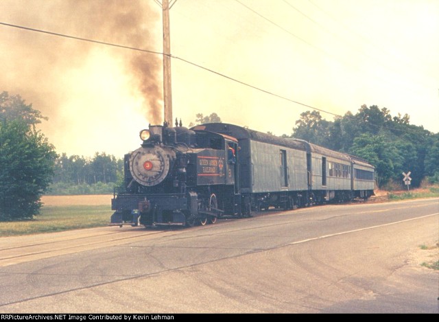

At QARR, we needed more water to run a longer distance (18 miles round trip, plus another 5 miles+ for switching), so used the baggage car as a tender. The baggage car housed a HEP diesel genset (for our dinner train), our tools/workshop, and several old fuel oil tanks used for home heating. We cleaned out the tanks, piped them together with PVC pipe, and hooked hoses to the loco. The tanks were filled with a hose through the end door. The Wilmington & Western already had piped the engine for a tender, as they regularly used a tender with it. We ran forward using the "tender", and then ran around the train and used the engine tanks running backwards. We doubled the water capacity of the engine for about $100 and a few trips begging for scrap tanks and a trip to the hardware store.
Problem solved.....ditch the tender when running backwards............

"What we know is what Baldwin Locomotive says the locomotive can do as far as going around curves," said Garner. "The curve at Frostburg, that's the final curve into the (Frostburg) station that goes into the turntable; it's 22.5 degrees and our locomotive is only rated at 22 degrees. We are not 100 percent sure it can go around that curve and get to the turntable."

The information I was given during the 2018 audit was from Gary B., who had measured the vertical tolerances on the front engine vs. the vertical curve going into the turntable, and was concerned enough to recommend not turning it. The secondary concern was shifting the locomotive weight teetering almost entirely on the lead set of drivers on the second engine during that move, something it was not intended to do. So this isn't sidewalk superintendent, it's the guy that did the rebuilding. Like I said, I have to respect that.
I do think there's a lot of possible alternatives here. And no, 734 was flexible enough to regularly mount on and off the table without much complaint. Did it all the time.
At some point they'll probably actually test 1309 away from prying eyes here and see how it reacts, and that will settle the debate, but it's still a pretty ugly looking kinked curve with a vertical drop at the top. It's an odd railroad, split between the epic engineering of WM with the 1880's C&P stuck at the top into Frostburg.

Two crossovers could be added. After the disembarkation, the engine shoves back to clear the x-over. Then it gets onto the parallel track. At some point, there is a new switch and a third track headed to the turntable... Yes, it will be nasty with changing the road crossing...but I have heard that is a way to reduce the horizontal approach curve. Then the gradient can be changed for the vertical curve. After the engine is turned, it returns to the parallel track and depending on how far away the start of the siding is, another x-over could be installed. In any case a diesel rear helper could also be run-around the train at the same time.... but you could do this with a single engine and crew.
Just leave existing track as it is....don't mess with it. I don't like the idea of shimming and making the turntable not level...It would wear unevenly. The last thing that anyone should do is to make equipment perform at something that the are not designed to do.
