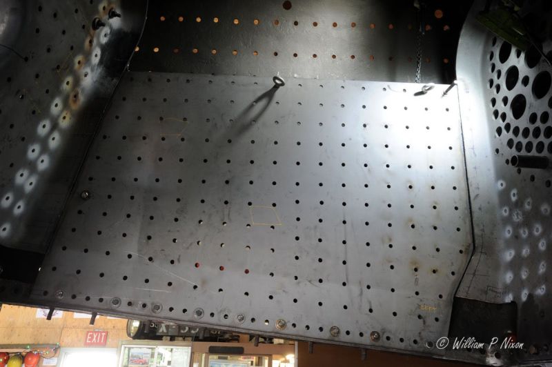

June was a productive month and a new report has been posted at http://557.alaskarails.org/restore/index.html to show what we have been up to. Among the accomplishments is the progress in fitting the fire box as shown in the photo below. Robert Franzen of Steam Services of America has been on-site for the last week overseeing the firebox installation and will return for another week after the Independence Day holiday.

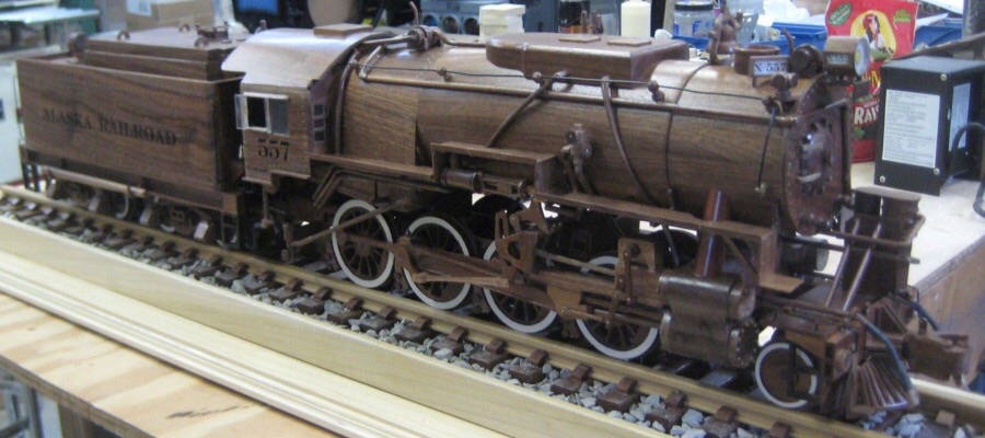

So not exactly preservation, but give a great idea of what 557 will be looking like soon. Brian Gray of Cambridge, Ohio has completed this 1:18th scale replica of 557. The model is completed in wood and is a tribute to his father who was an engineer on 557 around 1949.
Well done, well done indeed.

 Post subject: Re: Alaska Railroad 2-8-0 #557 to be returned to service!
PostPosted: Sun Jul 05, 2015 10:09 am
Posts: 969
Hard not to comment on both pictures of the model and the firebox. Both are wonderful examples of workmanship and craft. I can truly appreciate great modeling for what it is, but the firebox picture makes me all warm and fuzzy. Hope for some more detailed pictures of the crown sheet work if possible. Seems the locomotive has a solid plan with all the right crew making it happen. Congrats on the continued progress. And the great example of the model. Think the crews working on the #557 would appreciate it too. Regards, John.

PostPosted: Sun Jul 05, 2015 5:55 pm
Posts: 4778
That is one beautiful model. It is a true tribute to the builder's father.

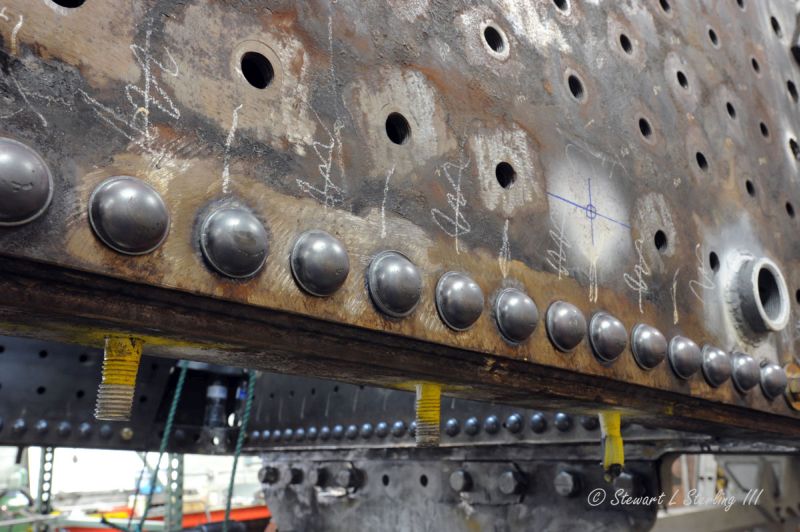

The boiler makers will be returning tonight and Tuesday night for another marathon week of firebox installation. Additional work was done after the photo above. I don't have a photo, but when they left last week, the crown sheet was also mostly fitted and mud ring rivets were reamed. The firebox will be removed at least one more time so that the bevels for the welds can be ground and to give the water side a coat of Apexior paint.

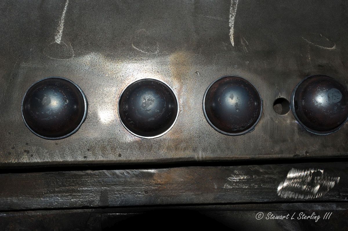

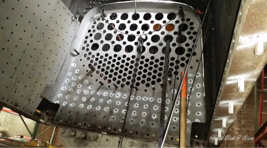

John, here are a few more shots from last week. We did indeed get the mud ring reamed and the sheets have been fitted, removed and as Dick said getting ready for final work. Everyone took the weekend off for a good rest. ( and a little train chasing!) Next week we are tackling the firebox and all the things needed to make it complete. Here are a few of William Nixon's photos and when we finish up next week I'll add some addition detail shots from my pictures. Promise they won't be covered in grime and dust!
As Dick has pointed out, the volunteers and support have been the key to this engine restoration. Pat Durrand for his leadership, Dick Morris, Jeff DeBroeck, Ron, Terry, Stewart, Jim, Lynn, Dean, Mike...and I know I am forgetting to many, have made this all happen. A special thanks go to Robert Franzen and Gary Bensman for their technical service... This has been one amazing rebuild!
PostPosted: Mon Jul 06, 2015 10:52 am
Posts: 969
Thank you so much for additional photos. Have worked with one of your contractors a few times and seen the incredible workmanship and fitting on mud ring repairs, side/throat sheet and barrel repairs ect. But have never been involved with the crown sheet replacement yet. in a previous life I was a welder and worked with some fitters who were very good. For me to watch boiler makers custom fit these parts into a compliant and safe firebox/boiler is truly a work of art. The odd shapes and bends, occasionally compound bends and shapes as in a throat sheet that was not punched out but custom formed puts me in awe. That boiler plate can be some snotty stuff to work with. And then have your predrilled holes line up properly.......outstanding workmanship and engineering.
I do know if you do this kind of thing for a living and do this kind of thing somewhat regularly it is not really "magic", it is kind of a "what I do" kind of skill. But not that many people are this good. Tip of the hat to you all. Again another example of "how to go about it" verses the "I have a dream" approach all figured out on a placemat at the restaurant. Not to say a few dreams have not came to completion with the original idea on a placemat! Best regards, John.

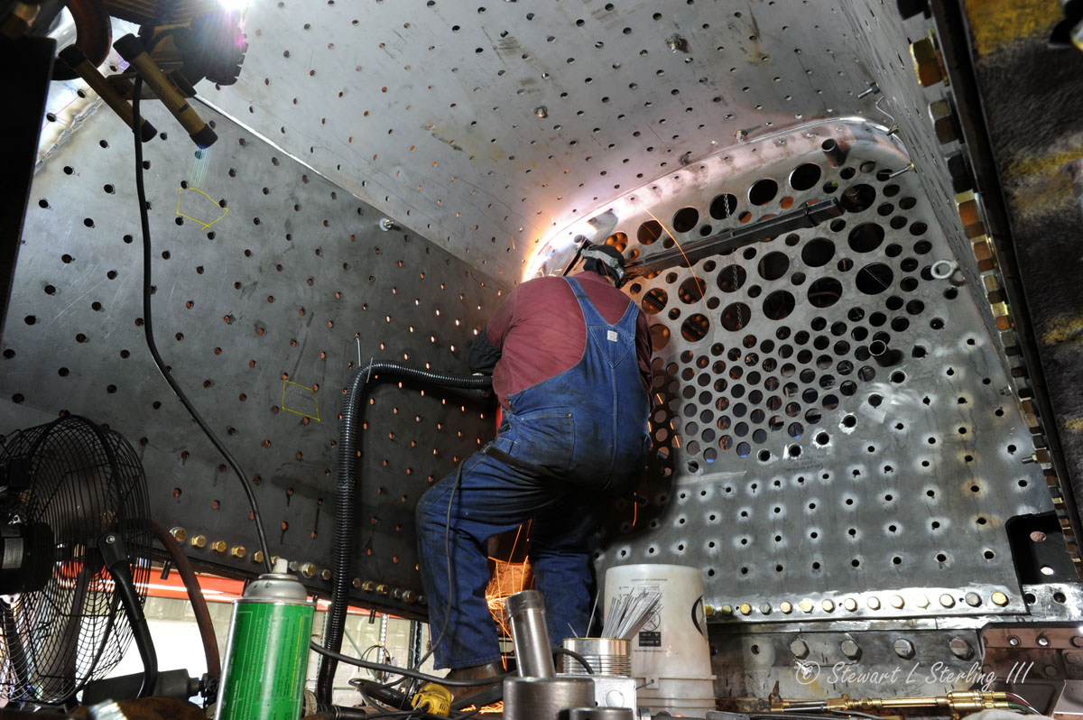

After an intense couple of weeks, the new fire box has been fitted, tacked together, and riveted to the mud ring. After putting in a 12-hour day on Saturday, a happy crew poses after another milestone is reached.

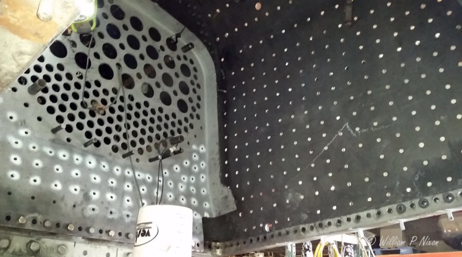

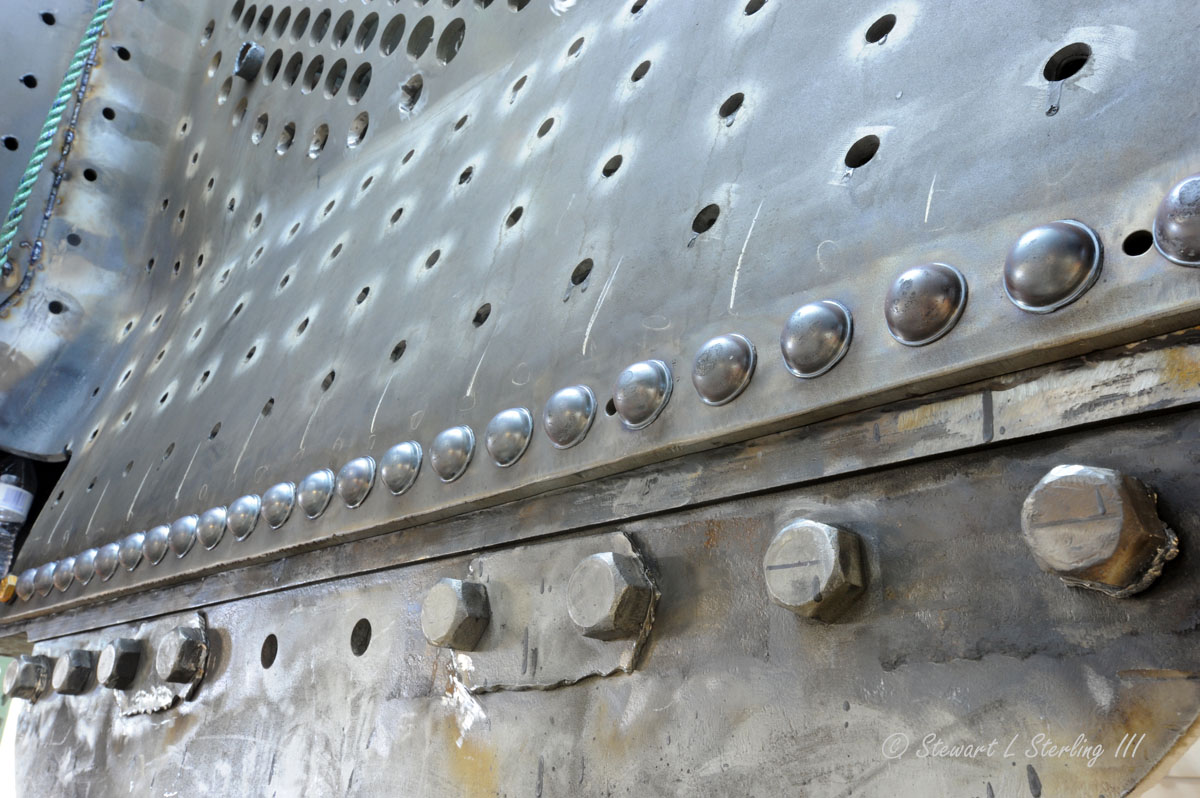

Here are more pics of the new firebox.
File comment: As close as I can get you to the crown for now.
File comment: This should be of some warmth! or soon to be anyway.
